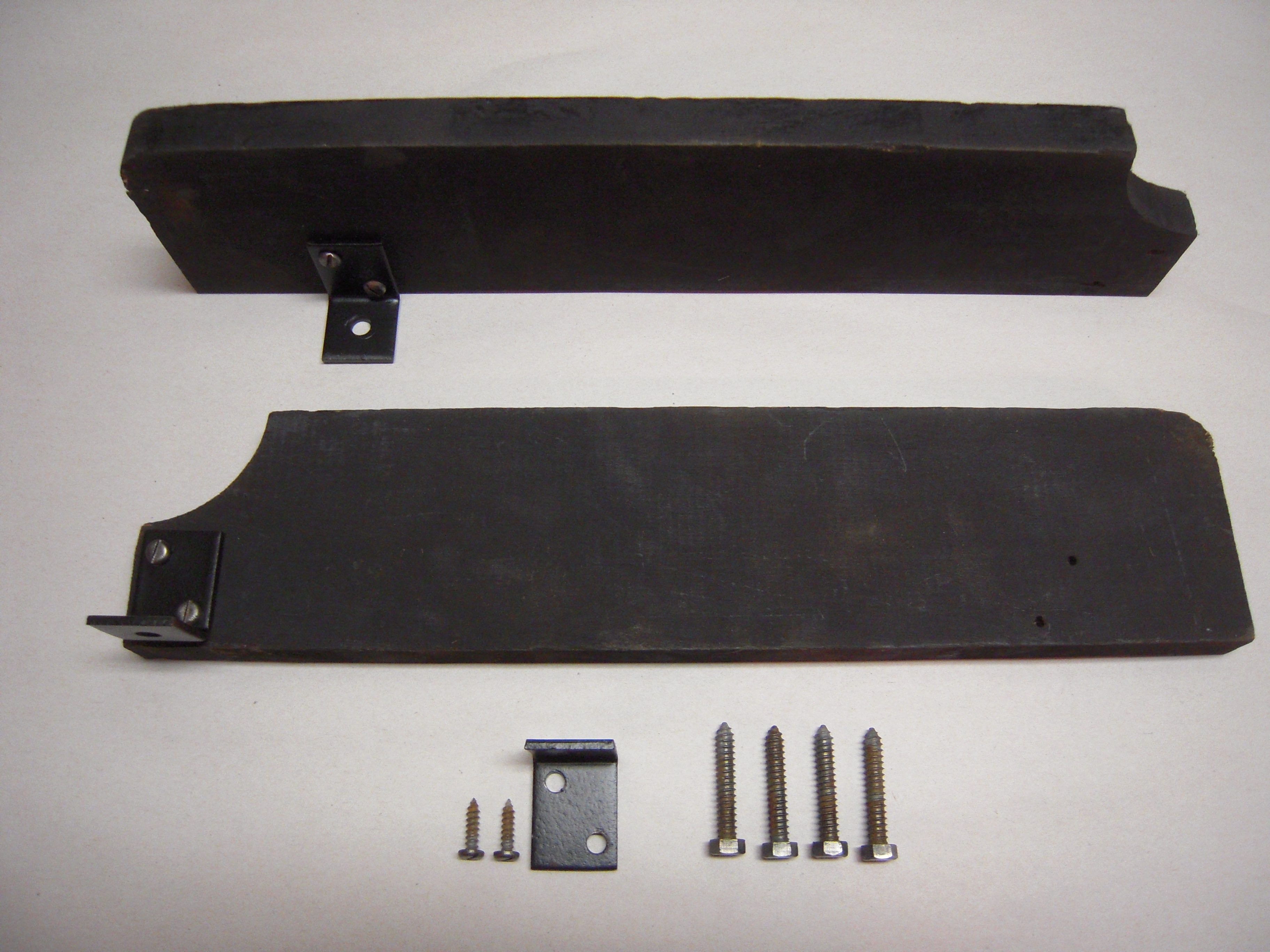

By the way, do you have the wooden divider boards beneath the seat?

I have taken both the front and rear seats out. Where are these divider boards located? Do you have a photo?
Thanks.

The boards are attached beneath the front seat - perhaps 6" or so from the rear edge. Here's a photo of a pair and the correct bolts.
What you can't see in the photo is the bracket on the opposite side of each board. That's why I've placed one (separate) in the photo.
All convertibles and business coupes had these beneath the front seat.
