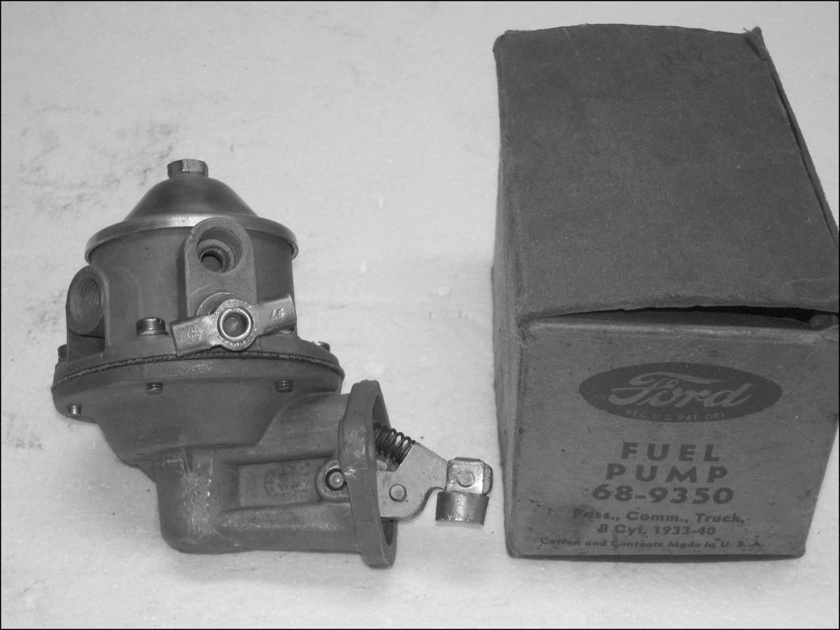

What is the correct fuel pump for a 1940 Ford 85 h.p.? Is it an AC pump and if so what is the AC number. For example: is it a AC 541 or AC 591? As always thank you for your help.

I have attached a photo of the pump you are seeking. Note the cover has NO tabs - it is smooth around its entire edge. Also note the inlet and outlet are offset by about 1/4".

kubes is that a bleeder on the side of the pump?????
12-11-2014 @ 7:01 AM
Posts: 3573
It is a bleeder of sorts, yes.

It is a drain petcock. It drains the sediment bowl.

If you look at later pumps, they do retain the boss for the petcock.
