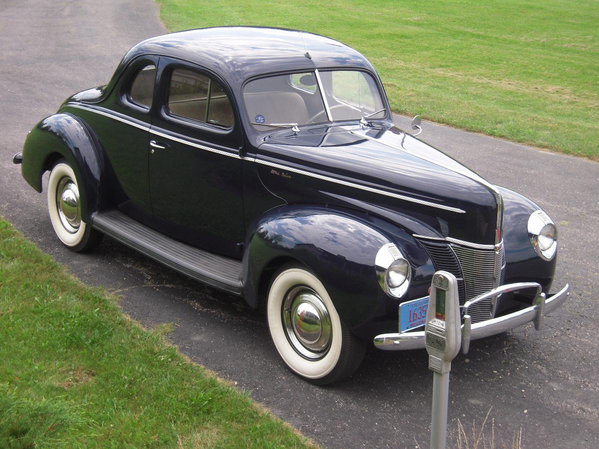

Mike, from the photos of the inside of your hood you sent me, it looks like your car is Lyon blue. Will you please post a few,photos of the car? Mine was originally that color but was reprinted with a poor color match. I'd like to see what it would look like in the correct color.

It is Lyon Blue. I don't think pictures are a good place to look for color though. They (pictures) do not always depict shade very well due to exposure, etc. I can send you more photos to your email address if needed.

Wrong picture... sorry. Maybe this time I'll get it correct!

Wow! The car is beautiful and I love the color! I'd love to have more photos, if you don't mind; it will give me gobs of inspiration. Here's my email address: billgmitch*ll@gmail.com.
