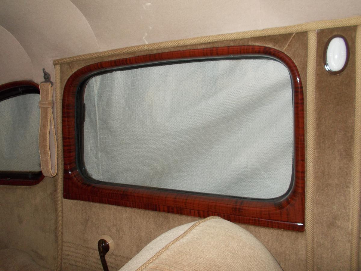

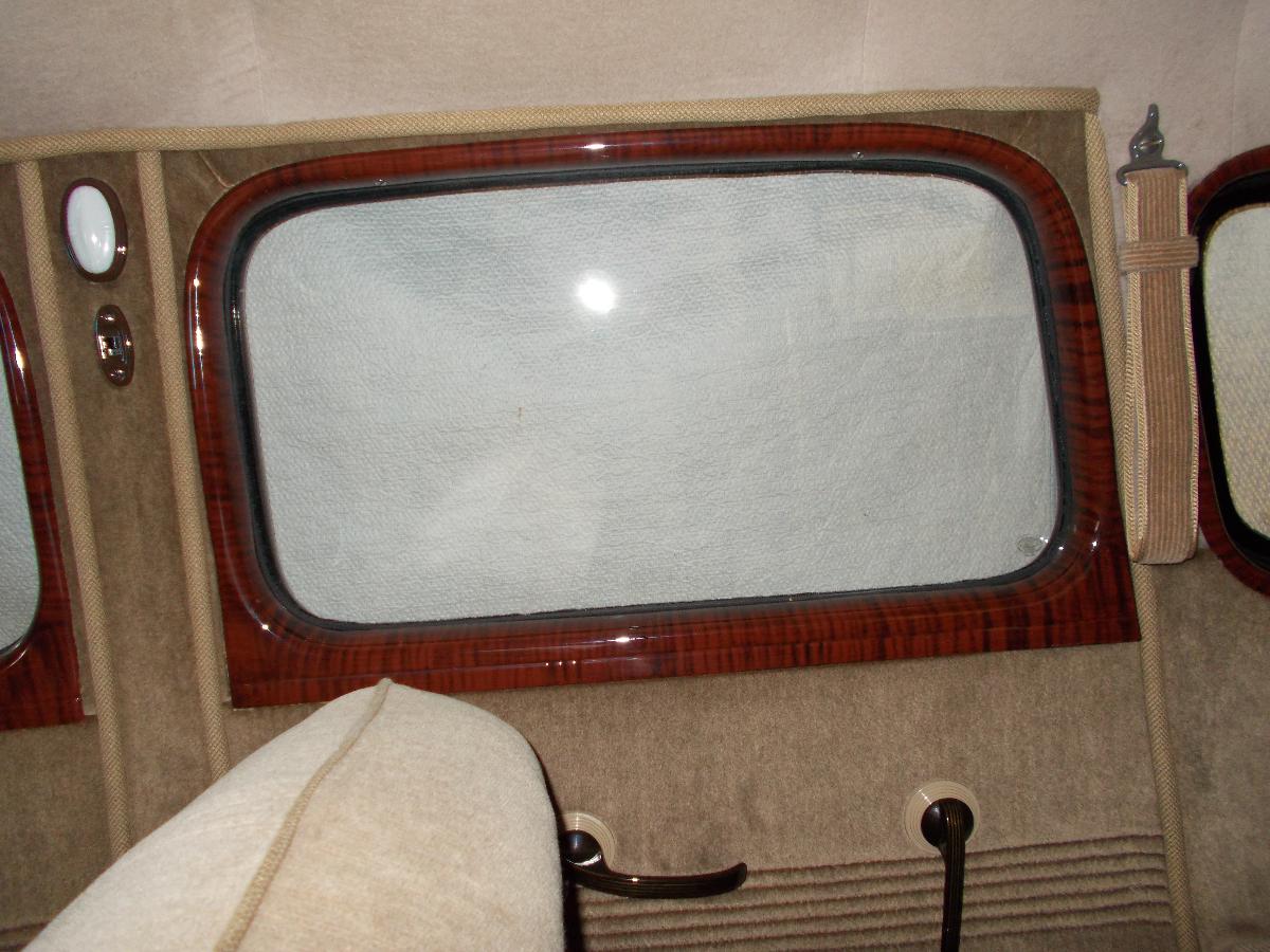

Check page 2-29 of "It's Ford For '40". Mike gives you a good description of your requested info on the Assist Strap, including hardware. If you don't have a copy of it yet, go to the blue section of your screen, click on "Online Store", then click on the link for "Ford Books". The book is a must-have for '40 owners.
Just for fun, enclosed are photos of the Assist Strap location and installation on my FORDOR Sedan. The setup for your Tudor should be similar to what is shown.
Good luck with the Tudor.

Hi Tom
Thanks for the info. Could you take a picture of the page and post it.
The picture you sent are like the ones I have, but don't have the bolt.
