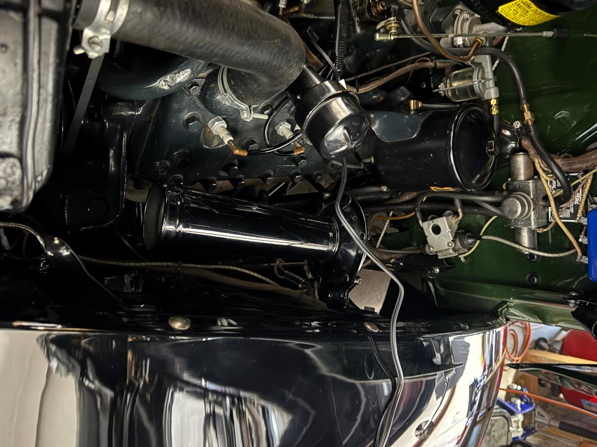

I've attached a photo. The Columbia two speed is engaged by pressing down a toggle on the dash after depressing the clutch once the truck is at an appropriate speed. The gear engagement is obvious and a drop in speed on the speedometer is noted as well as a drop in rpm. There is definitely an electrical wire entering the control module on the firewall. My thought is to insert a voltage reducer into the wire as it enters the control module.

You must have one of the later Columbia systems used on 1941 and later vehicles. These do have an electrical connection to actuate the solenoid. If this system works like the solenoid on a Borg-Warner overdrive system, you cannot use a voltage reducer on the solenoid because there are two different coils inside the solenoid housing. One set is the heavy pull-in coils which engage the overdrive. The second smaller set is called the holding coils. They hold the overdrive engaged while it is in use. Each set of coils require different amounts of current to work properly. The smaller holding coils will be destroyed first from excessive voltage. These are the most expensive to repair if you can find the parts.

I contacted John Connelly, the Columbia guru, and he advised that a voltage reducer from the battery to the controller should work when switching from 6 to 12 volts. . He advised that there is not a 12 volt solenoid or motor currently available to replace the 6 volt motor or solenoid. I'll let the forum know how it goes. Thanks for the help.
