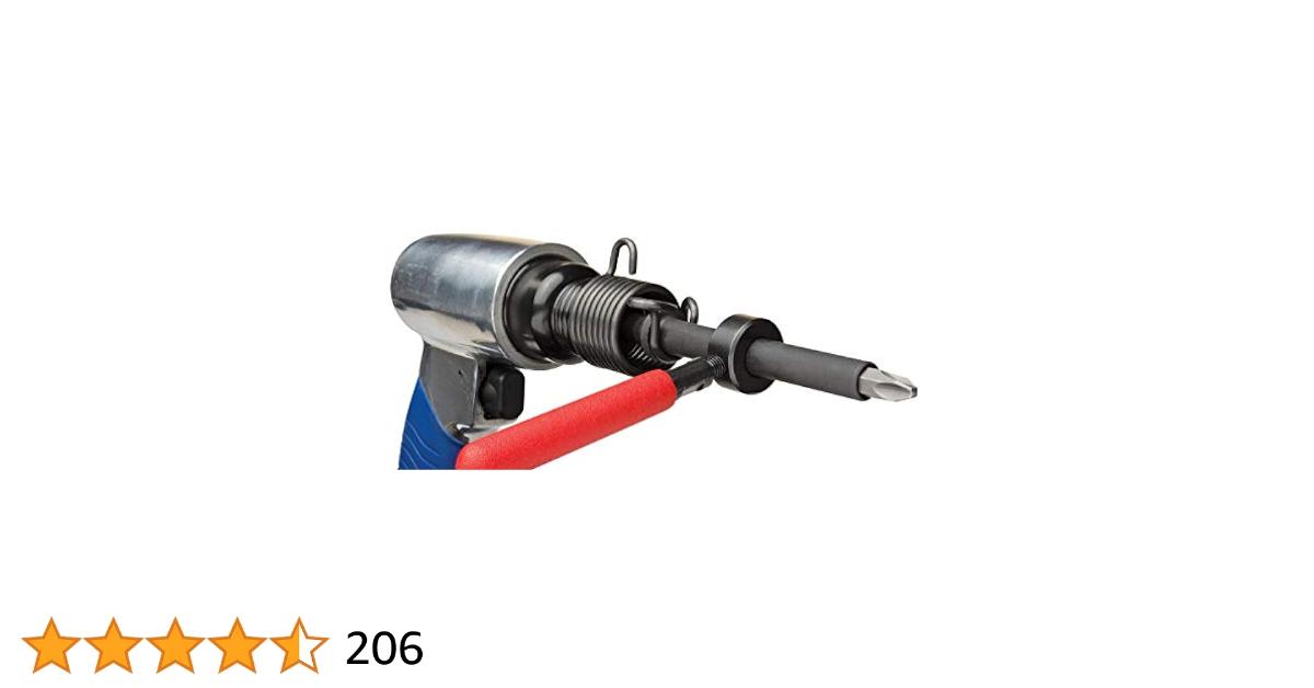

This: https://www.eastwood.com/eastwood-screw-buster.html?Wickedsource=Microsoft&Wickedid=79439924039190|default|e&msclkid=026e0652964f1fe39f9f61ef79b3dbf3&utm_source=bing&utm_medium=cpc&utm_campaign=BPA%20-%20Eastwood%20Category%20SE%20PT%20HT%20BU%20Test&utm_term=2331239529389428&utm_content=GSN%20Products
