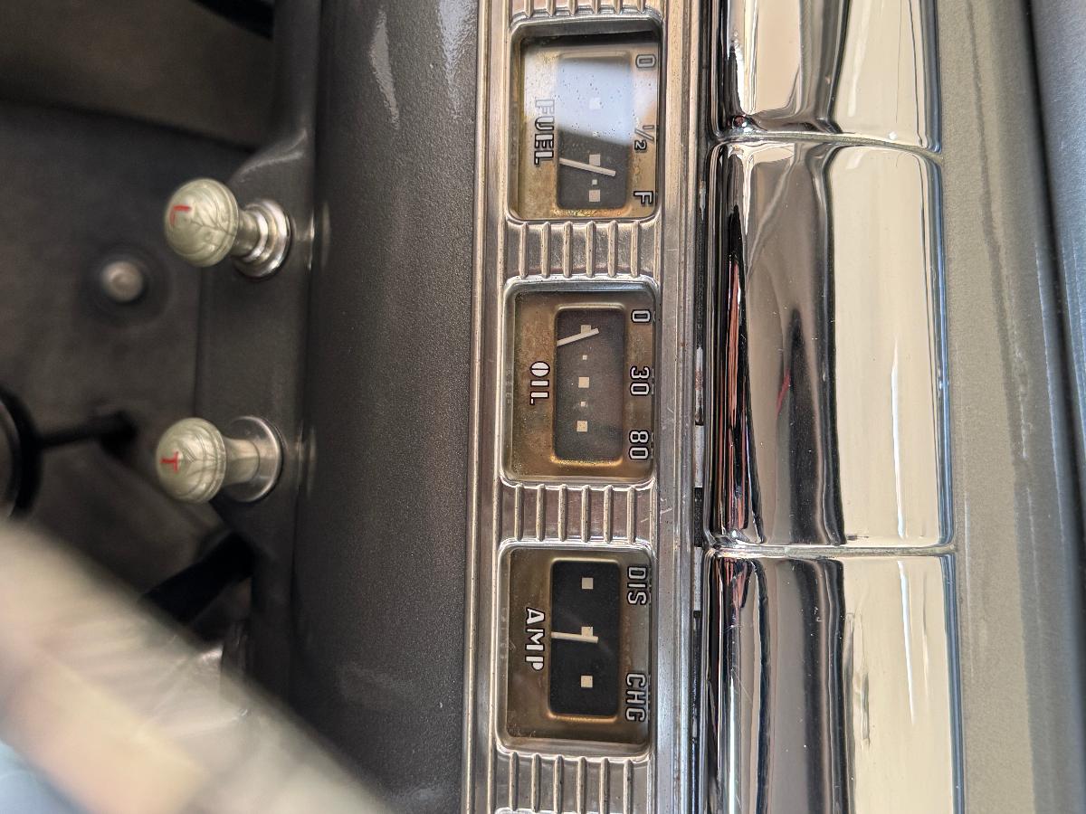

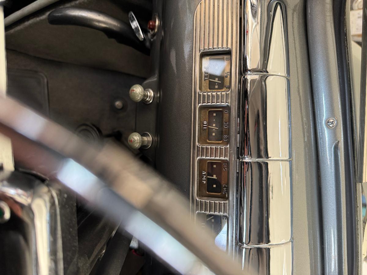

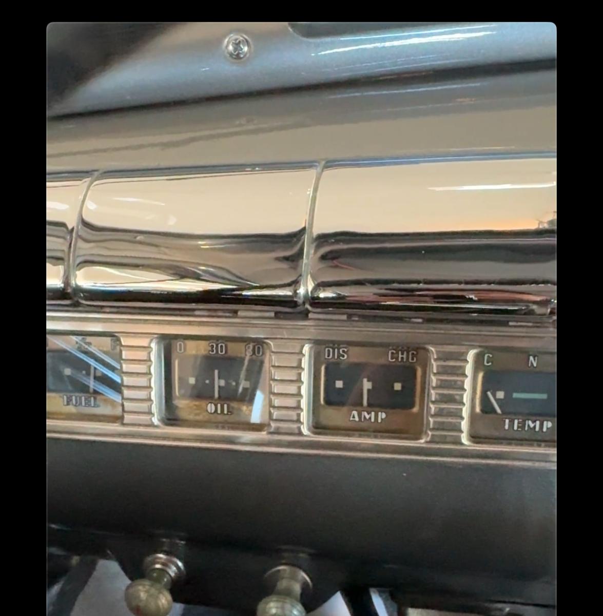

So I get great pressure warming up but at temp and driving it’s somewhat flat but does move with acceleration (2nd gear low RPM). Last photo is at startup and cold Middle photo is once it’s warm and left photo is very low acceleration. I have read numerous places this seems to be very normal. On a 80lb guage and only expecting 5lbs idle, this seems maybe in that neighboorhood but when driving I would think I would get the needle to move. I feel like a mechanical guage is in order to see if I get a different reading. Thoughts? Car sounds amazing and no knocking at all or leaks! I really feel like im stressing over nothing.

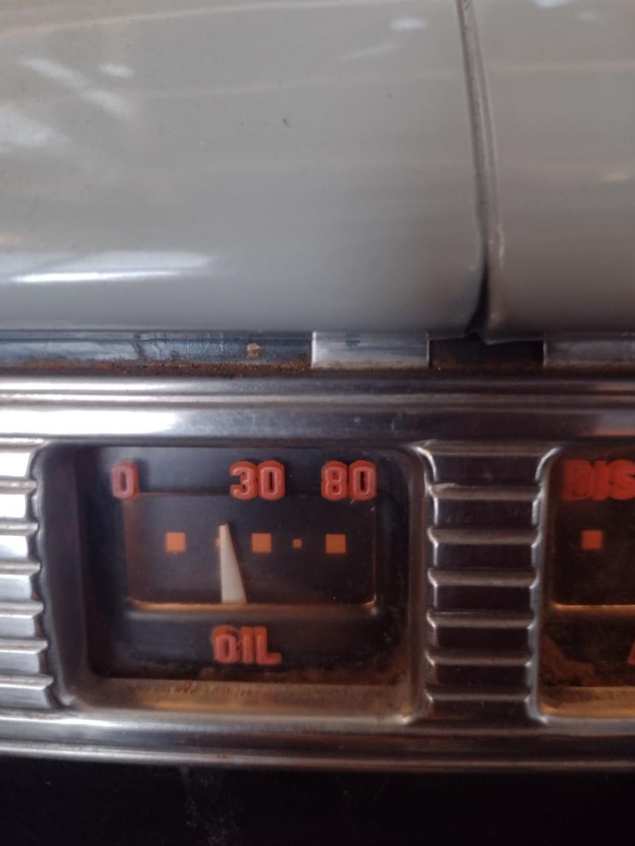

Here is my gauge after starting cold before the oil change: I’ve yet to start it after changing oil. Been a couple rainy days in so cal and my 46 doesn’t go out to play with its wet. I’ll post an update this week after driving with the new oil. Can confirm my gauge is 80lb.

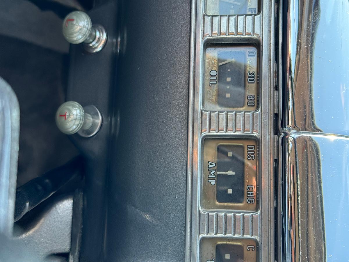

Jay, I reread his post and understand now. Attached is a picture of my 46 Ford Super Deluxe oil pressure gauge.
