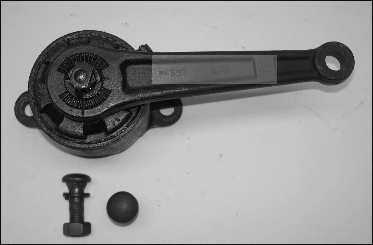

Front Shock Absorbers
Mounted to the outside of the frame were “lever action” type shock absorbers. Their part numbers were 01A 18045 A (right side) and 01A 18046 A (left side).
Special 350666 S2 carriage bolts were installed through the inside of the frame. On the other side 34808 S2 lock washers and 33802 S2 nuts were placed against the shock absorber body.
The arms had cast on them “F 837”, Ford script, and, on a boss near the end, the number 10.
The bodies were approximately 2 7/8" in diameter.

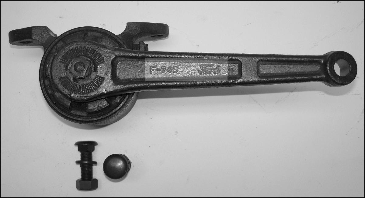

Rear Shock Absorbers
Mounted to the bottom of the frame were “lever action” type shock absorbers. Their part numbers were 01A 18080 A (right side) and 01A 18081 A (left side).
Special 350667 -S2 carriage bolts were installed through the inside of the frame. On the other side 34808- S2 lock washers and 33802 -S2 nuts were placed against the shock absorber body.
The arms had cast on them “F 745” and the Ford script.

Thanks much. My current set up looks just like the pics
