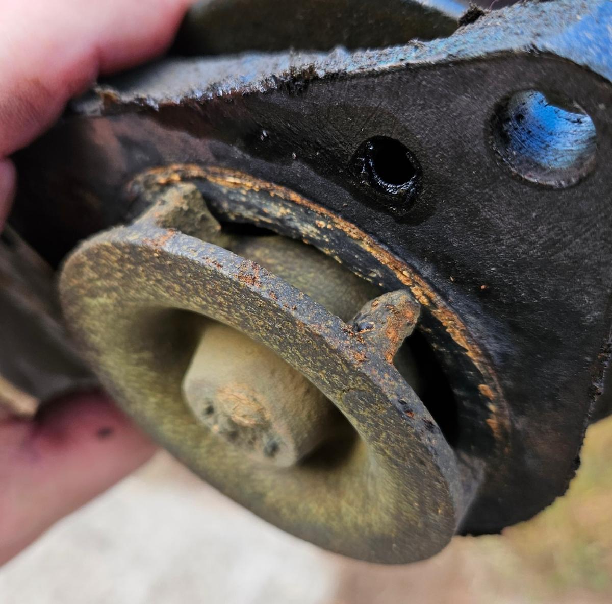

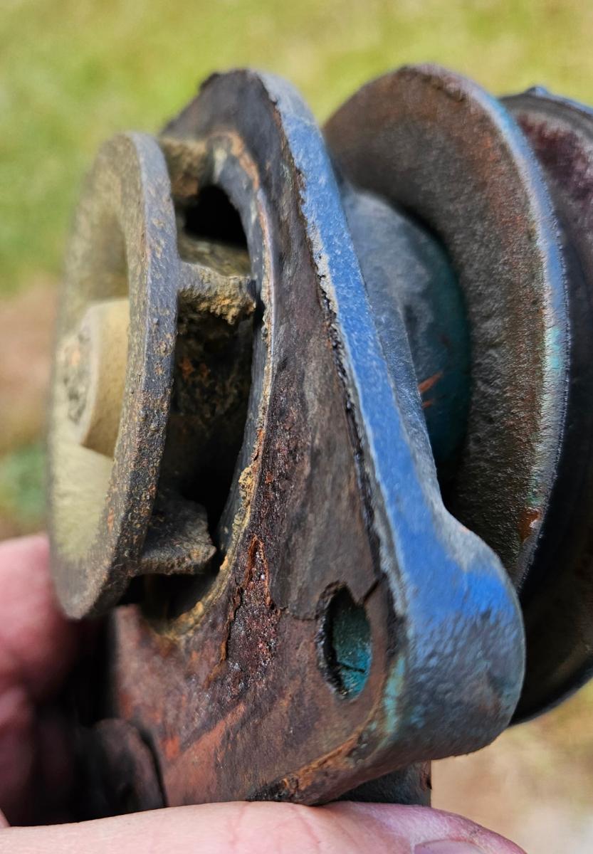

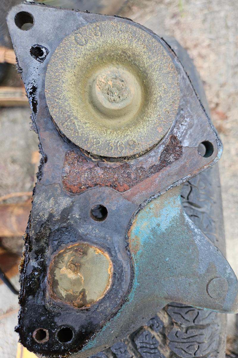

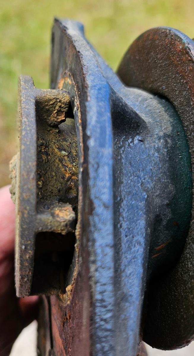

I removed one of the old water pumps this afternoon. From what little I can see inside the engine block, it doesn't look bad. No scale rust is visible, and no noticeable sediment.
The pump doesn't look as bad as I was expecting... or maybe I don't know what I'm looking at. Opinions are welcome...
Before I disconnected the homemade flush tanks, I started the engine and used my timing light to determine the idle RPM... it is idling at about 590 RPM. I think the pumps should move more coolant than they do turning that fast...

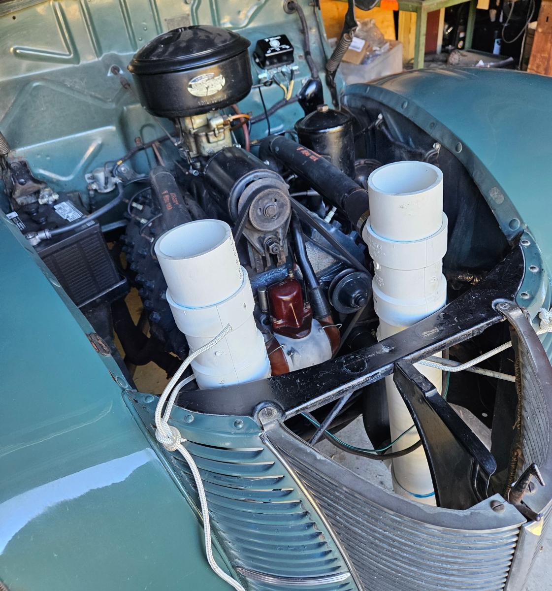

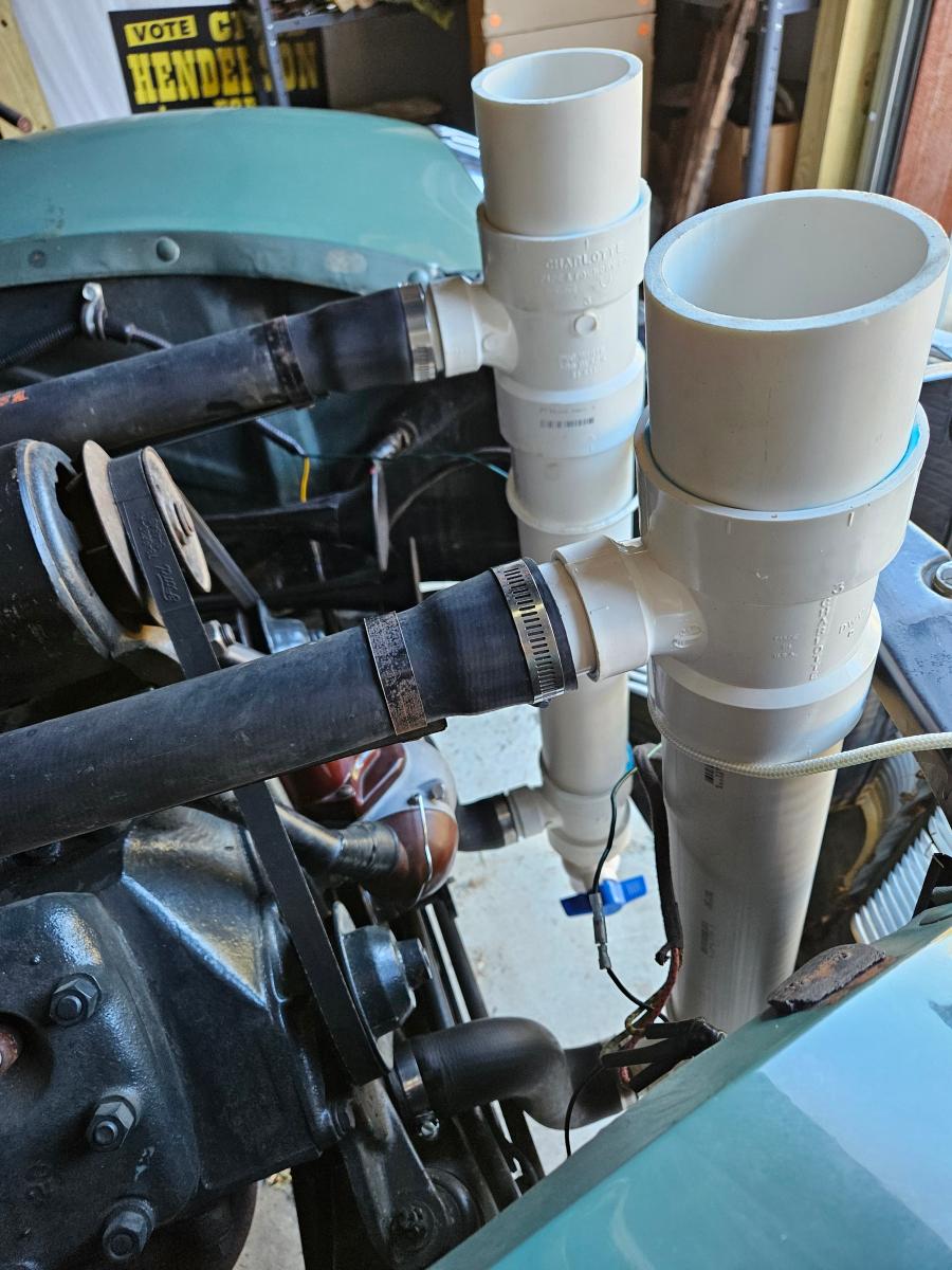

I have the radiator out of the '40... and I did remove the hidden bolts from both water pumps, just to be sure they would come out. They came out very easily, so I reinstalled them... I'm not quite ready to remove the pumps yet.

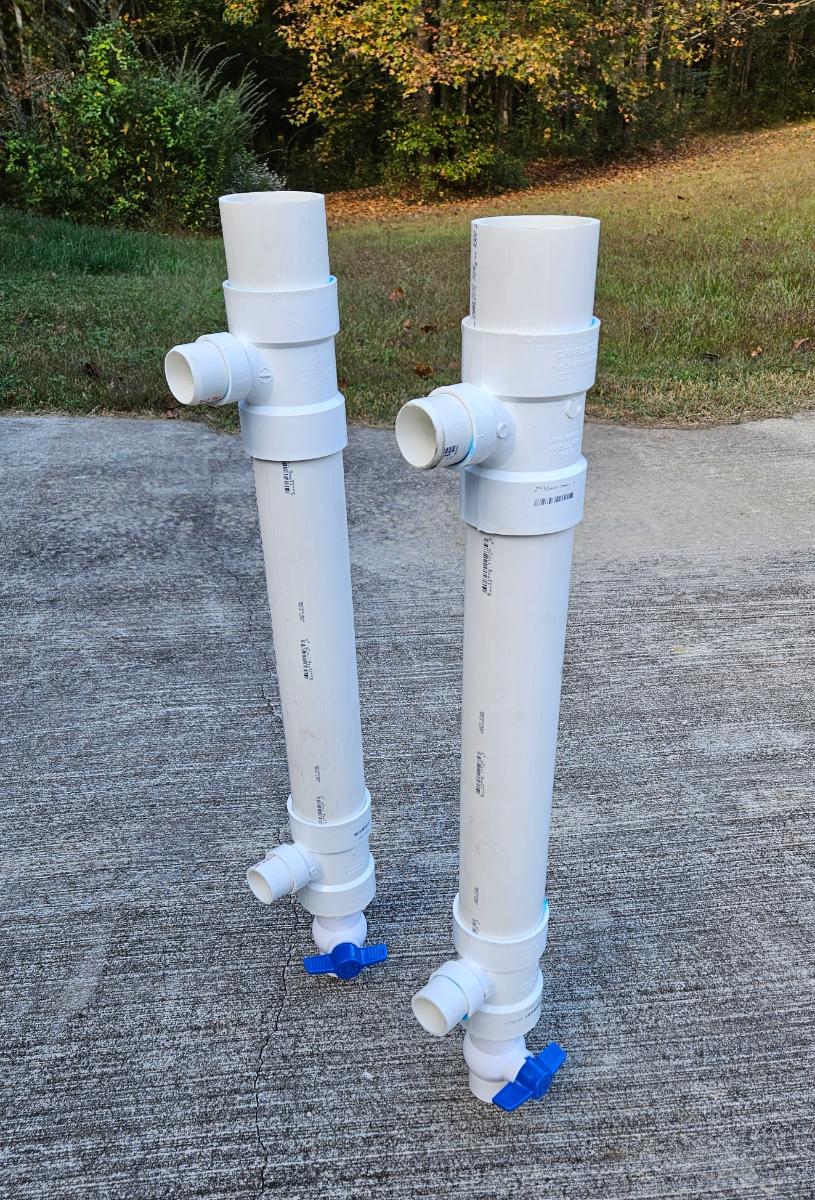

I constructed a couple of contraptions out of pvc to replace the radiator... just for the purpose of being able to pump water... and Evaporust... through the system without having the radiator in.
I filled the system with water and a mild detergent and ran the engine just until the temperature gauge rose a little. I left the thermostats out while I'm tinkering with it.
At idle, there is almost no coolant flow on either side... I would say that the volume is maybe half what a drinking straw would flow. Throttle it up some and it quickly starts flowing well. I think this may be why it wants to heat up at idle.
I'll get the pumps off later this week, hopefully, and see what they look like.
