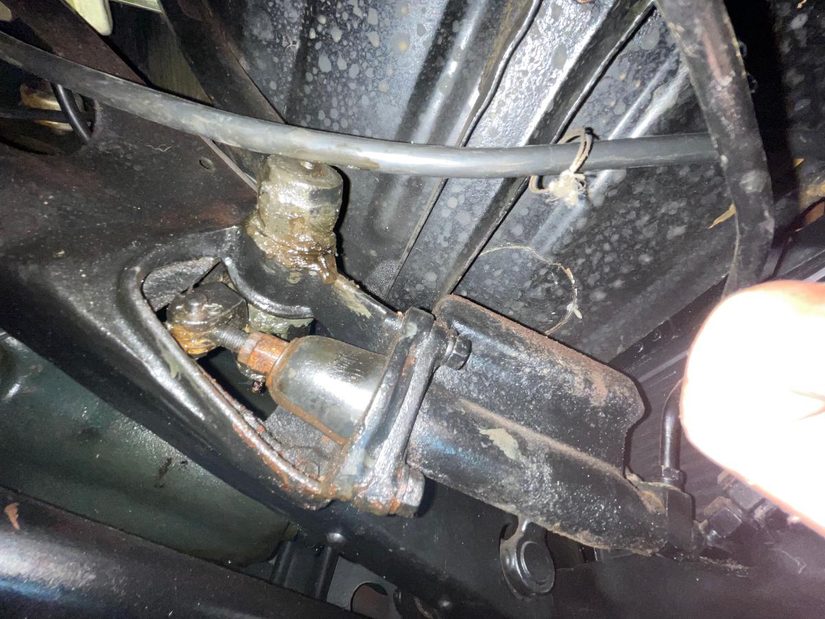

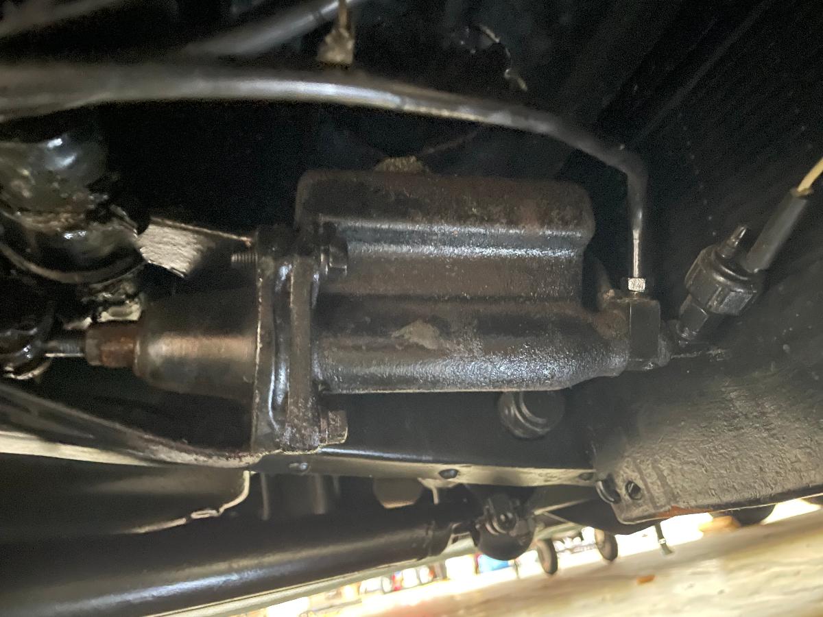

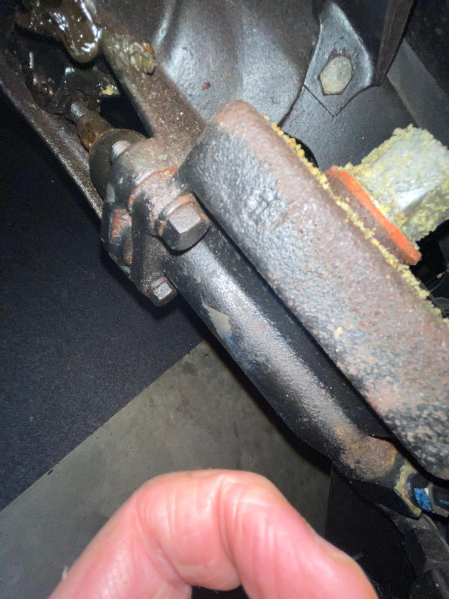

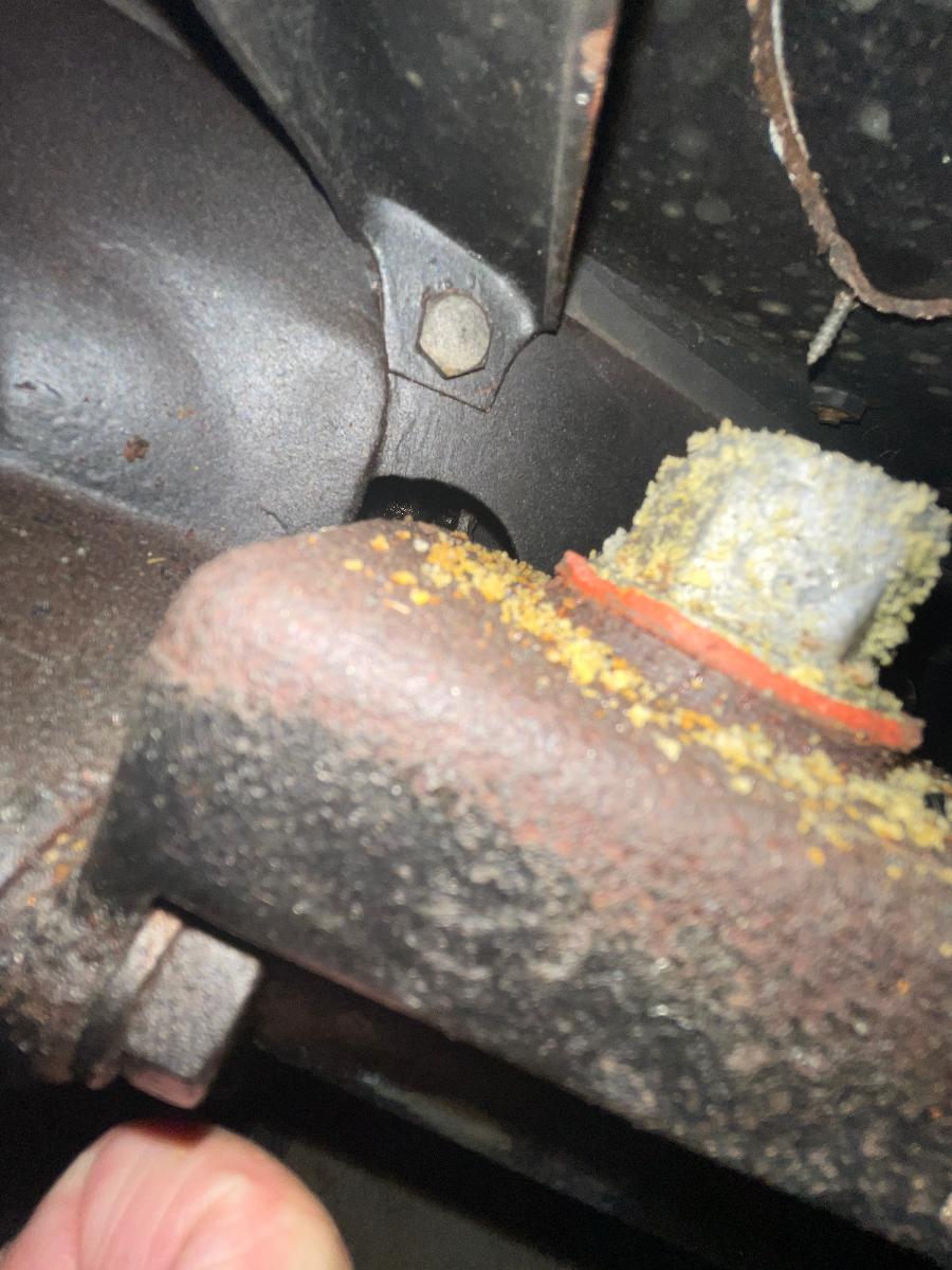

I posted on here awhile back about my brakes. Out of nowhere I started having NO breaks. My pedal just goes all the way to the floor. It’s my understanding that this car didn’t come with a master cylinder. I did find what appears to be on under the drivers side near the battery box. Can anyone help me determine what model master cylinder this could be?

It is very common to find a hydraulic brake conversion on models prior to 1939.
The master cylinder in your vehicle is '39 - '48 Ford passenger car. Napa sells a good quality NEW assembly for about $60. When searching at NAPA, look up 1948 Ford Deluxe for the listing.
Napa's part number: NMC M1050

Thank you so much for getting back to me. I will order one tomorrow!!
