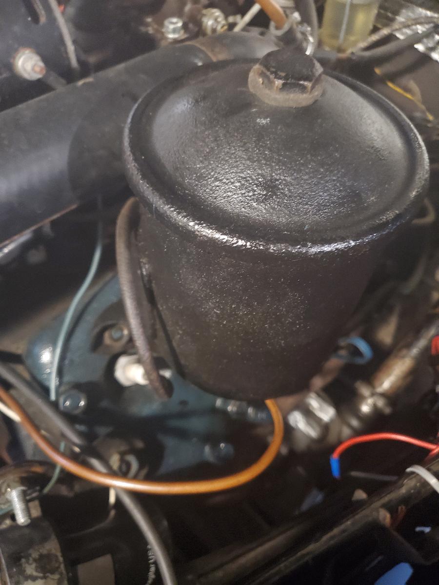

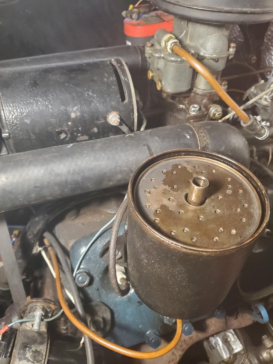

I recently acquired a 1941 Ford Super Deluxe and have never seen an oil filter element like this. The side of the element has no holes and are instead located at the top and the bottom. All of the other elements I've been able to find for this era of Ford have them on the sides. Has anyone seen one like this and any advice of how to freshen the filter for the car? I imagine this is reusable...wondering if cleaning in gasoline would work.

Yes, I have seen that style. No, you should NOT clean the filter and use it again.

I can't find any of that style (probably aren't made like that anymore) but I'm thinking one with holes on the outer side of the element cylinder should work with the cannister. Do you agree?
04-30-2023 @ 4:51 PM
Posts: 3575
Yes, the filters with the holes on the outer sh*ll work just fine.

I think the Wix # is 51006 . I gave my local auto parts store the OEM # which is 7HA 6731 and they were able to corelate it to the Wix number. There was an earlier Ford # that had a 01A prefix and a different base number that was superseded. I have one of those but it would only be for display at this point.

Thanks! I got that same part and installed it. Now I just need to figure out where and why the canister is leaking (it was before the filter change).
