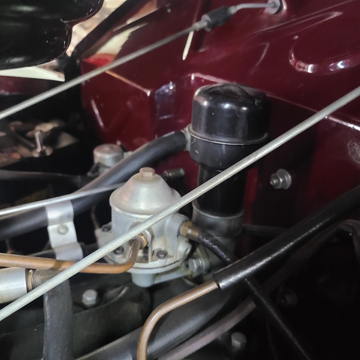

Car runs great after it starts, so don't think it is that. Here is a pic for the fuel pump. Thanks

Also, does the fuel pump look correct? Thanks, Kube

Fuel pump does not appear to be correct. I don't believe the fuel pump is part of the issue you are experiencing.

Many of the features of your fuel pump appear correct but it lacks the special drain plug. I too believe Charlie is the best to rebuild your correct 91-99 model Carb if necessary but if runs and idles fine why rebuild. The flex line from the firewall to the fuel pump appears to be very old and can add to problems plus there is a cork gasket under the top of the fuel pump that can dry and leak air into the fuel pump causing additional delays in repriming the Carb and starting.
