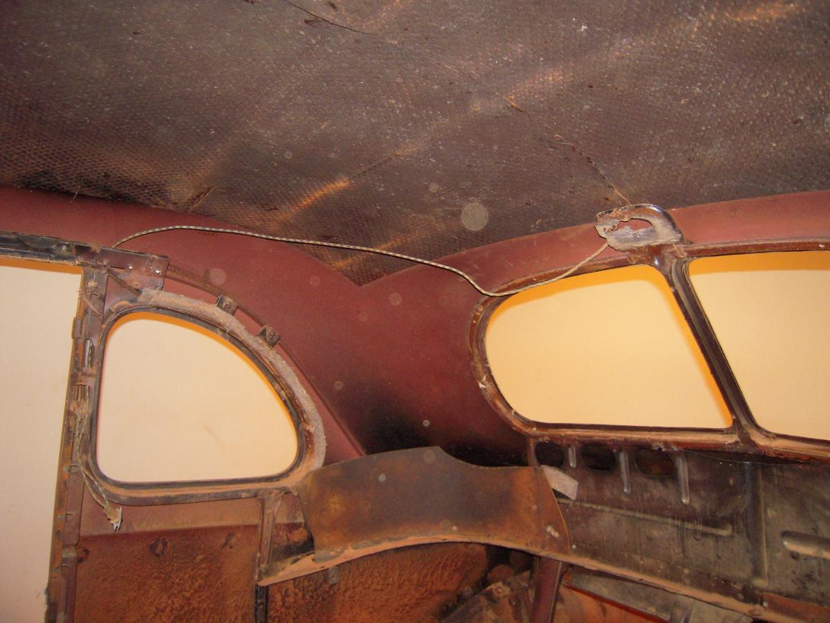

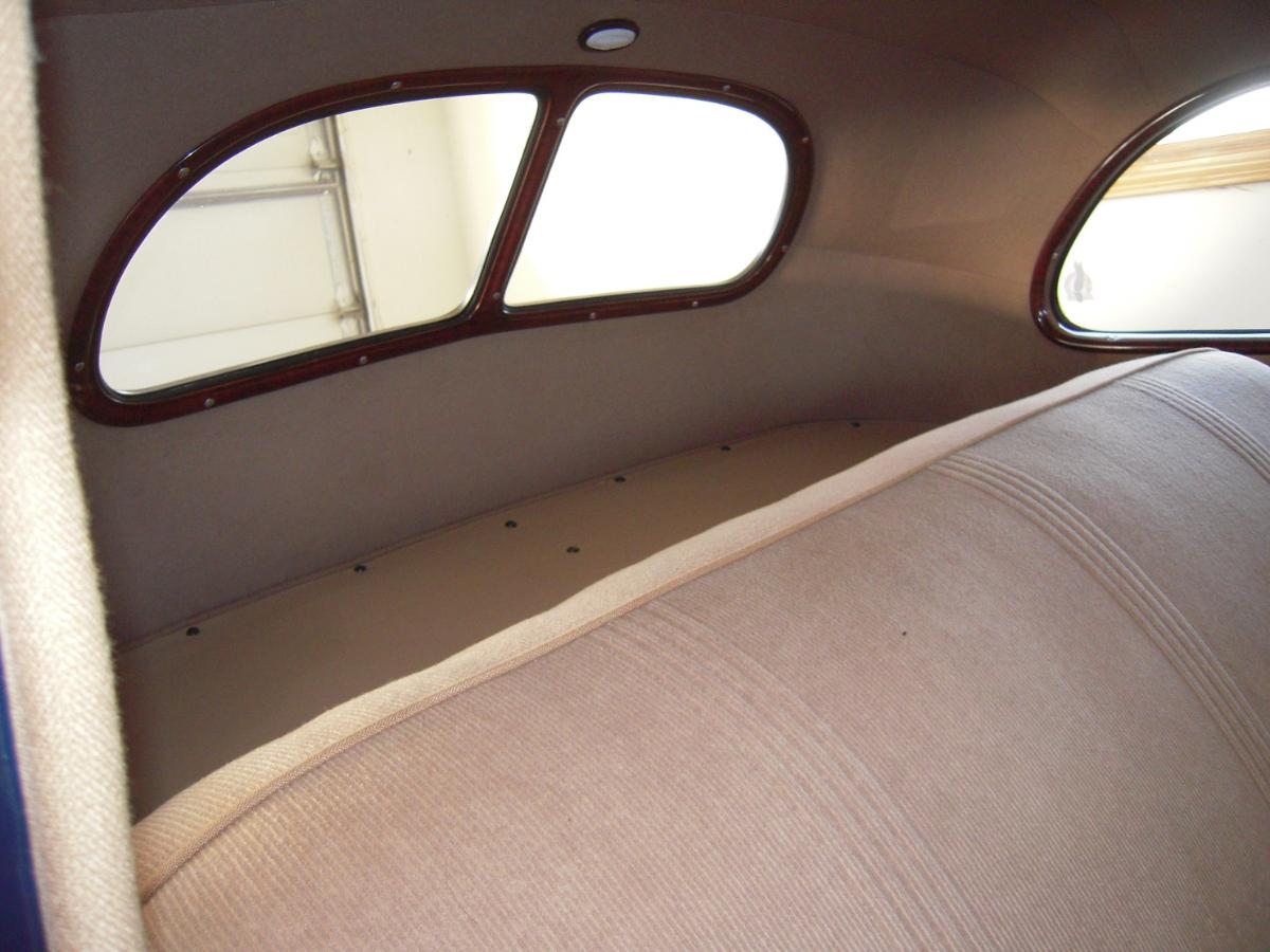

06-27-2022 @ 5:28 AM
Posts: 3573
Here are two photos, both coupes, albeit two different coupes. This should give you a great "look" of how the lamp was wired and ultimately installed.
