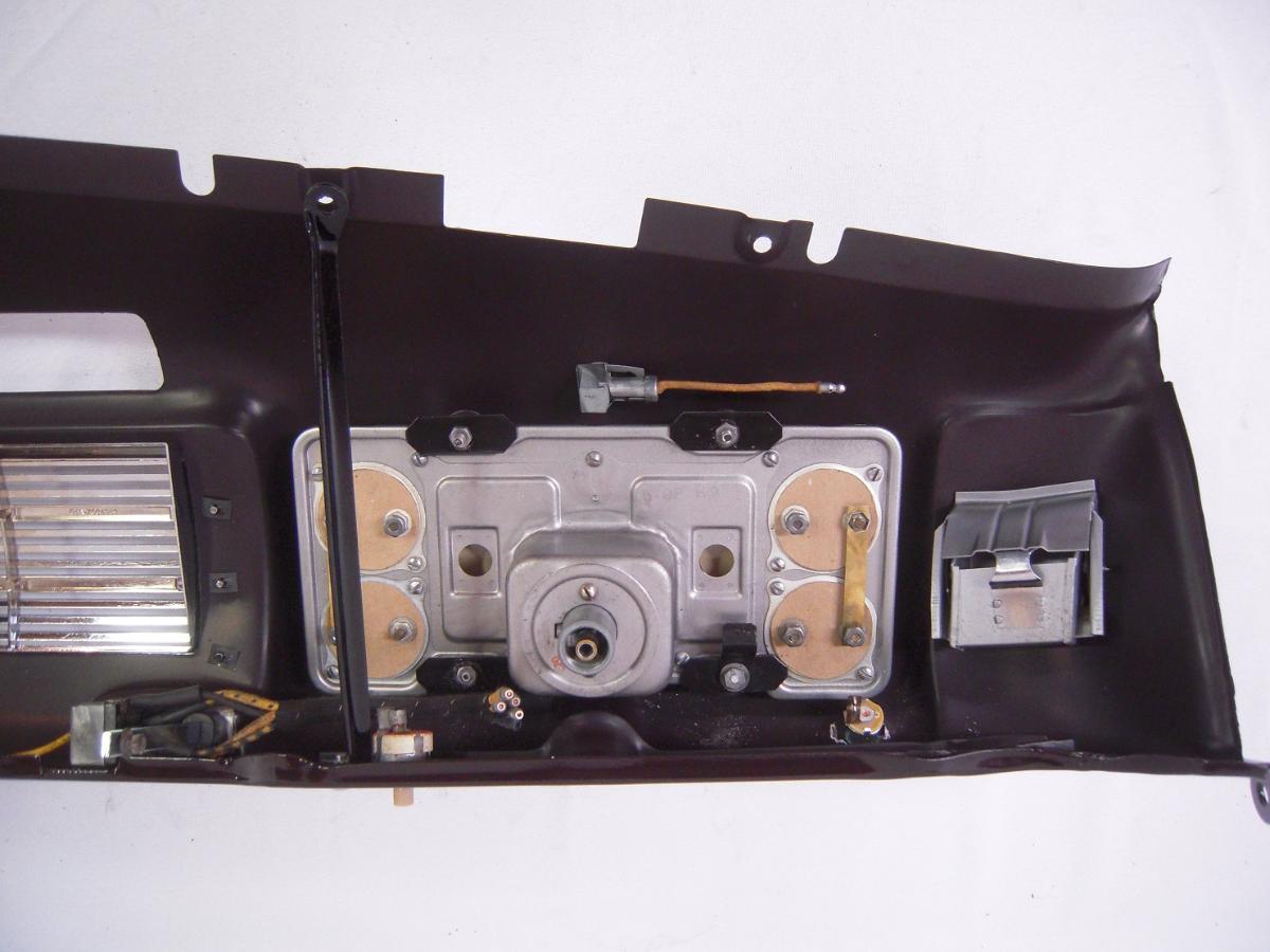

I want to set up and test a '40 temp gauge and temp sender on my workbench but need some help - which terminal on the gauge receives power and which one is ground? Photos from the back side of the gauge are welcome and appreciated!!

Does this help?

Kube to the rescue!
From the back, the temp gauge is on the bottom right side? The copper strip is ground making the other terminal power, correct?

The copper strip is a connection for the power or neg battery connection. One wire powers 2 gauges.
The outside of the sending unit is grounded or battery + connection. The wire to the sending unit is connected to the gauge terminal without any other connection. The sending unit will pulse at a rate that indicates the temperature of the coolant.
