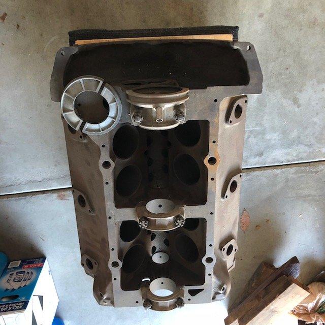

The one piece of the two inserts does not appear correct. The bottom one in your photo looks correct the top one appears to be earlier. See photo below

The part number seems to be correct for my engine. The attached photos show that 2 "horseshoes" are different. The wider one has one side plain with no gussets. While the other has gussets on both sides. I included a photo of the oil pump. It reaches to the bottom of the pan with its attached pickup screen. I assume that it is a 50# pump?

The "horseshoe" should have a sharp V shape groove. I don't have one available to measure the width.
Did you look for a P/N on the part? Most of the slinger type had the P/N 78-6335 cast into the part. The rope types had the P/N 91A-6335 cast into them also, but there were some aftermarket ones made that did not have the P/N cast into them.

I have removed the pot metal "horseshoe?" from the block. It appears to be wider than standard. It measures .318 in at the widest part. Another on my parts shelf measures .268 in. Is that enough difference to allow oil clinging to the slinger to let oil get past the block and into the oil pan that houses the flywheel and clutch?
