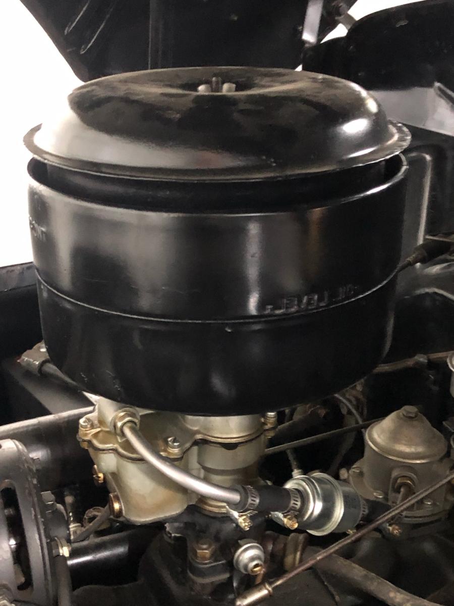

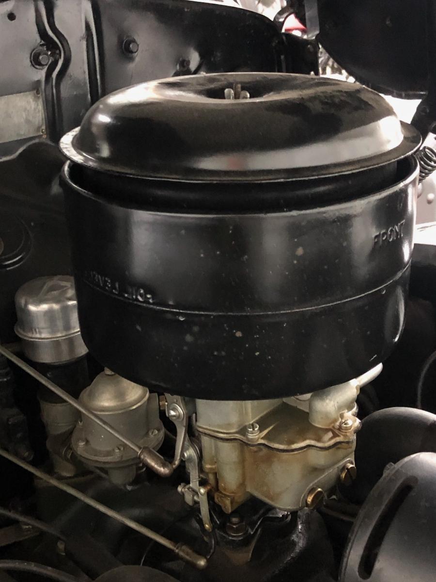

My air cleaner housing has some small pin holes. Has anyone used a conventional paper air cleaner in one of these? If so, do you have any info on it?

Thanks for your reply. Filter or housing? I have the filter that goes with that housing. The oil leaks from the pin holes. I don't know for sure thats the right housing either. New territory!

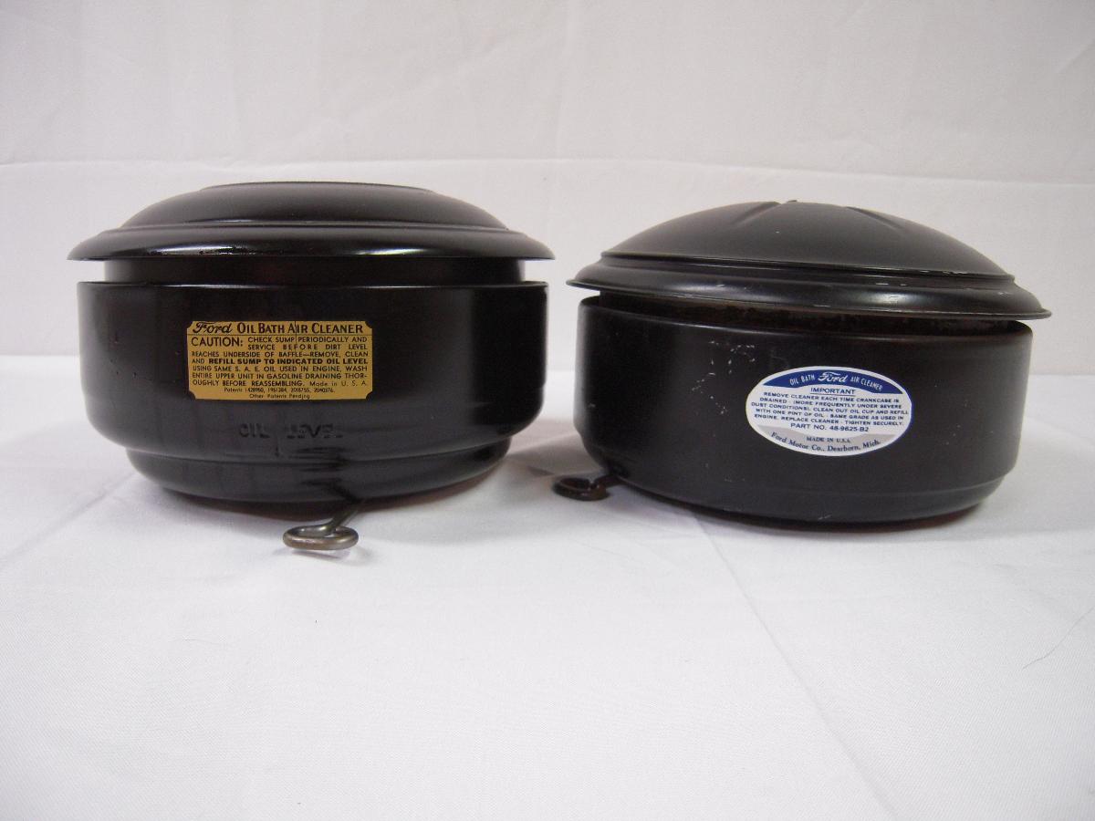

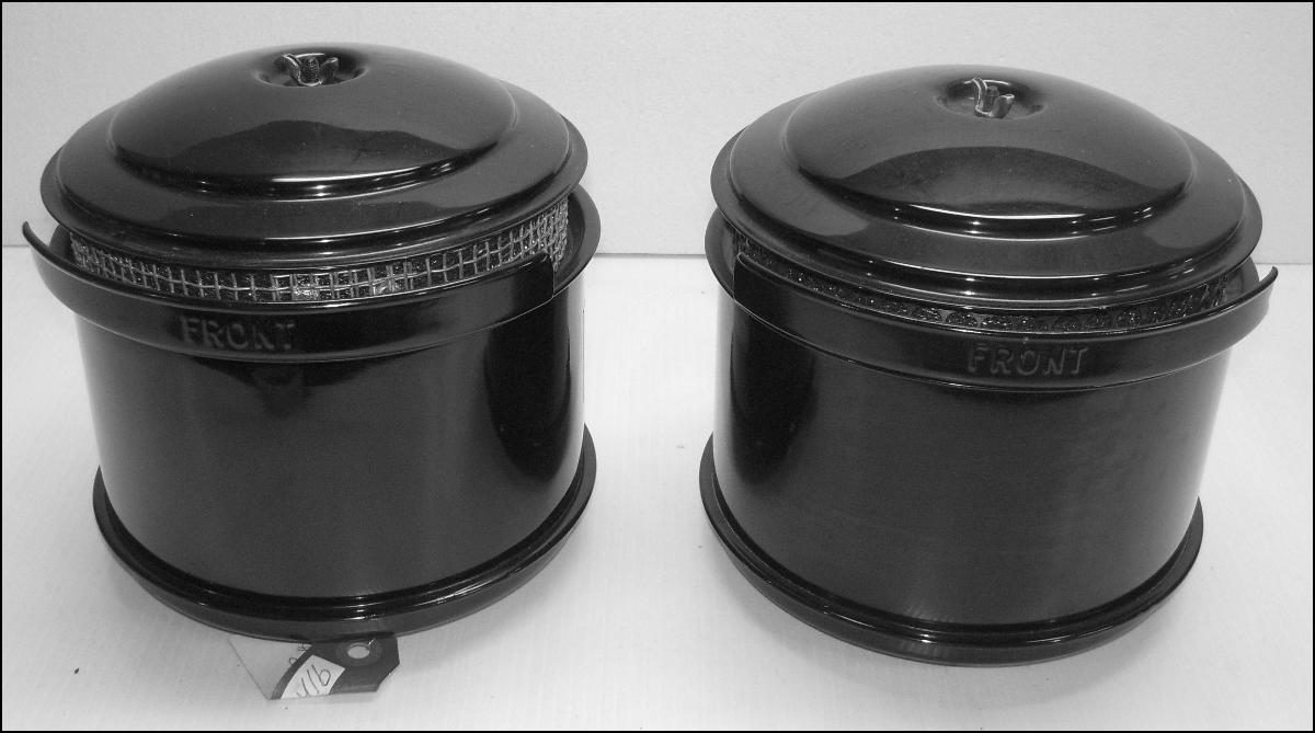

Your's is not the correct housing.
I've attached photos of both the dry type filters (standard issue) and the regular duty oil bath filters correct for 1940.

Thank you for the clarification and the pics. Now I know what to look for.
