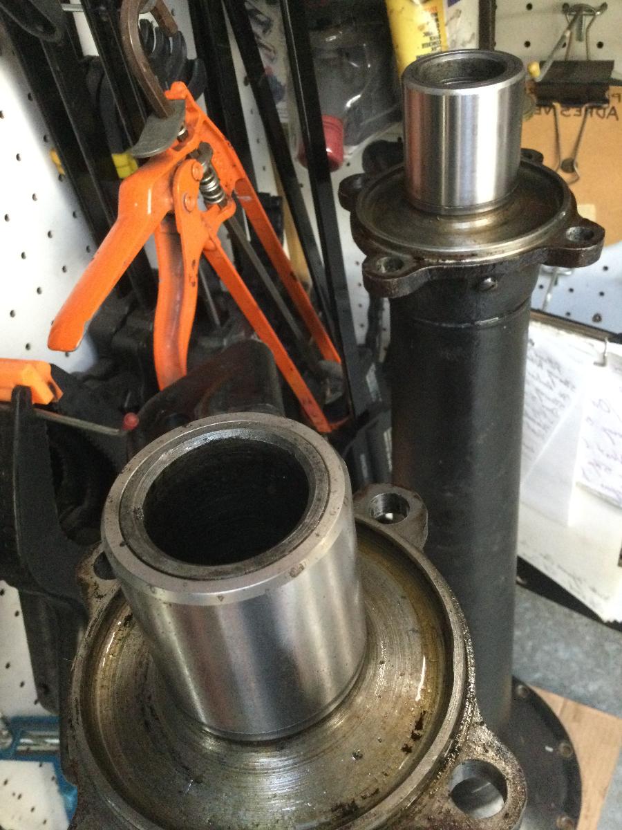

Check…Rear axle sleeves installed. New bearings purchased. This ‘40 rear end has never before been apart.
Post high pressure steam cleaning has disintegrated the inner rubber seal of the Rear Axle Inner Grease Retainers. For cross reference purpose, Can someone please post the part number of a reputable replacement?
Also, what is the inner diameter of the seal?
Regards. Rick

I don’t know why the photos are inverted? Removed Rear Axle Inner Grease Retainers are stamped GK Ford.
