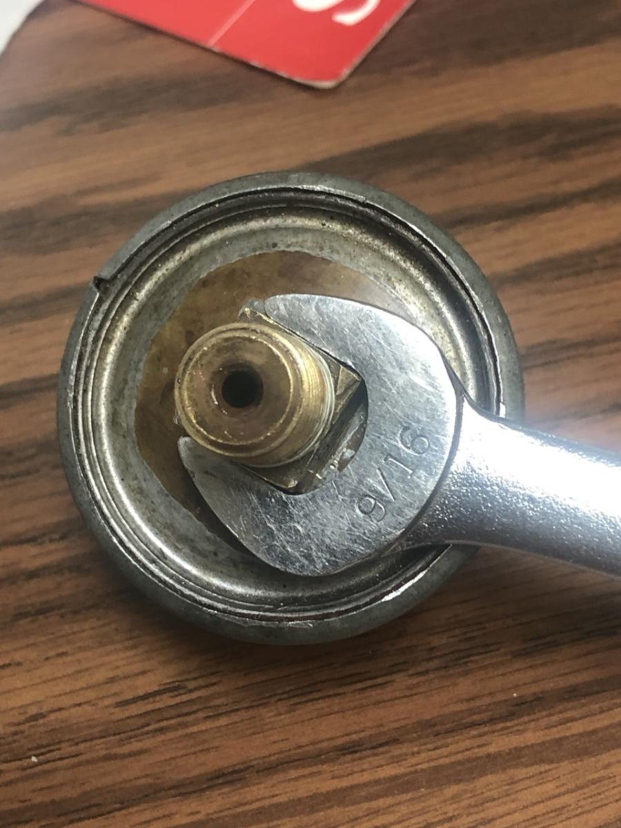

I had my floormats out of my convertible, so I removed the transmission cover and the wood floorboard. You lay down on your stomach and you can get a wrench on it. While I was under the car the other day, I was looking at the sending unit from below and thought that I might get to it from under the car. It really needs a "distributor wrench"(the wrench you use to adjust the timing on a Chevrolet V8) the correct size that you can slip over from above, by the firewall.

You can use a crows foot wrench to remove the sender unit. I am not sure of the size, you will have to measure the distance between the opposing flats on the unit's base.

As carcrazy said, a crow's foot wrench, or bend an open end wrench around into a U shape.

It's a 9/16 square fitting.
