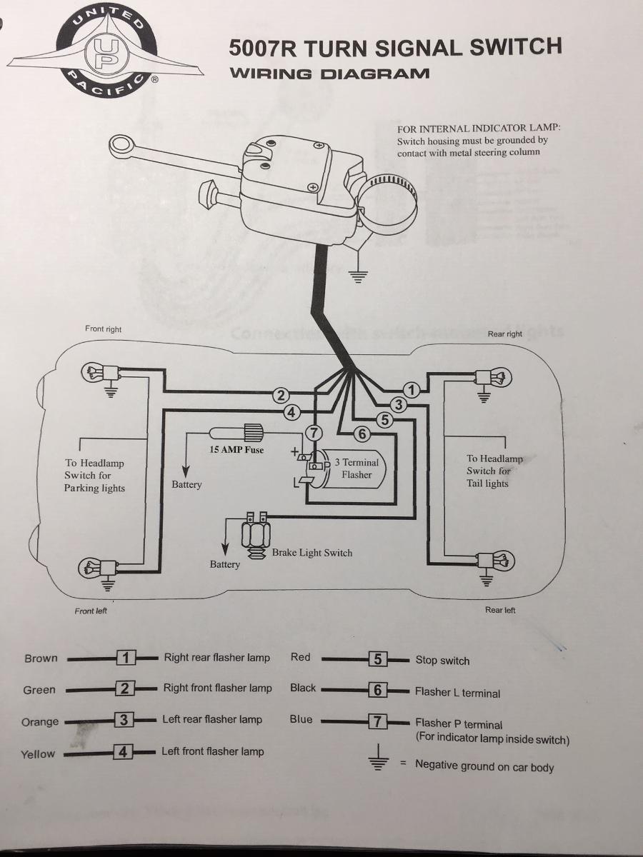

If the front parking lights do not have a dual element socket, you will have to replace them. The tail lights already have a dual element bulb and the current stop light is usually used for the turn signal and stop light. The switches do not care if they are installed on 6 or 12 volts. You will need to get a 6 volt flasher relay and a 6 volt bulb to replace the 12 volt bulb in the switch.
Tyree Harris may have a wiring harness for the turn signals. They were an option on the 1947 Ford. If he has one, it will make the installation easier.
Tyreeswires@gmail.com
The installation basics are: mount the switch, reroute the brake light signal through the tuurn signal switch, route new wires to the brake lights and parking lights from the turn signal switch and supply power to the turnsignal switch.. There are several schematics of wiring turn signals on the internet, just Google for them. You will also get a wiring diagram with the switch.
