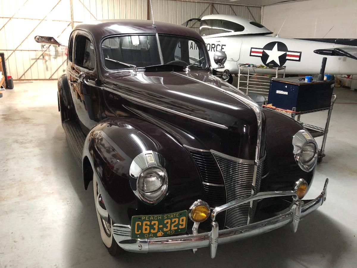

Thanks for the advice guys. The engine had 231 miles on it when I got the car..
It has 8,785 miles on it now. The fine old fellow who did a good amateur restoration on the Coup passed away and the Car sat in a barn for 3 years. It has leaked ever since I
Acquired it and after flying my 1950 Navion for 40 years , I just can’t stand oil leaks.
Also leaking a quart every 600 miles is just too much as Alan said. I had to be a little handy to fly that Navion for all those years but at 83, just don’t trust my mechanical skills so much anymore but I still fly.
It is not a “Dearborn candidate by any means but I drive it and it is a crowd pleaser.
I was hoping to be able to have a seal installed without pulling the engine, if I have to do that, I will take the advice to do the other work mentioned. Thanks for the advice
