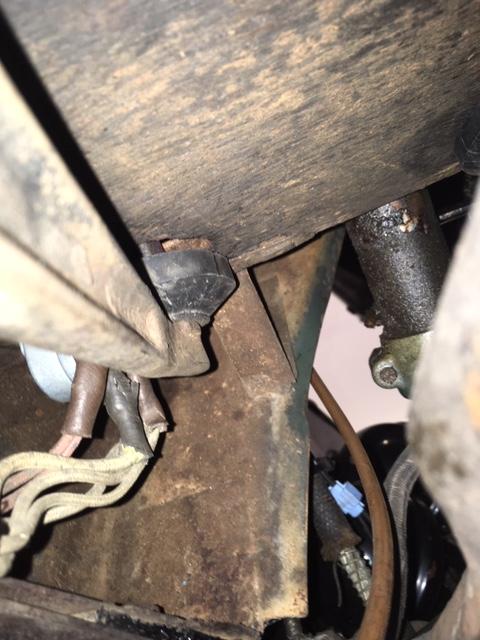

On my 40 the wire connections on the head light dimmer switch are very close and almost rub the clutch pedal bumper.Is this normal or do I by chance have the wrong dimmer switch or it mounted the wrong way?

Kube,this is about the best I can do on photo.As you can see it is kinda tight with the clutch pedal bumper.I am in the process of new wiring so that wiring will be changed.
09-03-2020 @ 1:41 PM
Posts: 3575

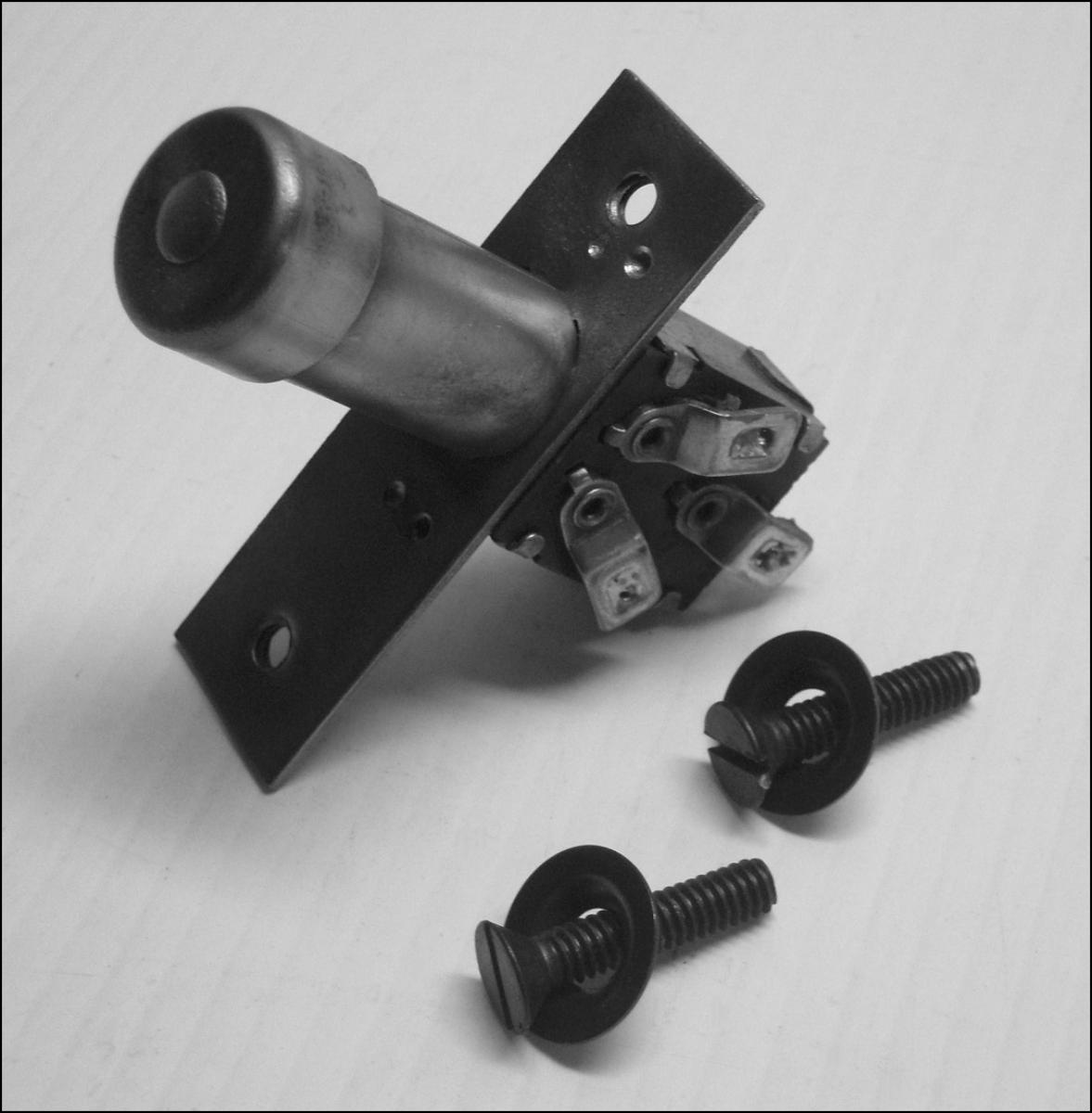

You have a later after market switch in there. That may be part of the issue. However, even with a concourse correct switch, there isn't a lot of clearance between the switch and pedal.
The photo I'd attached is a correct switch. I believe it is a tad slimmer than yours.
Hey, as long as there is no interference between the pedal and wires, you're "good to go".

Was re-installing my headlight dimmer switch today and remembered your post about tight clearance at the clutch pedal . I have adequate clearance there. I had replaced the pedal rubber bumper stops, and one of the bumpers came with a side narrower than the others. Wasn't sure where the narrow side was to go, but looked like it should go next to the headlight switch for clearance. Can't tell from your photo if you have a narrower bumper next to the switch.

Jay,I see what your are talking about.That may be where my problem is.I have the dimmer switch pulled now to install new wiring and will take a look at the bumpers.Thanks

Jay, the narrow bumper is for the clutch pedal. The "cut off" side of the bumper is to clear the frame rail.
