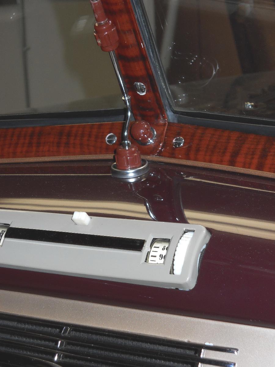

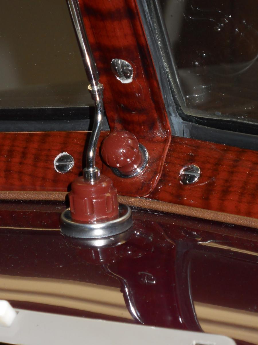

1940 Tom |
06-05-2020 @ 1:48 PM
Posts: 235
Hello Paul-- See attached. Hope they help. Good luck with the W/S seals. Tom
