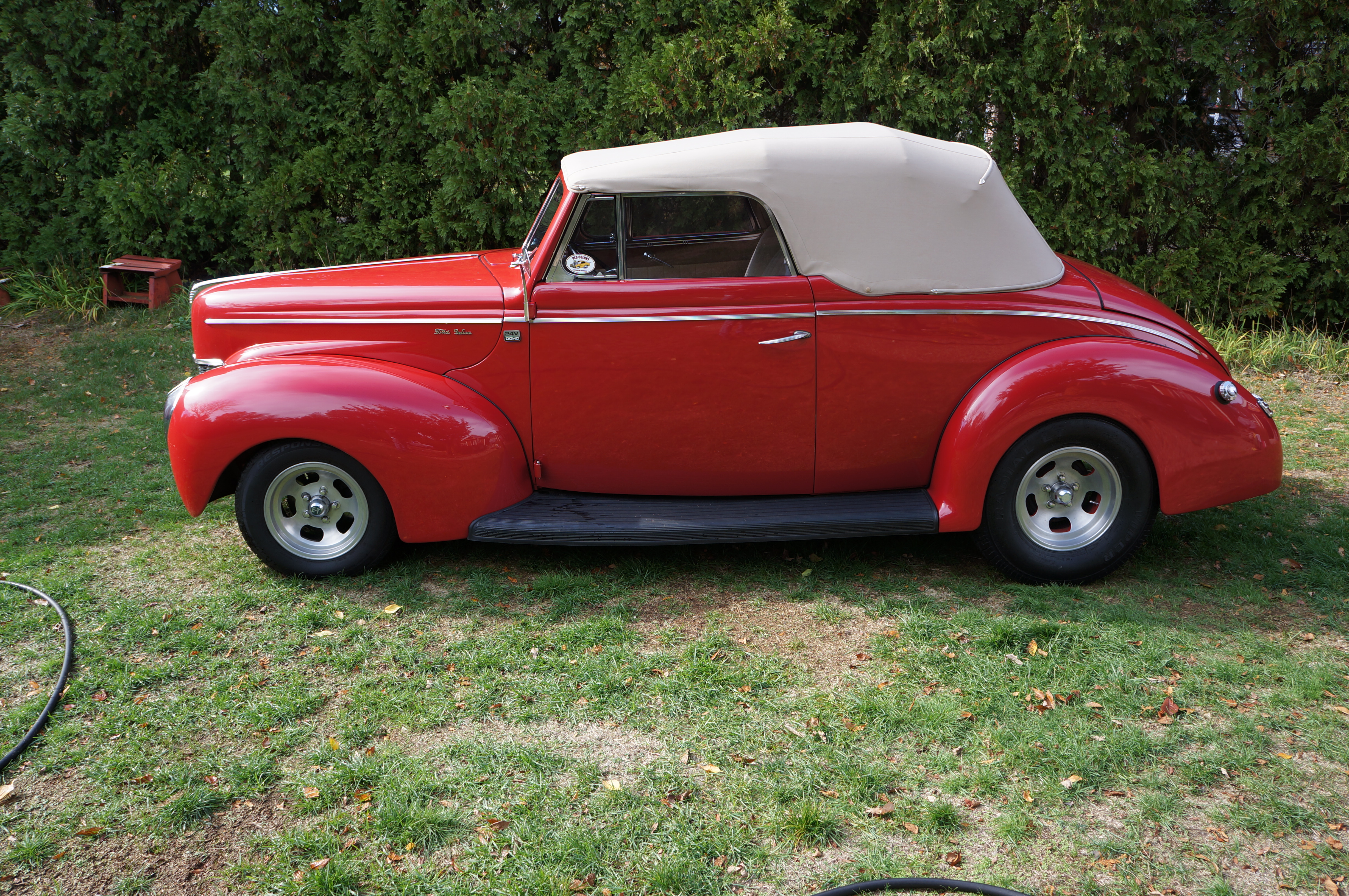

05-02-2016 @ 3:08 PM
Posts: 464
Joined: Feb 2010
Well I did my boards over ten years ago, stripped them, sandblasted them and painted them with red rust oleum . Then I glued them withe the glue from drakes. They still look good but are probably not perfect for concours,, but I drive it every where.
