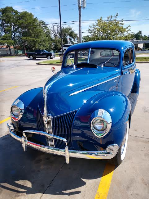

I'm 2 weeks into taking ownership of a 40 ford 2-door standard sedan. The front seat is stuck in a forward position too close to the steering wheel. Can't get a good look at the hardware because of the foot rests on the back of the front seat. How do I remove the foot rests? I can't see how these could be useful in the first place.
