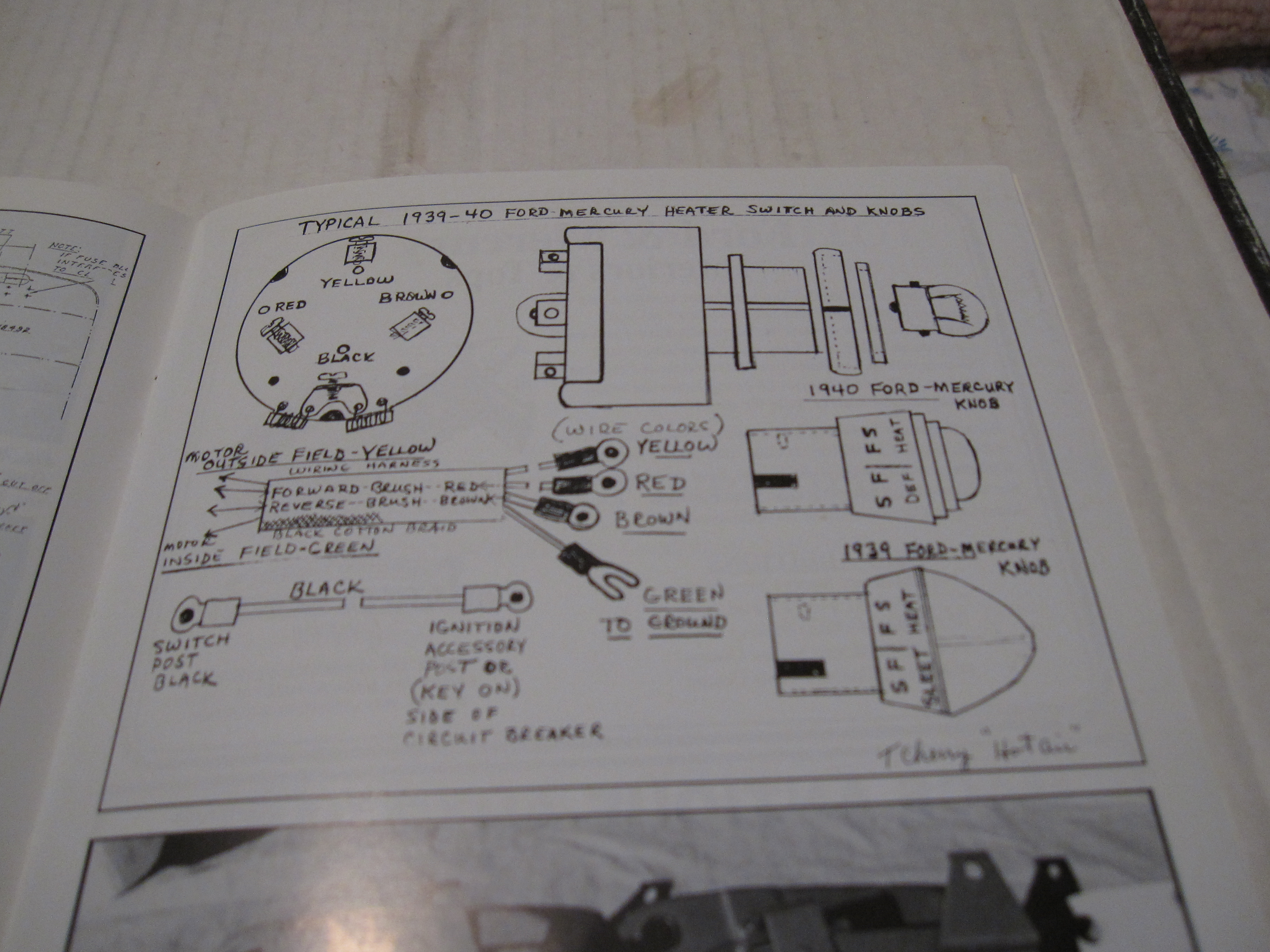

10-07-2017 @ 6:49 AM
Posts: 152
Will this help ? It is out of the V8 Times Magazine July/Aug. 1989. Sorry posted on wrong question.
