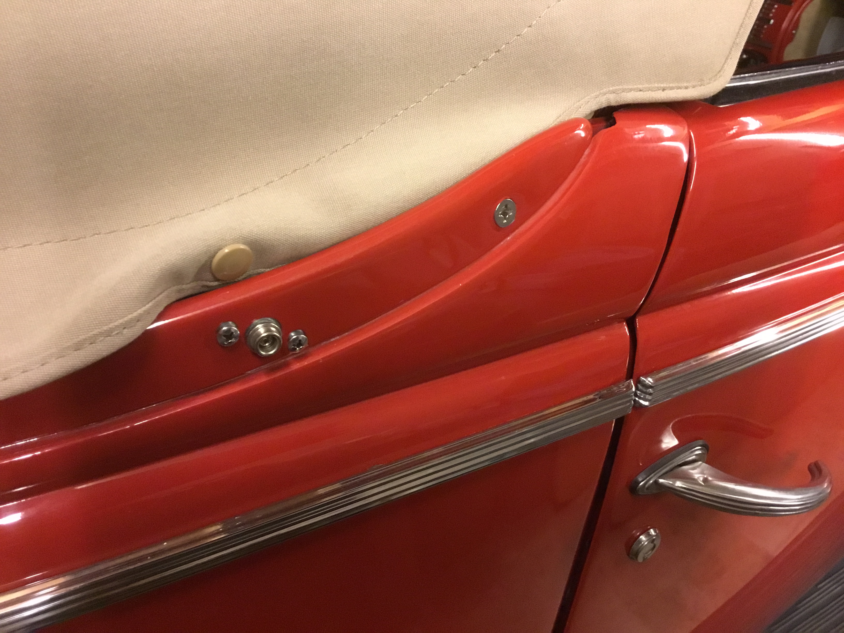

Kubes were boot covers a factory option? I have looked at a lot of pictures not all the snap placement does not look the same. Is there a snap supposed to be where i have a screw? Is there a snap that uses machine screws?

There were two distinct designs of the so called "banana clips". Yours required a snap in the place you have a screw.

Ok was that a special screw ,to hold tha in place?

I'd really need to see what is beneath the "banana clip" trim to say for certain what type of fastener was utilized there. My hunch is the clips do not match the body beneath them.

Mike thanks for the help, i wound up making an aluminum spacer for that front snap , two days of sweating out to get the snaps in with out scratching the paint or ripping the fabric. Now to put the the snaps in the boot,, should they be plain stainless or painted beige?

Snaps are stainless... "rustless steel" in that days terminology.
