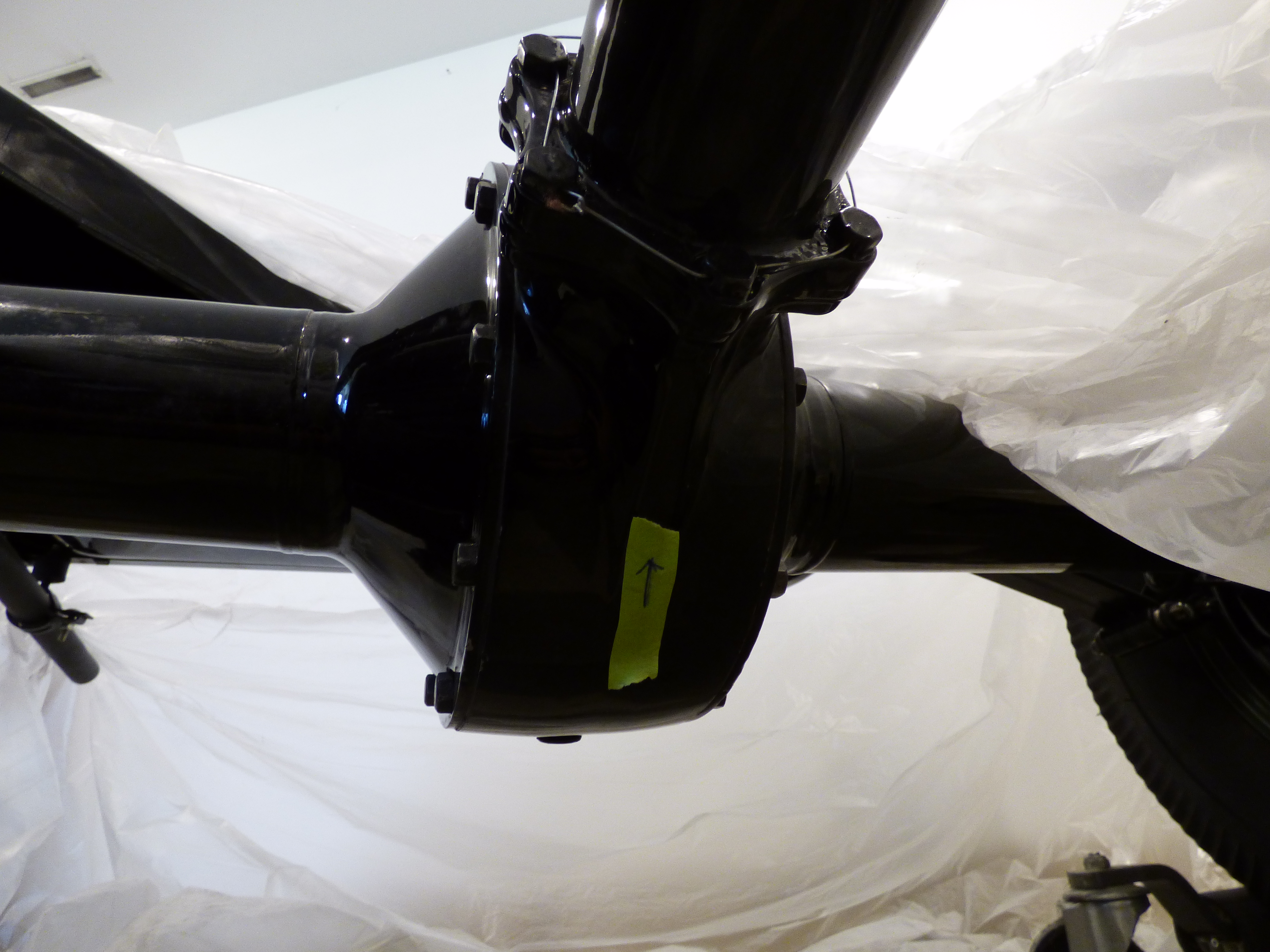

Can someone tell me exactly where to look for the rear end ratio stamping, on the rear of a 1940 ford. Also Mike, am I correct to understand that their is a total of sixteen grease fitting, not seventeen? AS stated only one for the shift linkage under the hood. Plus the two in the center of the transverse spring. Also what kind of grease would you recommend for the springs? Domenic

Yep, sixteen total. I goofed - plain and simple. Sorry The springs used a lubricant specifically designed for them. I had a pail of it years ago. It reminded me of the old STP oil treatment. Remember that? Almost like a VERY thick oil. I've posted a photo that should help you find the numbers you are searching for. The flat boss just above my arrow (green tape) is where they were stamped.

Hey Charles, the reason for wanting to know the correct rear end ratio in my 1940 ford, is because I am in the middle of ordering a N.O.S speedometer gear and housing that mounts on the tail section of the transmission, and the speedometer cable screws into this housing. The parts man requested the ratio, so he can sell me the proper ratio gear and housing . If not done correctly, your speedometer will be off , and the cops will be after you . With a closed drive shaft, I can't count how many revolutions it has with one complete turn of my wheel. Thanks to Kube"s for the location details. My car's rear is stamped 9.34 so I believe that's about 3:70 to one. And that also feels about right when I drive the car. This particular ratio requires a 19 tooth gear, and housing. Dom Domenic

That would be a 3.78 which is pretty much the stock ratio for a 40.
