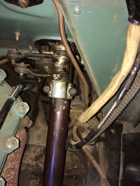

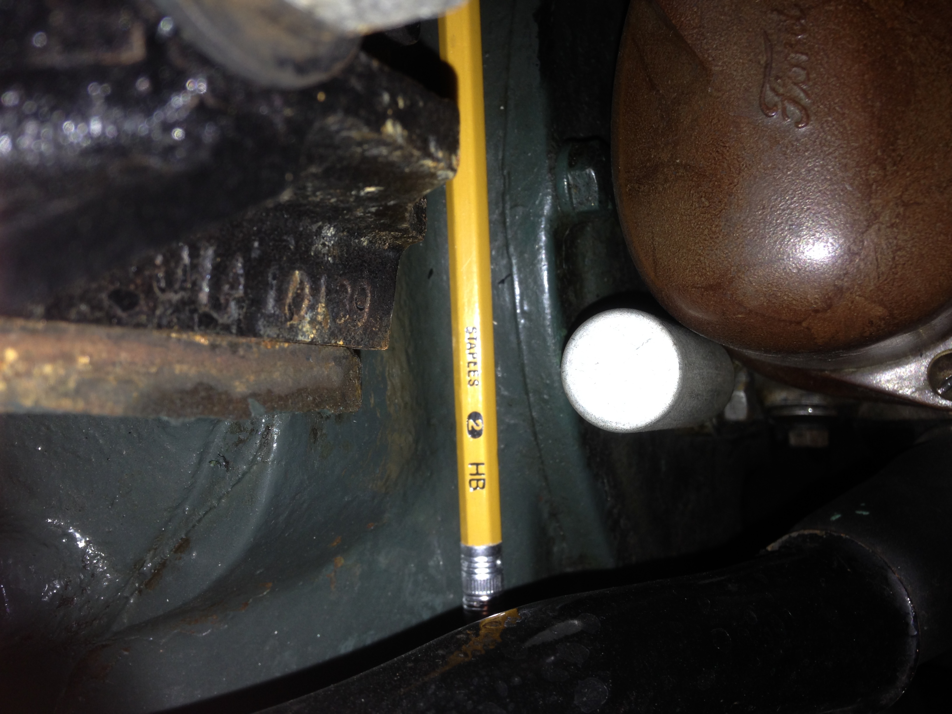

Jay, You win the "caught Kube" prize today. I scr*w*d the pooch and you caught me. There is no fitting at the bottom of the column. Y
I apologize. The only one on the column is depicted in the photo.

I'm using the list Kube posted above to make sure I don't miss one if the 17 grease fittings. (Mike, thanks for taking the time to write that list.)
One line item on the list is:
"There is one at the top and one at the bottom of the shift linkage beneath the hood. (total two)."
I can only find one fitting on the shift linkage.(see picture below) Need help finding the other. Thanks.
