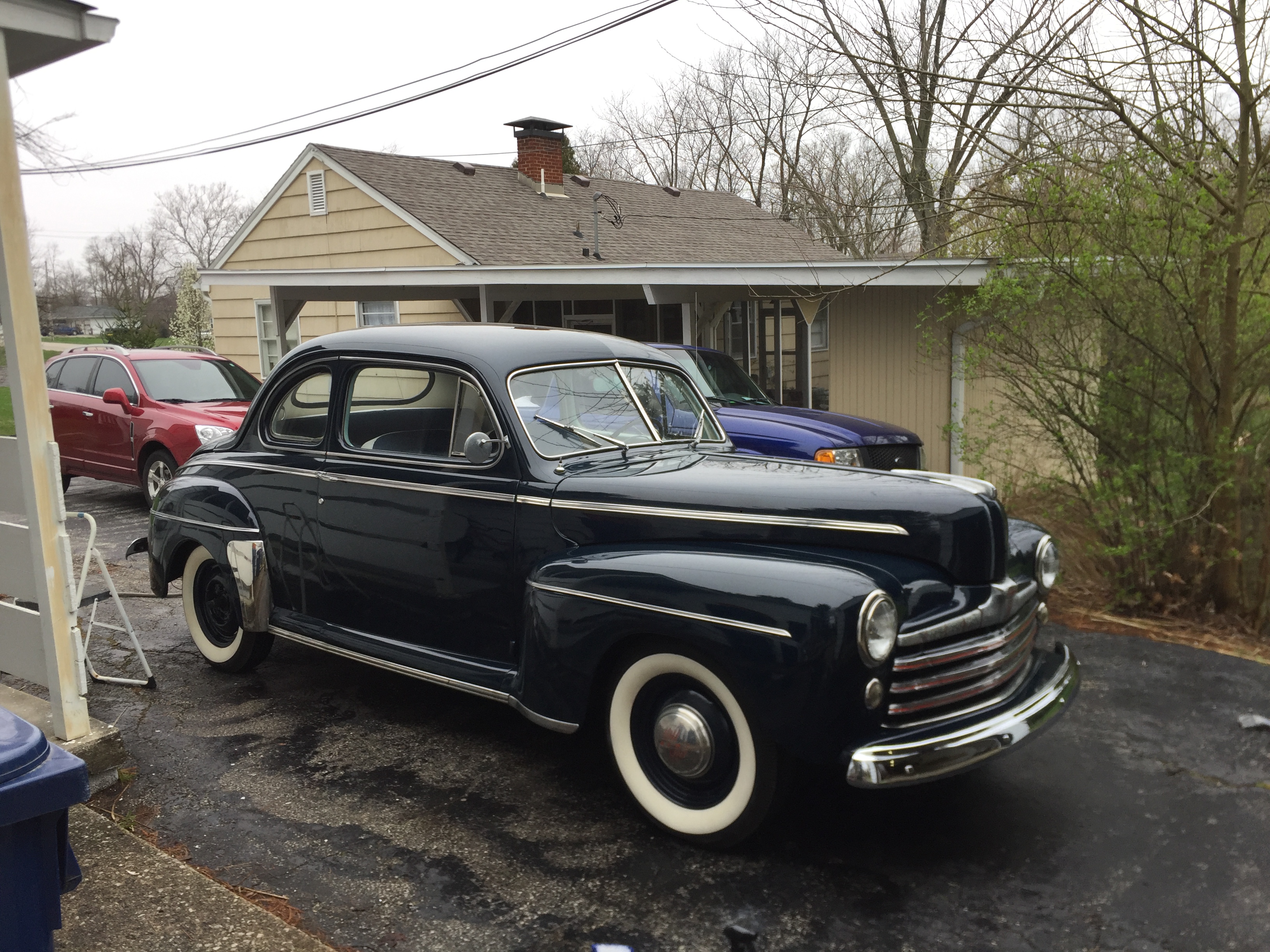

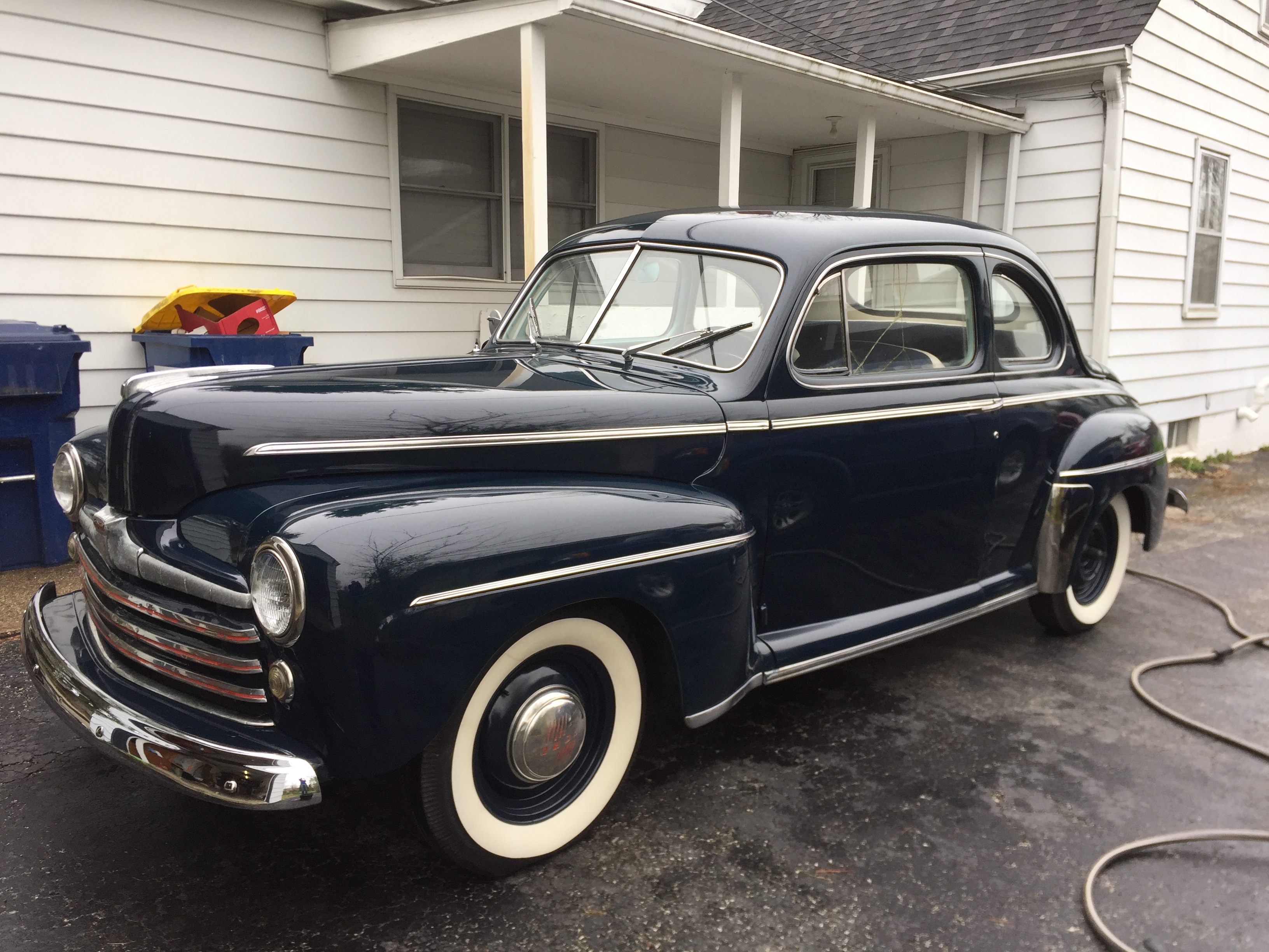

Rob, that is a very nice driver quality car. You can enjoy it as it is or spend the money to install original type items, the choice is yours. Your car would be a welcome sight at a V-8 Club meet in the Touring Class just as it is, while you make up your mind about how to proceed.
The Club's 41-48 book will help you decide how much has been changed and parts catalogs like the Green Book will help you identify the part number of the parts that you may wish to purchase.

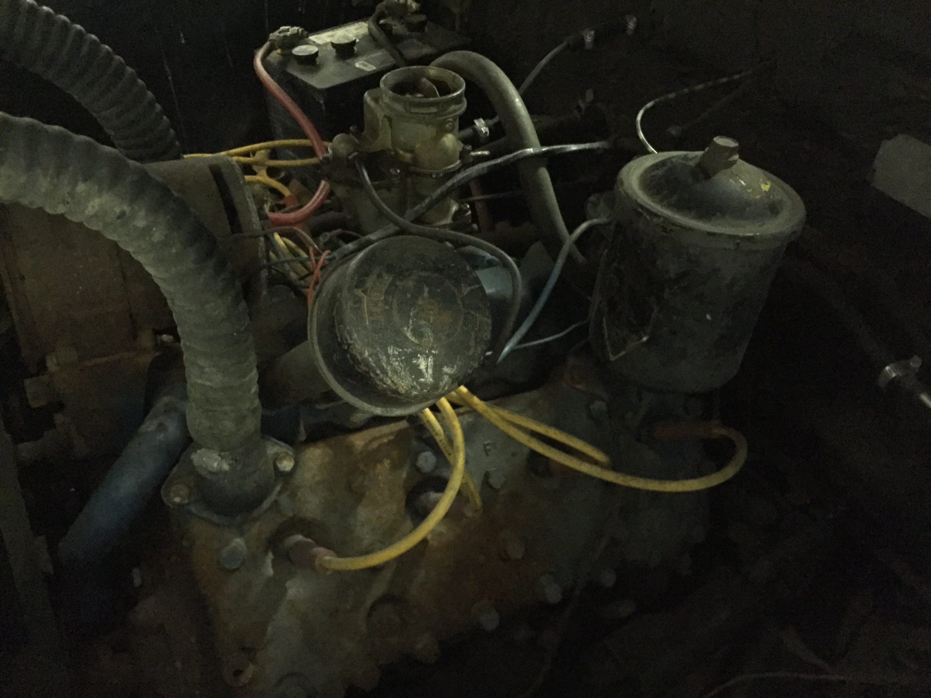

ken ct.
04-04-2017 @ 10:05 PM
Posts: 1513

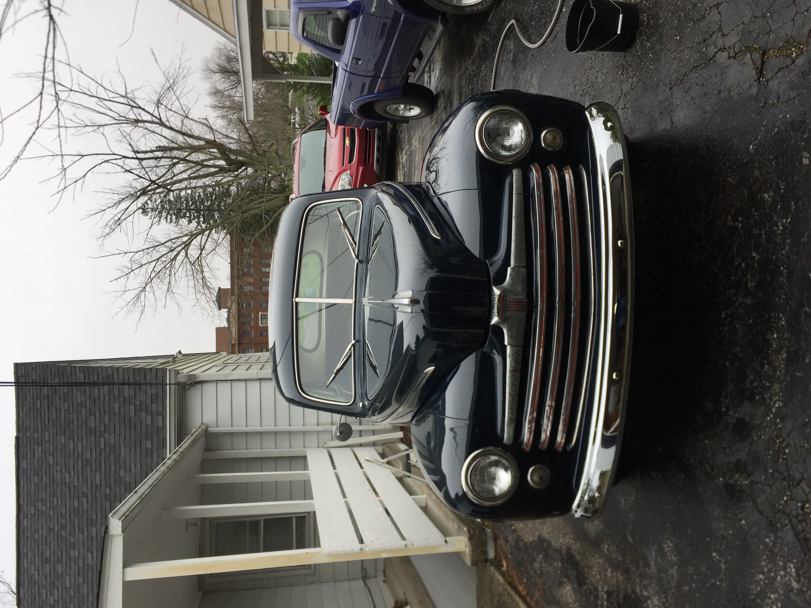

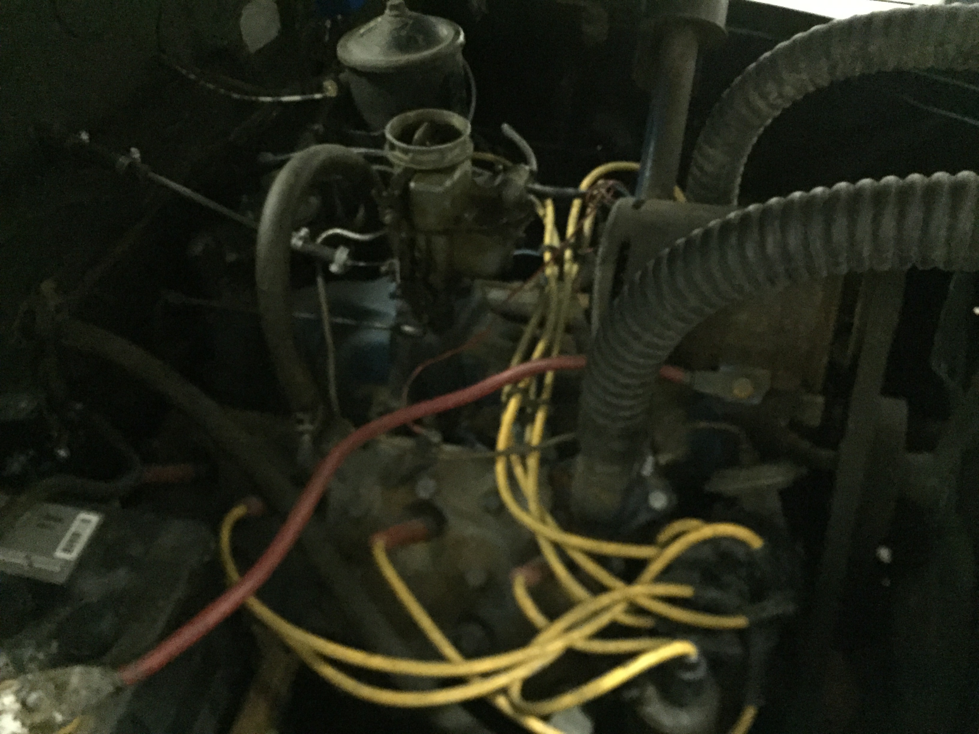

Definatly a 49-53 engine along with the oil fill breather tube at the front of engine. Pics are on the dark side hard to make out.I guess your grandpappy never told anybody he installed a later engine in it. Possible change in front clip to 47-48. Easy way to tell is side chrome on a true 46 has a diff. profile (edgewise) than a 47-48. good hunting. ken ct.

04-04-2017 @ 7:37 PM
Posts: 2883
Rob, A "serial number on the title" may or may not coincide with the actual number stamped into the frame. I hope you did confirm that yours do in fact match. The number you posted does match as being a '46 Ford, but always check the frame against the title.
While your engine is not original, serial numbers are not to be found on engines anyway, but rather, on the transmission bell, which would then be copied to the left front frame rail at the assembly line. You likely do still have the original transmission. Beautiful car!

04-04-2017 @ 7:17 PM
Posts: 20
Joined: Apr 2017
So Ken, you're saying possibly not the original engine?
The 8BA is more from 49-1950's?
Thank you for the input!
Rob

Engine

Engine

More photos of engine
