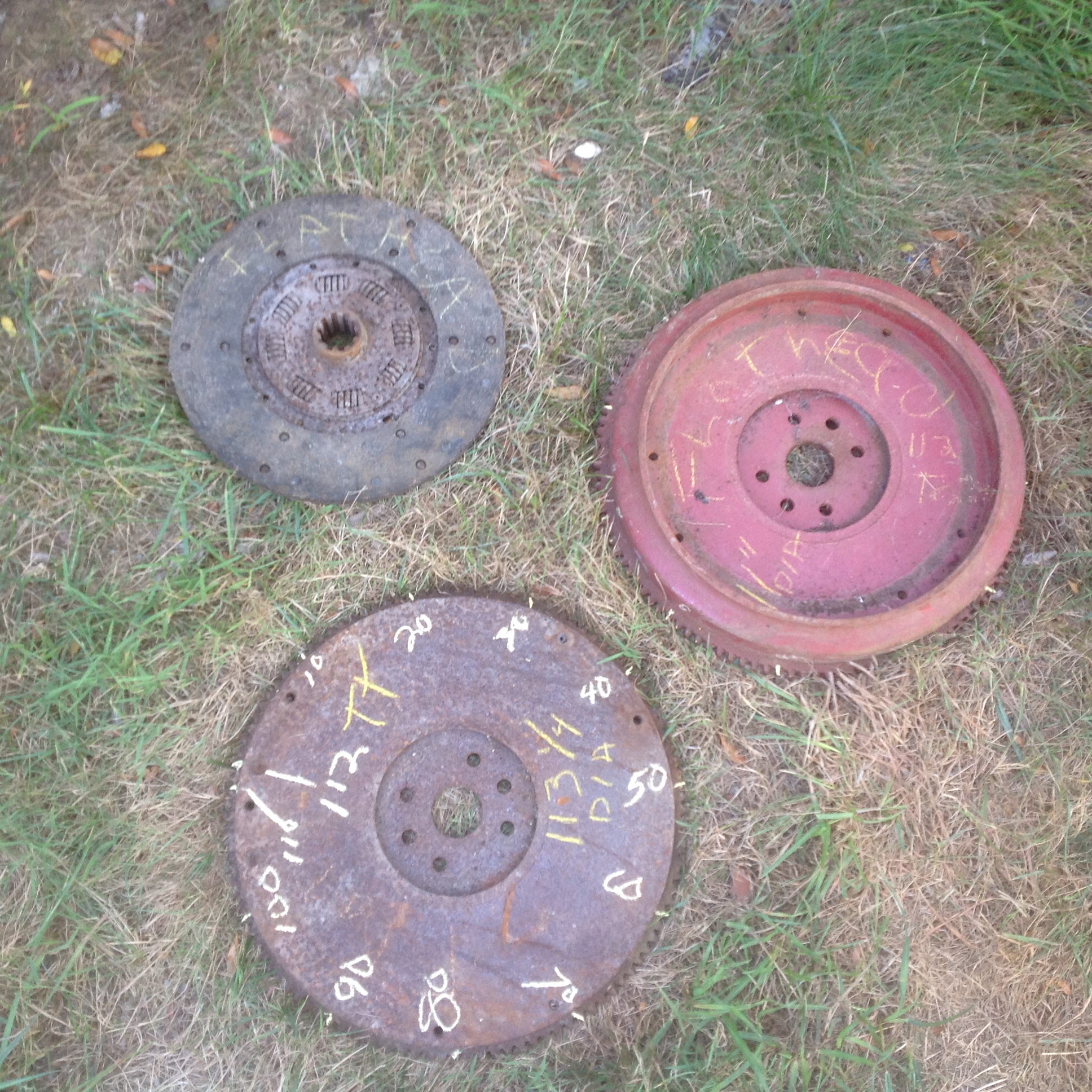

Kubes is the red flywheel with the recess for 39/40 flathead??
09-15-2016 @ 6:30 AM
Posts: 3575
It certainly appears to be.
09-15-2016 @ 7:54 AM
The red one appears to be for the 9" clutch and the other flywheel looks like it may be drilled for the 11" clutch. The 10" clutch used a flat flywheel also.
