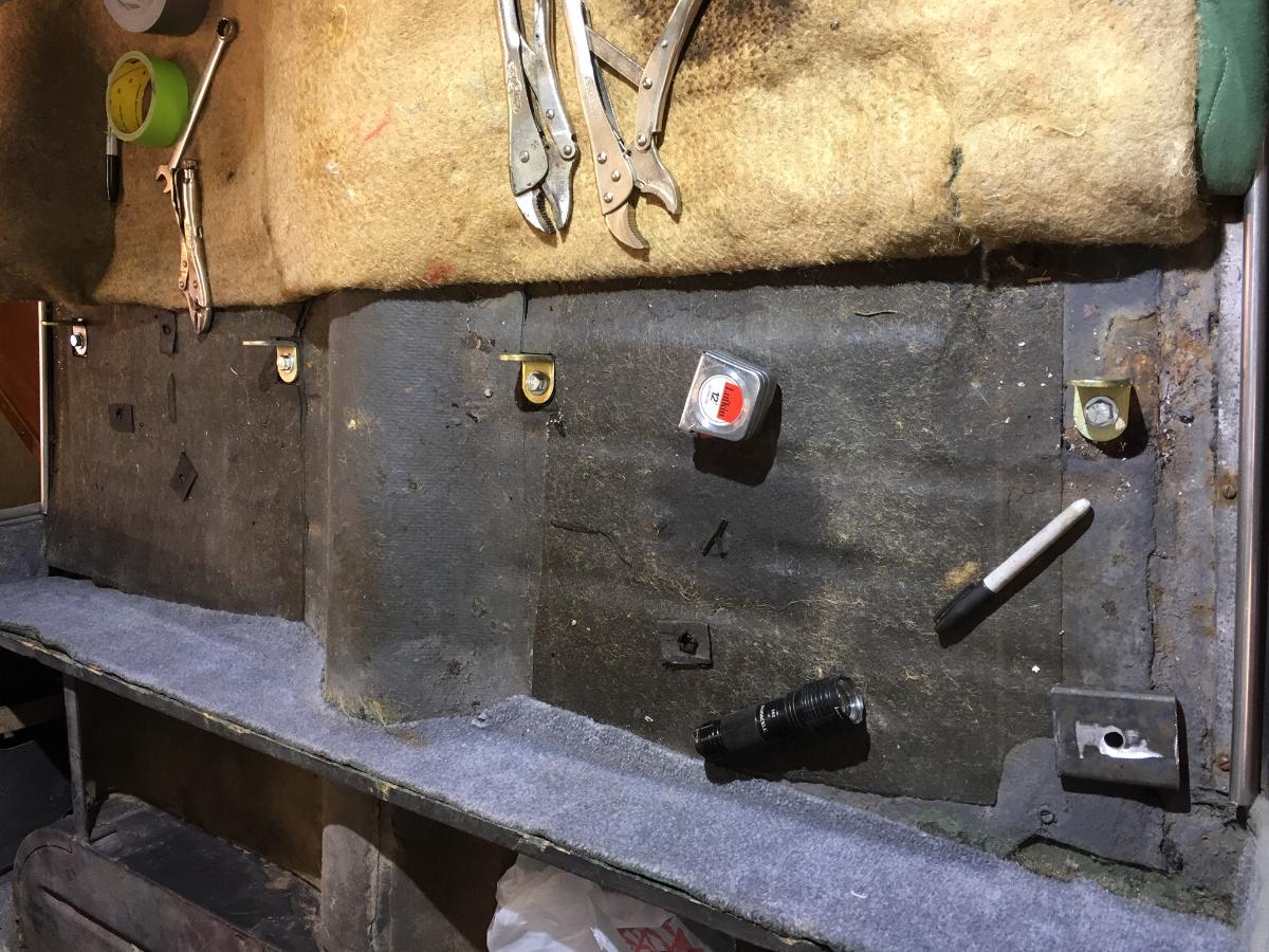

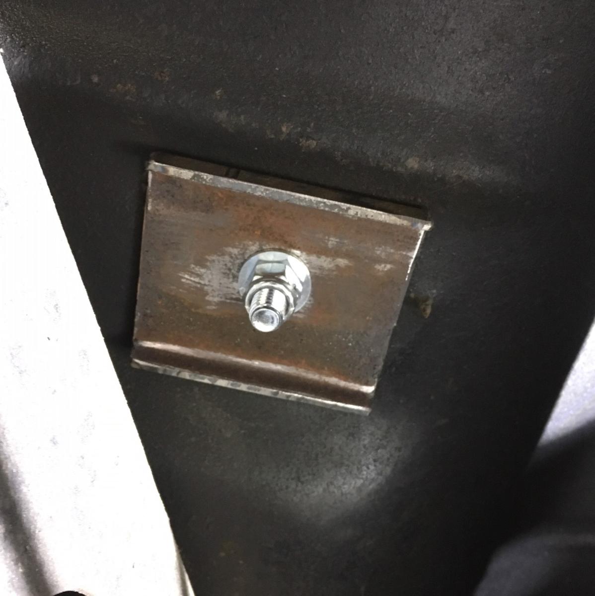

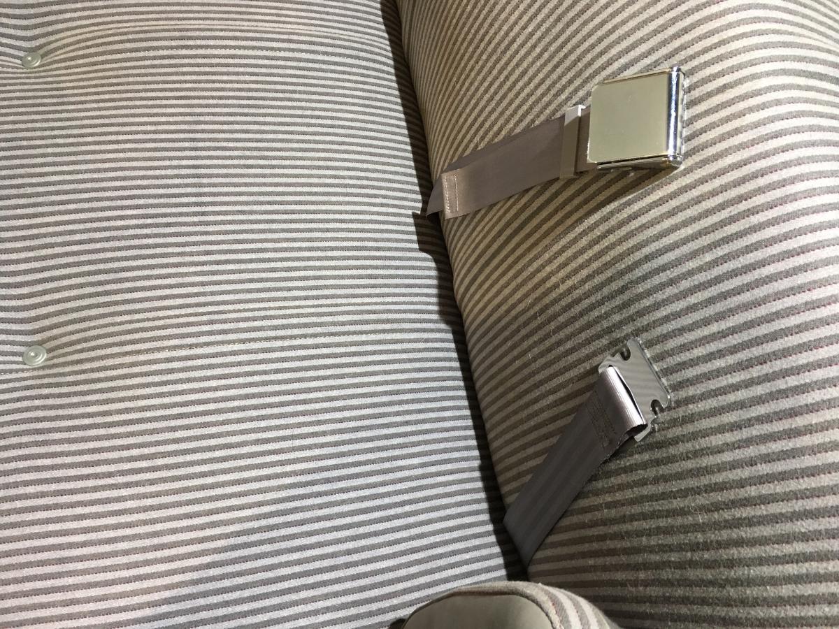

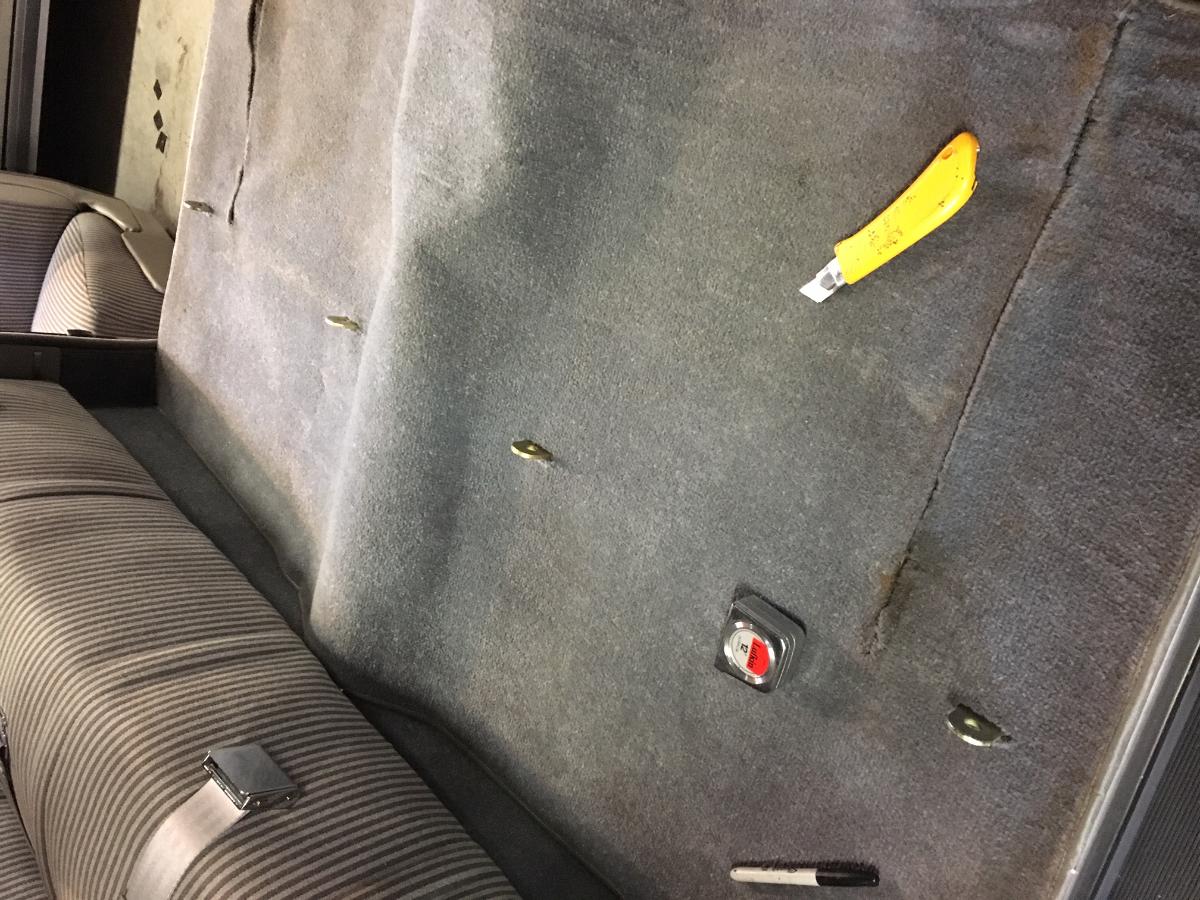

51woodie    -- 10-02-2020 @ 2:21 AM
  Garrison. If you do a search for "seatbelts", you will find a lot of info. Here are a few. Regarding the carpet, because I used L mounting brackets, I didn't drill through the carpet, I just cut a slot for the carpet to slip over. Use good sized backing plates to reinforce the attachment to the floor pan.
https://www.earlyfordv8.org/forum/viewmessages.cfm?Forum=18&Topic=13460&keywords=seatbelts
https://www.earlyfordv8.org/forum/viewmessages.cfm?Forum=18&Topic=13072&keywords=seatbelts
https://www.earlyfordv8.org/forum/viewmessages.cfm?Forum=18&Topic=11749&keywords=seatbelts
Some pics rotated when posted for some reason.
This message was edited by 51woodie on 10-2-20 @ 2:22 AM
TomO    -- 10-02-2020 @ 8:10 AM
  51Woodie gave good advice. Do not install seat belt mounting brackets over carpeting, the mounting bolts may loosen over time and fail when you need them the most.
