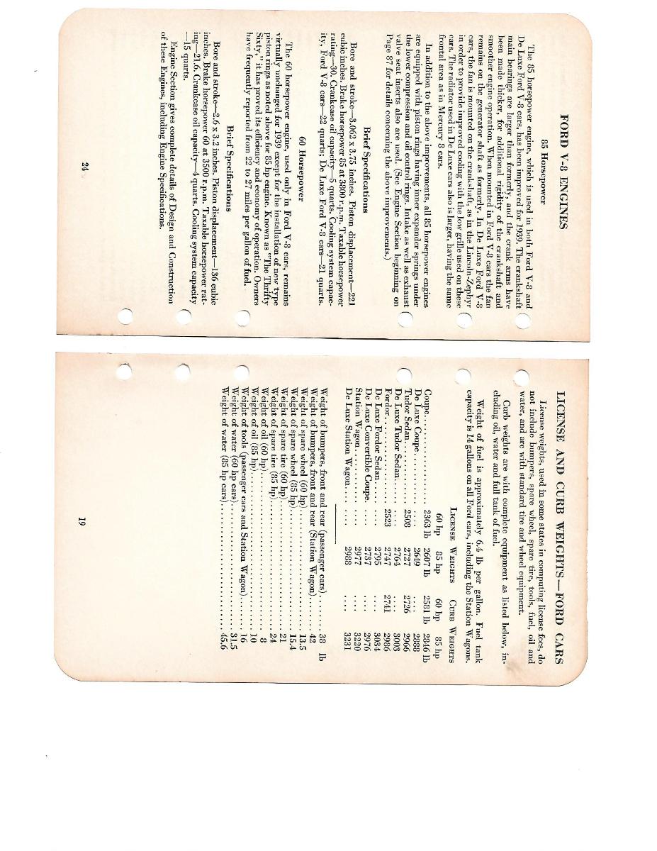

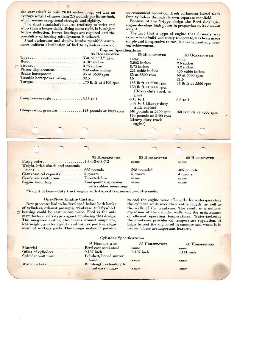

Some of Fords Spec. for the 39 and the 85 HP V8 and their source.

Thanks 40 Coupe! These documents will surely help! Best, Bill Tuttle
