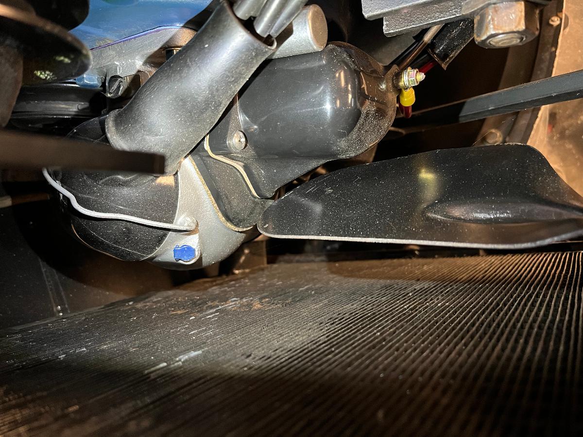

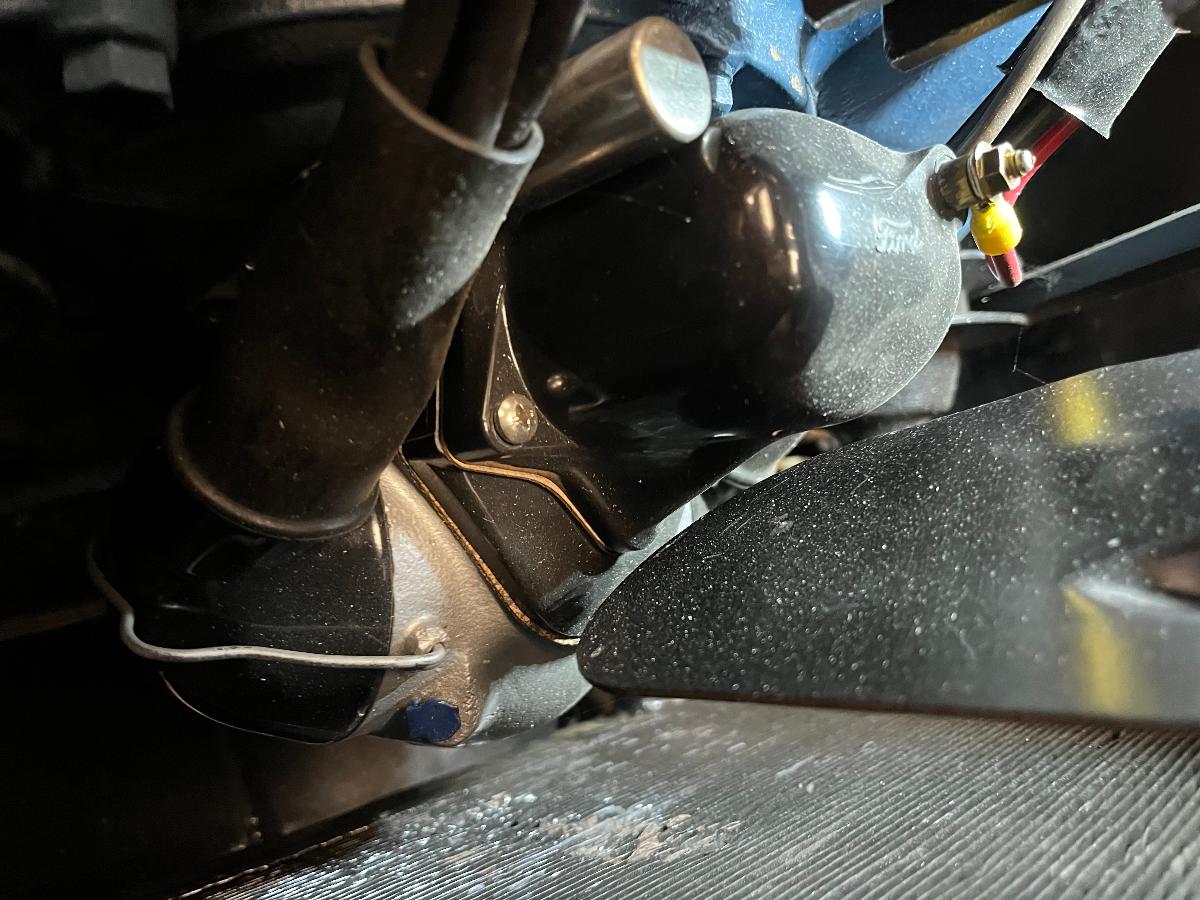

Generator mounted cooling fan is giving me concerns..
A little background : the fan from the 35 engine provided clearance from rad but not the distributor.
tried a fan from 60hp flathead.. has a longer neck ..still no clearance to distributor.

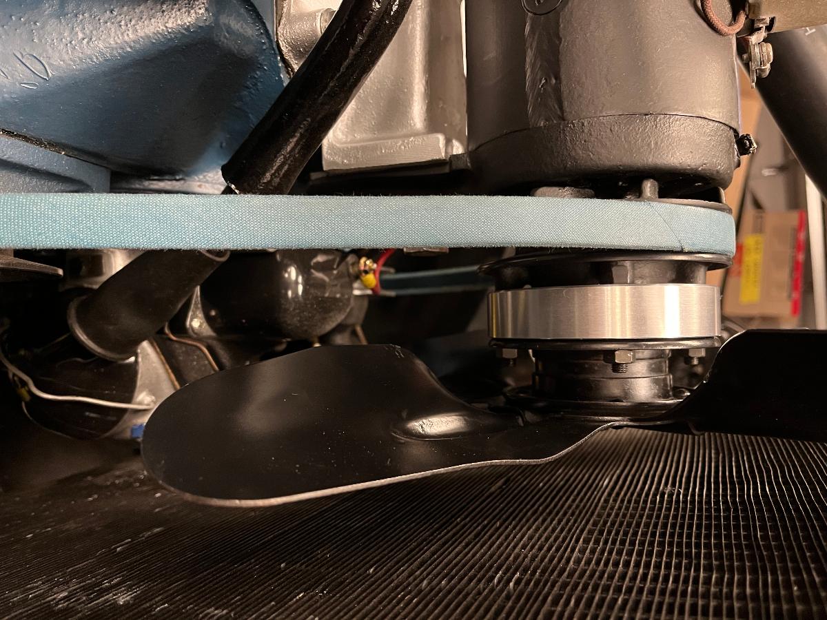

Had a spacer machined to use the original 35 fan...
The spacer and 35 fan is installed and does provide clearance in both areas of concern.. BUT the clearance is minimal.
Have about 1/8" clearance from the distributor....
Have about 1/4" clearance from the radiator....
I have tired fan belts of various lengths to raise generator to enhance the clearance ..
Because the radiator is slightly canted back at the top.. as the generator is raised to tighten fan belt the closer the fan gets to the rad..
I have elected to stay with the shortest belt to achieve the best compromise.
Looking for reassurances that amount of clearance I have achieved and mentioned above are workable.

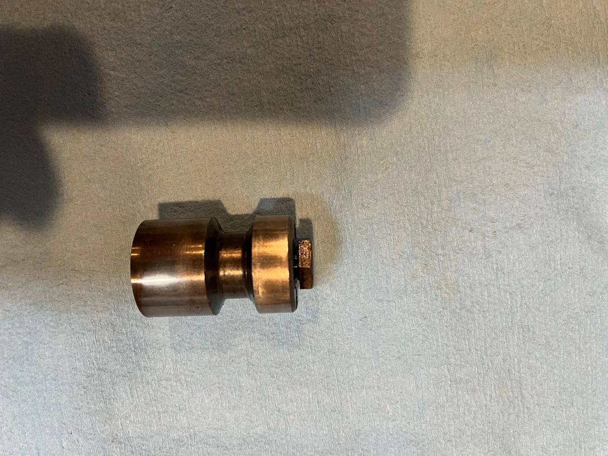

I have taken the 35 engine apart to inspect .. has babbit mains and inserts in the connecting rods.. cast iron heads in good shape.. #4 piston was tight to move due to a little ridging on top of cylinder .. minor corrosion on associated valves.. all components move.. some valve stems a little tight in the guides.. has adjustable tappets.. and tappet gallery has been drilled to assist in holding tappets during the adjustment exercise. Tappets are odd to me as they don't have the oval cut outs in their side surface to accommodate the easier adjustment.. they have a horizontal groove around the whole tappet.

Rudy, this is an easy swap. Methinks you should install the '35 distributor and coil. From your photo, it appears there is plenty of clearance between the fan and distributor. The clearance to the coil is tight.

was wondering how the rear trans engine mounts are, ?
looks like the engine is tilted on a angle
what I did was use a adapter to use a modern coil and a flat plate on the distributer
they sell these for about $40.00
if the back of the engine was raised it better for clearance
I did this exact same thing in the 1980s with no problems. for a customer,

11-29-2024 @ 7:21 PM
Posts: 2848
Use your 35 bolt-ons. Fan & generator mount on the intake manifold are different.

looked at the 35 intake and can see the difference.. should solve my problem.
