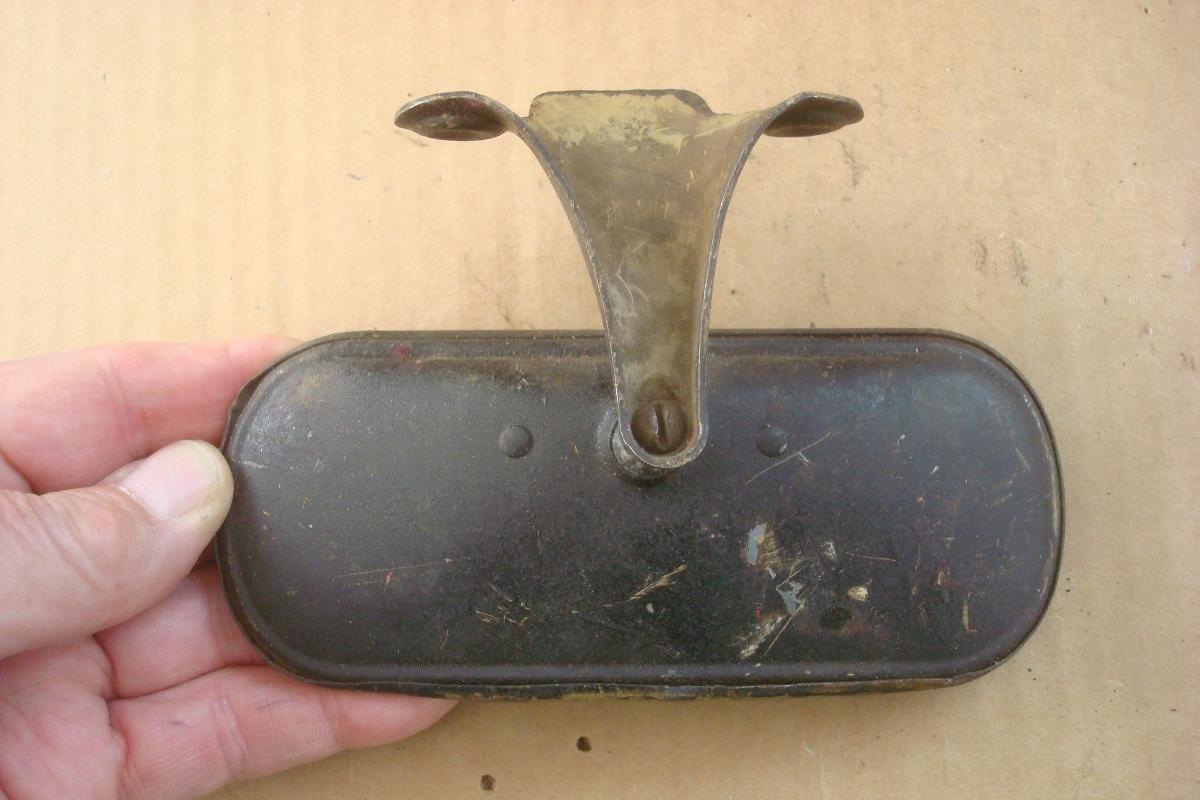

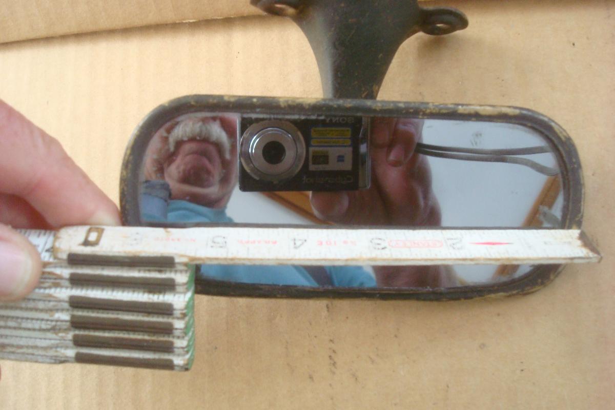

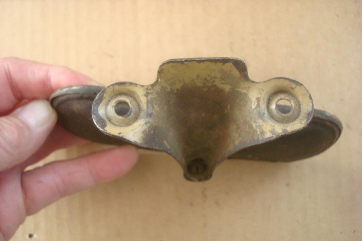

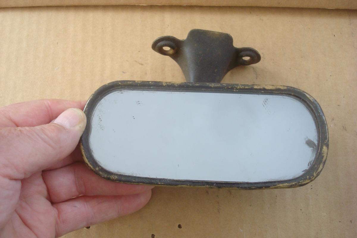

06-09-2022 @ 11:00 AM
Posts: 1897
rear view mirror
I came accross this mirror the other day
I do not know if what truck or car it fits,
but is all original,
something like this might work for you ?
hope this helps, 37 Ragopman
I will post this on CLASSIFIED SECTION for sale
