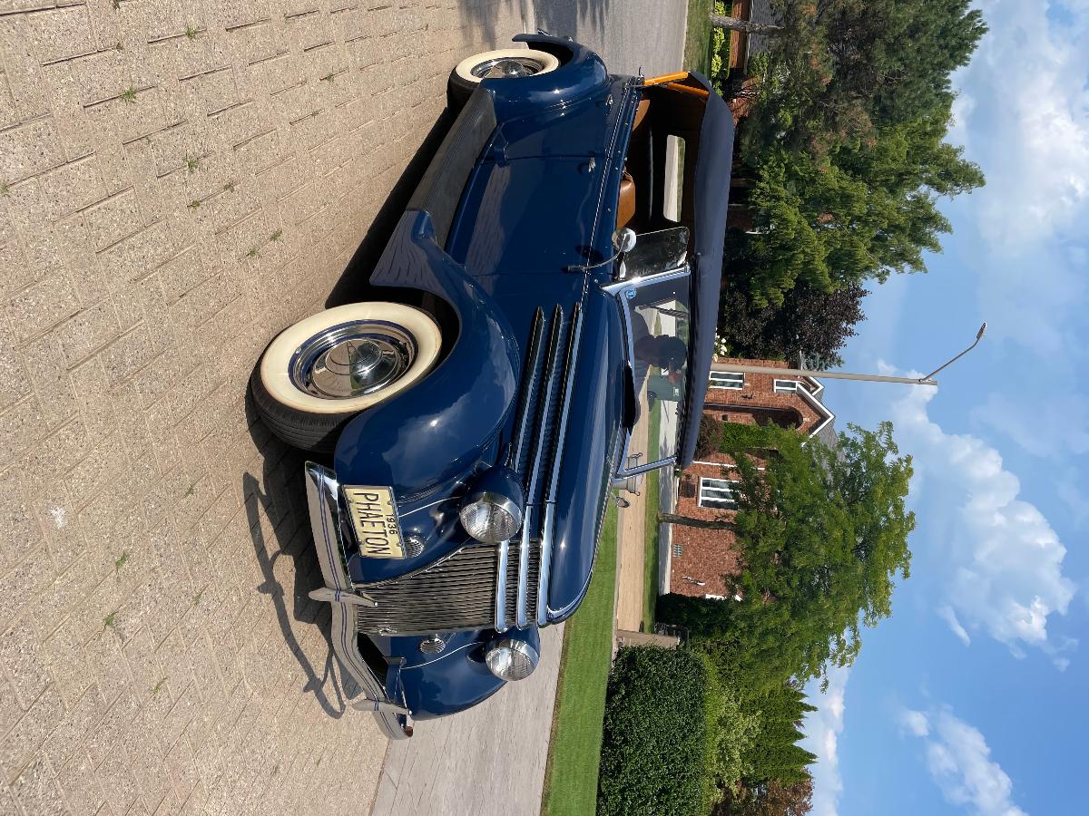

Just purchased a 1936 ford phantom 68 convertible
Just wondering drove 30 miles in 98f and was very difficult to start
After we stopped
Does any ever put another six volt battery to help x2
Will take any coaching

does the engine trun over slowly when hot, ?
if it turns over of, and
the hard starting hot is most likely caused by a weak or failing coil
a simply test is to run the engine till it is hot,
try starting if not,
try this put a ICE PACK on the coil, wait a few minutes, if it starts , the coil is failing,
while you were driving did you lose power ?
also go over all the starter cables make sure they are 6 volts, and all battery connections,
clean and tight,
let us know how you madse outl
hope this helps. 37Ragtopman there is nothing wrong with the 6 volt system if it is RIGHT
