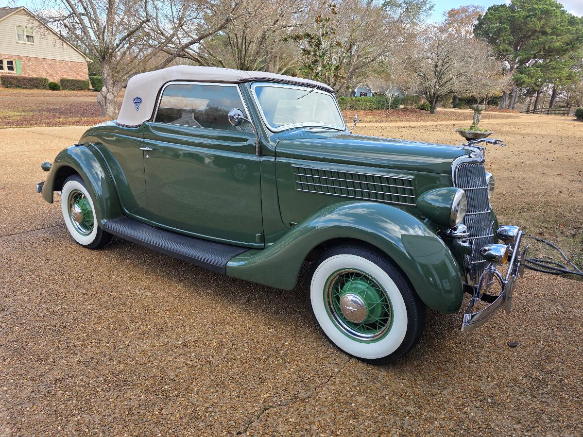

This is wonderful information. Thanks to you and above for sharing. I cut my teeth on Model Ts over 40 years ago, and still drive them. They tend teach me about prevention and proper maintenance while being quiet forgiving at the same time.
My dream of becoming a caretaker of an Early V8 financial became a reality last fall with my birthday present to myself of a '35 Cabriolet. Been kicking myself for not doing it sooner. Anyway, this group seems just as anxious to help others as the T Modelers. Much appreciated. As I learn more about my '35, I'll be back with more questions. In the meantime, I don't remember a birthday present that has brought me more fun!

12-27-2025 @ 3:41 PM
Posts: 26
Joined: Apr 2025
GORGEOUS AUTOMOBILE!
