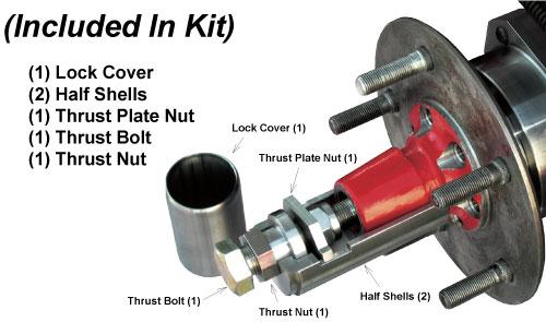

Hi. I need to pull the back hubs off my ‘37 Tudor. The studs are 10 inches apart. I can’t find a hub puller with more than a 7 inch spread. Does anyone know where to buy one or how to remove the hub some other way. I need to get to my brakes. Thank you. Brad

This is what you need:
http://vintageprecision.com/products/hub_pullers/

Will that work on his wide-5 drums??
Paul in CT
08-06-2022 @ 6:51 AM
Posts: 4126
Works on 1928-1948 Ford drums.

I bought and used one on my 37 coupe. They work Great. Nate Anello
