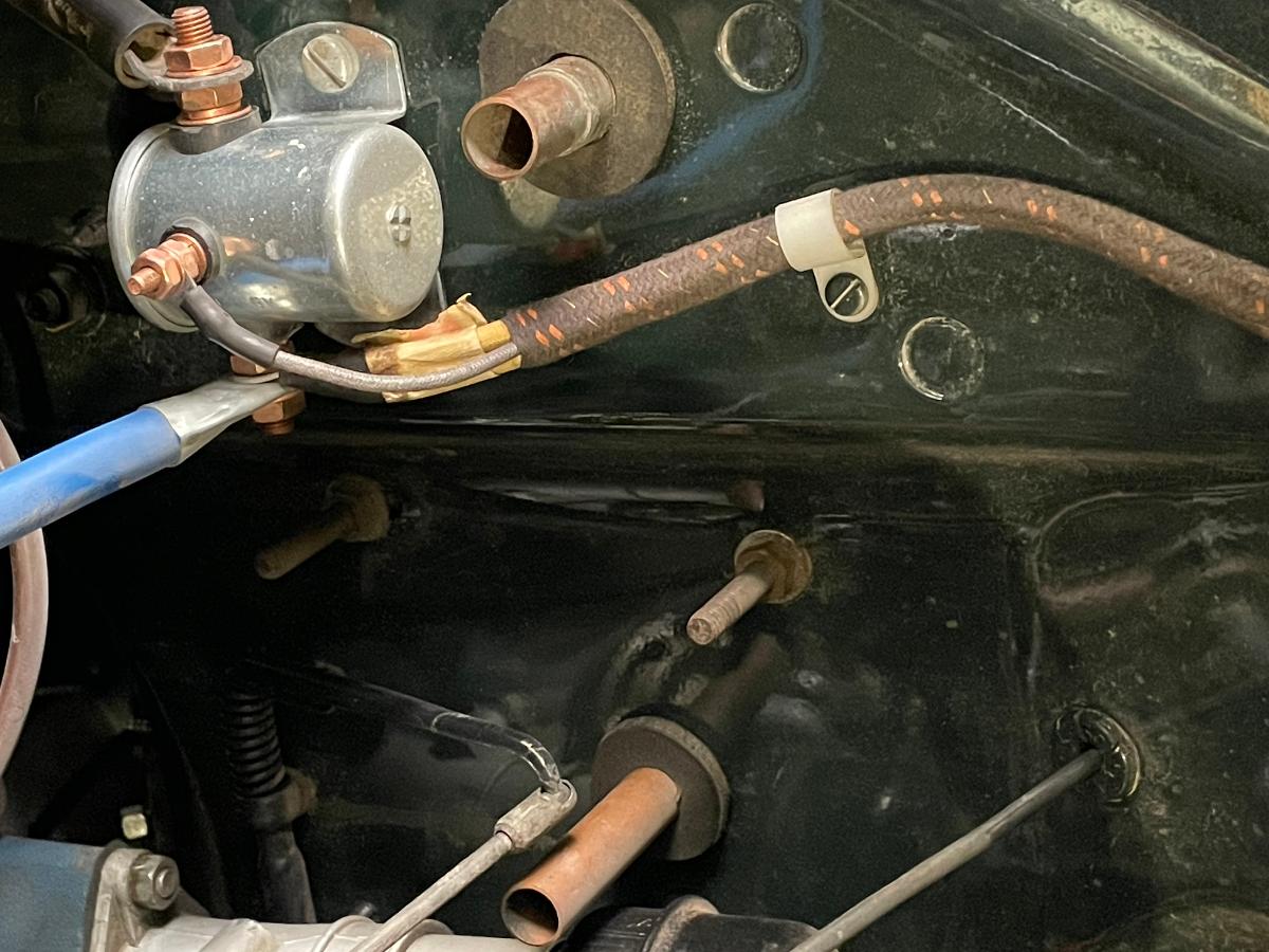

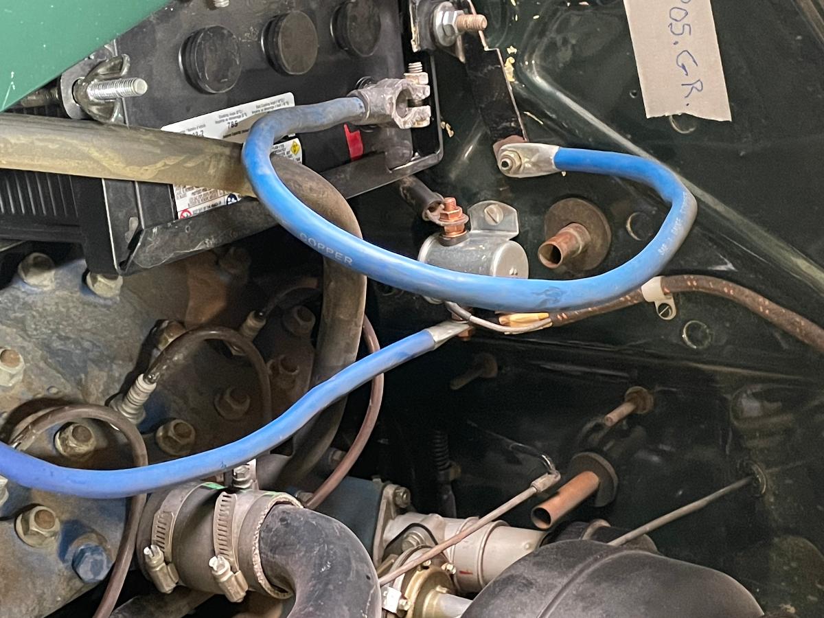

Could anyone advise me on the heater box connection on my truck. Which side does the hose by the water pump go to ?
Thanks PaulR

This might help but not specific to a flathead.
Old golden rule; bottom heater to top of head, top of heater to bottom either radiator hose or nipple on water pump

Thanks I’ll give that a try
Robip99
11-02-2025 @ 4:25 PM
Posts: 3
Joined: Oct 2025
That did the trick
