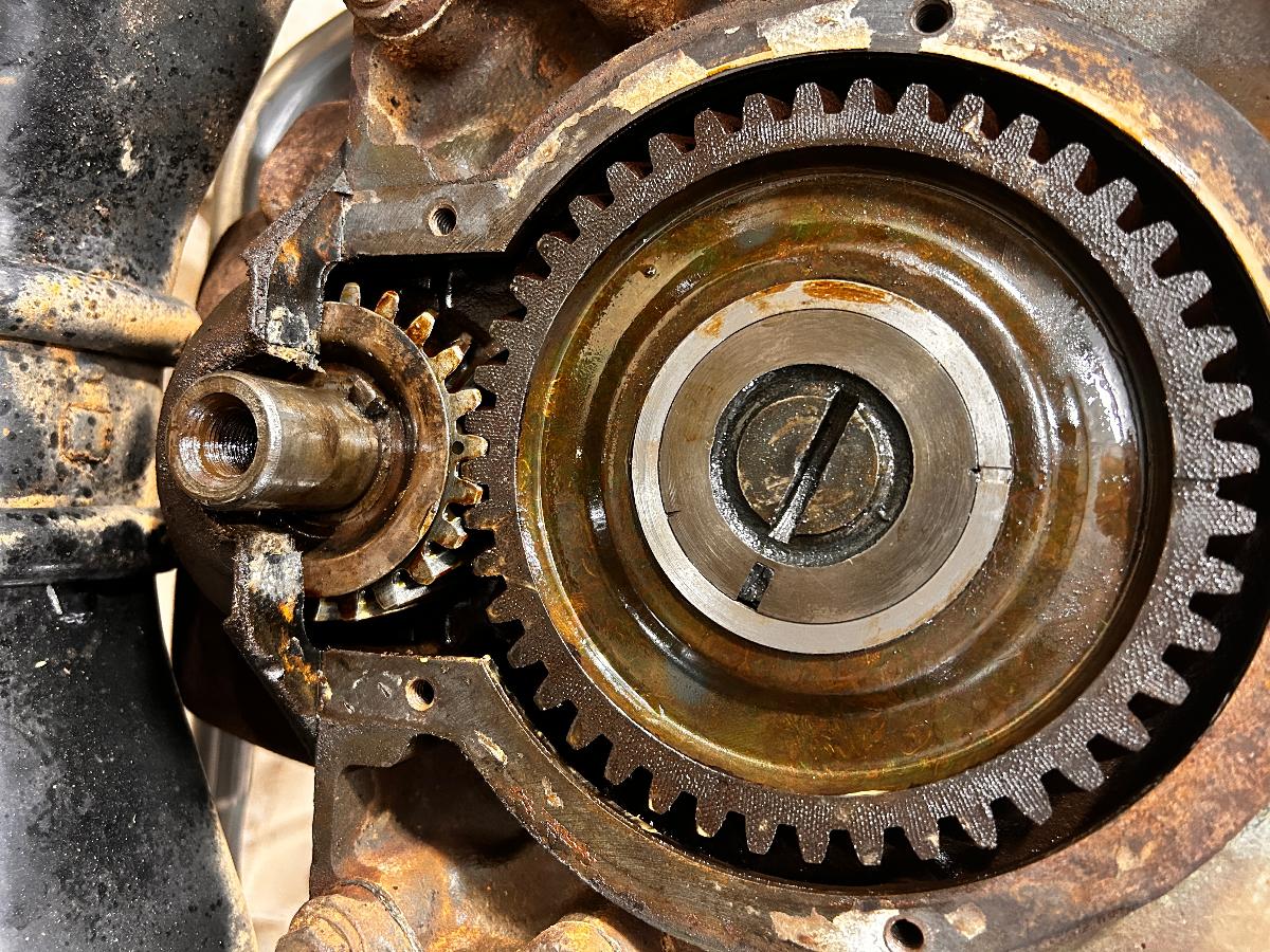

The current status on my '36 is this. Engine was rebuilt ins '77, but never run until recently.
Starts easily but runs very rough. I am not able to perform the test in the Ford V8 manual which lets you hear the points POP as the timing plate is raised. I use to be able to do this simple setting. So I did the flywheel test which is supposed to result in "approx 3" teeth difference. I counted 4+.
I reset the #1TDC comp, opened the timing cover and found the crankshaft gear timing mark on a tooth pointing up as I expected. The camshaft mark and the camshaft gear mark between teeth are inline and are also up. And the distributor tang slot is @ 10 & 4 (generally). May be able to upload a pic tomorrow. It doesn't look or seem right to me.
Am I missing something?
