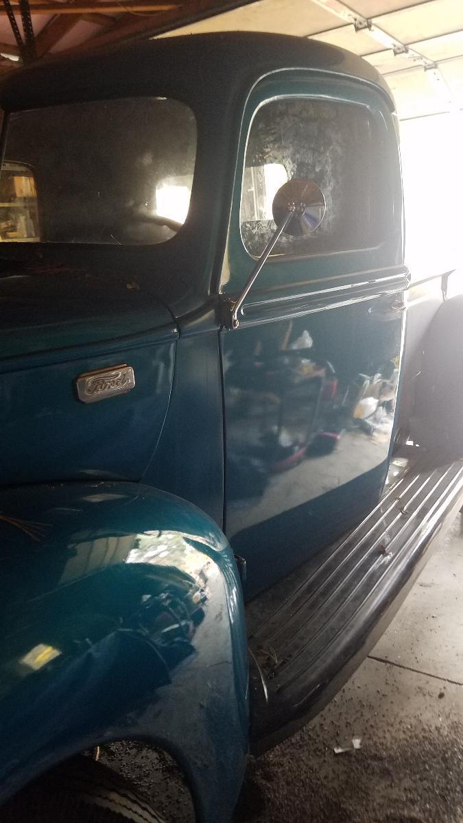

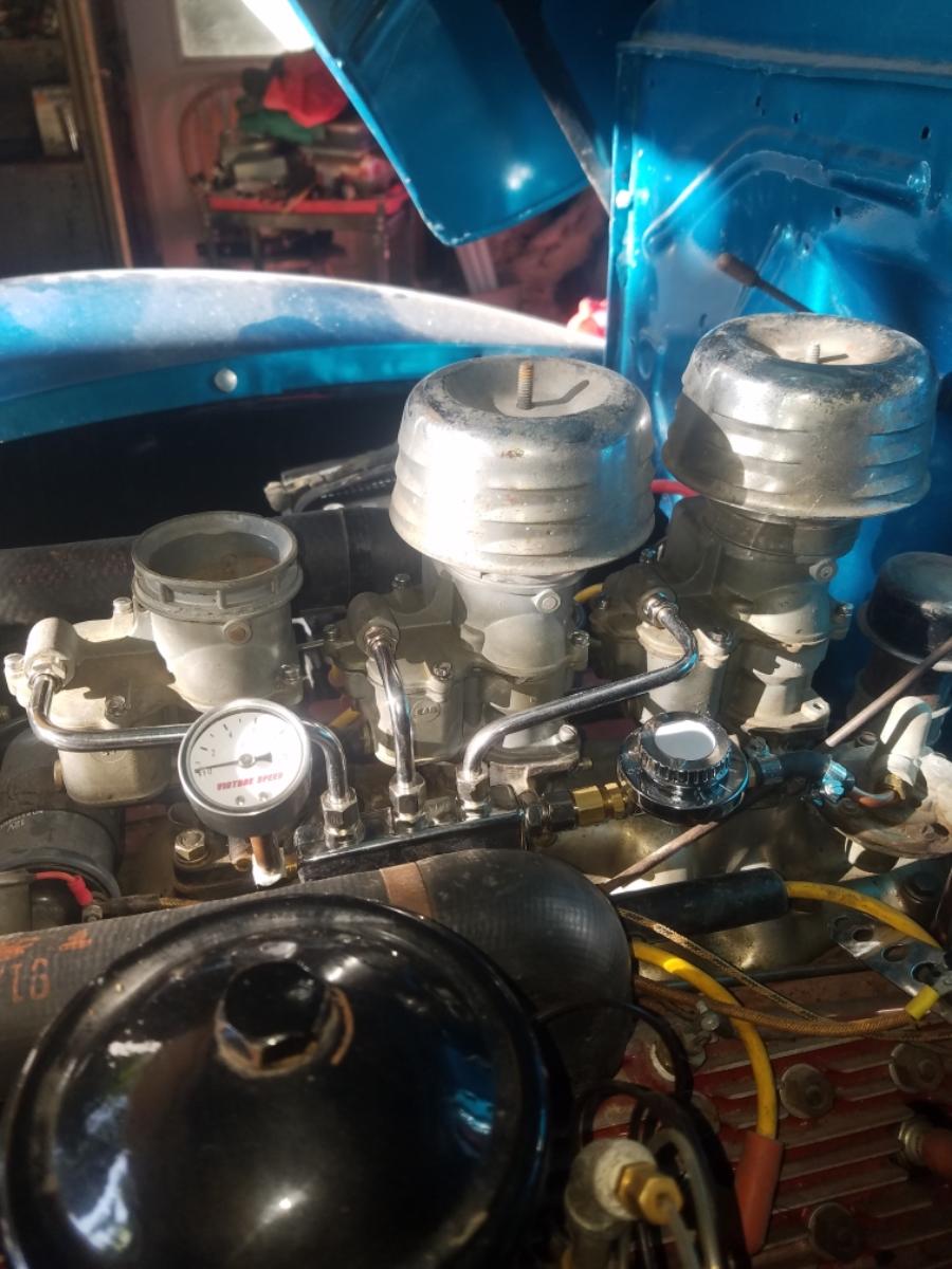

Plslack
10-15-2022 @ 11:41 AM
Posts: 1
Joined: Oct 2022
I’m looking for some guidance. I’ve owned this vehicle for twenty years. The engine is worn out and not feasible to be rebuilt. I want to make this vehicle a daily driver for my wife. Any suggestions would be helpful. I would like to find out what kind of process have been used by others. Need To go to hydraulic brakes and power steering. Would like to keep as much of the stock frame as possible. Not looking to make it a hot rod or a rat rod just a safe daily driver. My email patricslack@me.com or cell 425 359 5807.
1937 Ford Pickup V/8 60 Hp
Thanks in advance Patric
