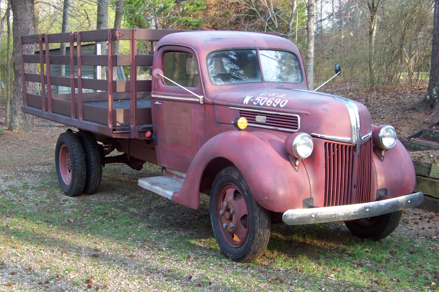

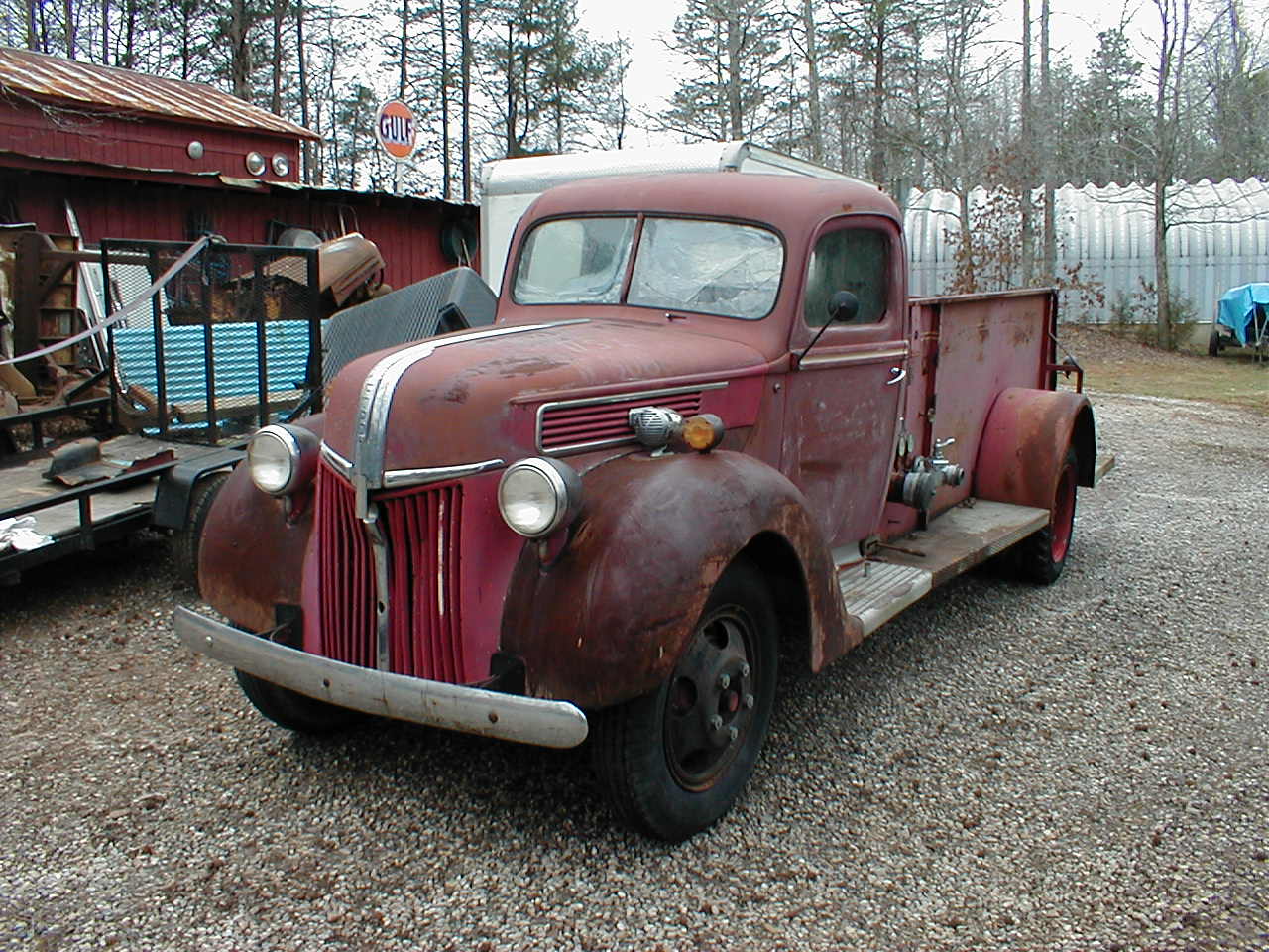

I own a 1941 1 1/2 ton dual wheel 158" wheelbase, former army fire truck now has a stake bed. ask any question , I will try to help

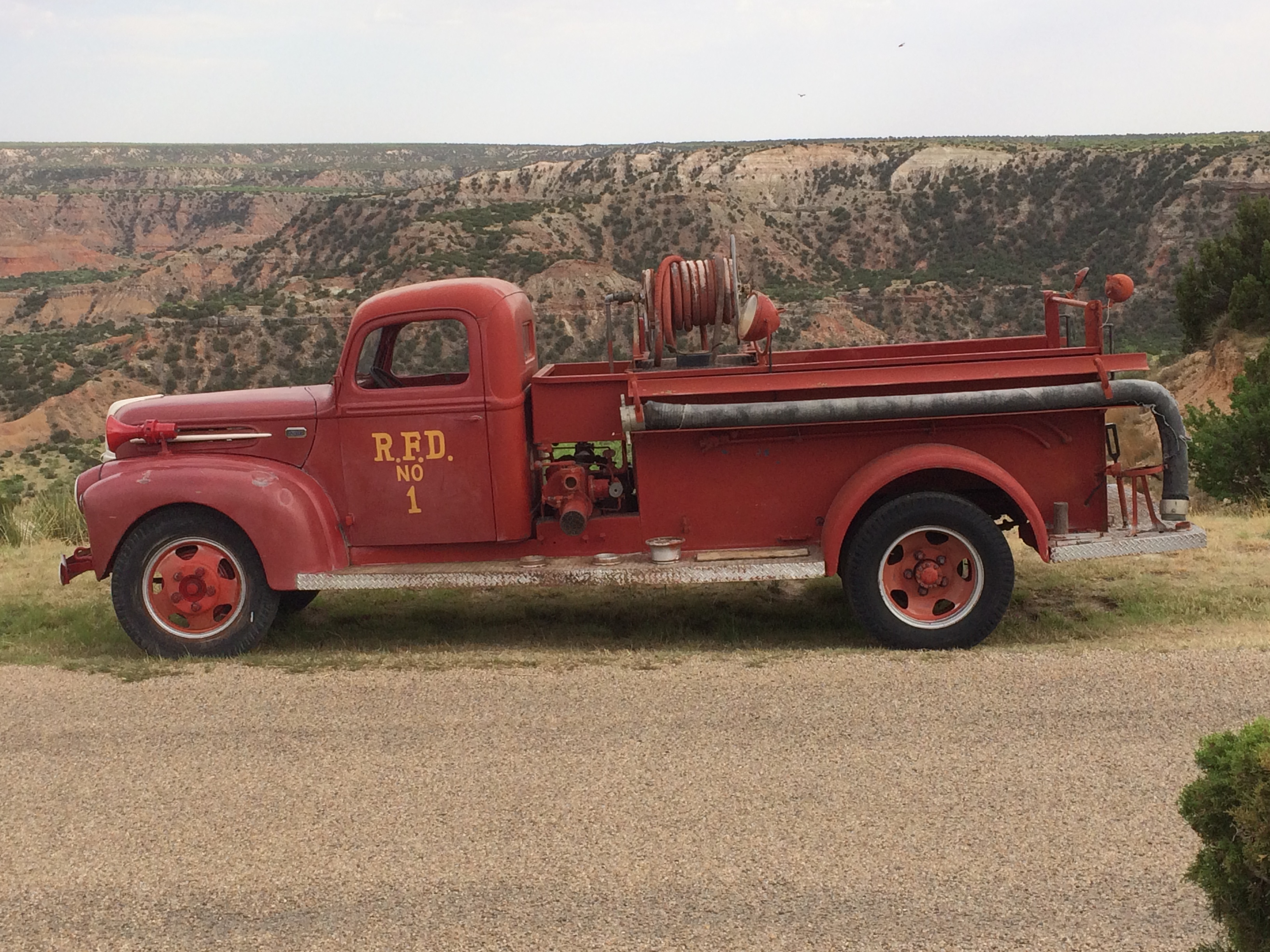

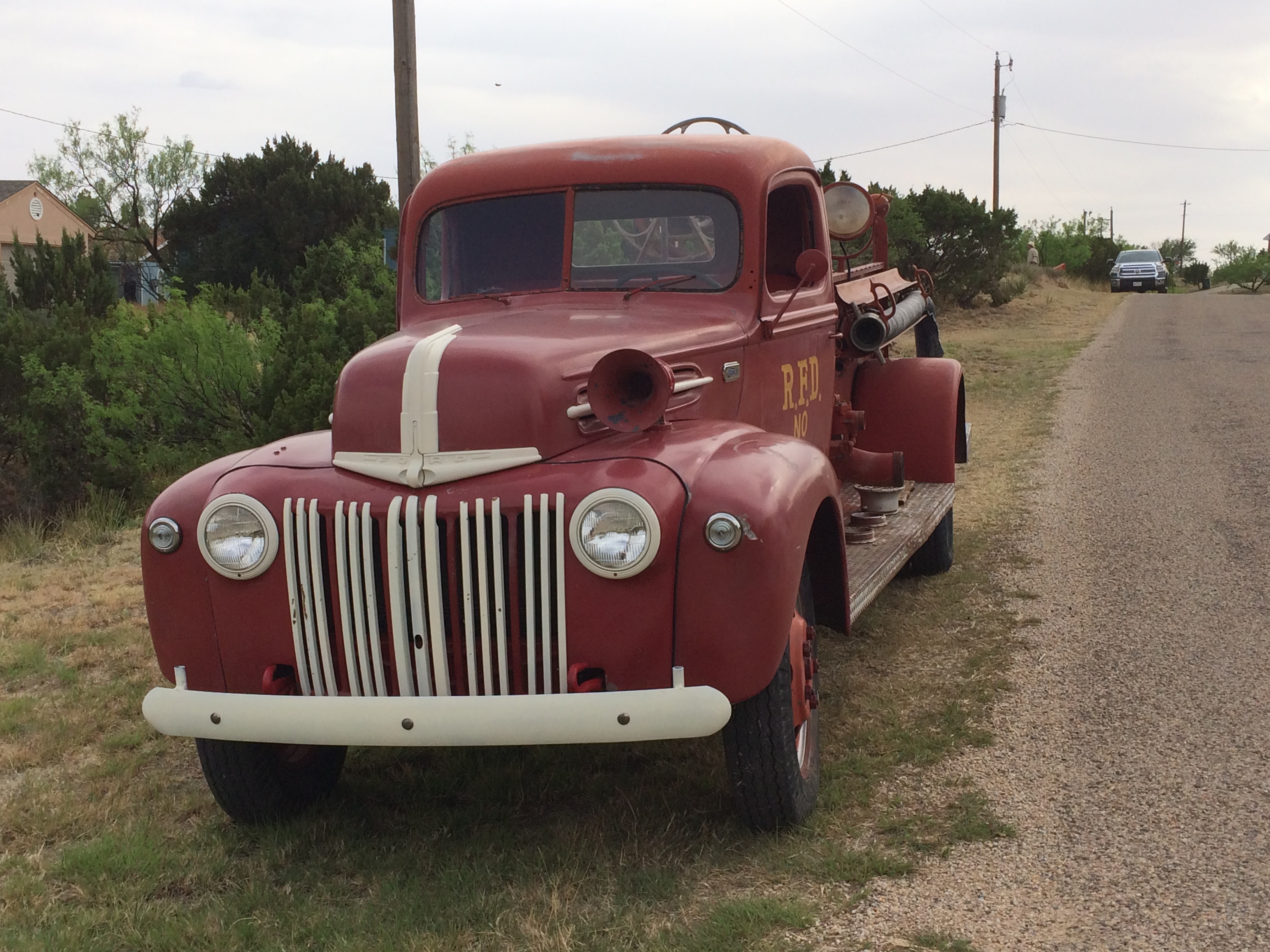

Hi to all, I have a '42 fire truck pumper with the 158" wheel base. the lug nuts are 1 1/2" and the rear end has two sets of springs lower and upper helper springs. The engine is a 239 CID with 24 bolt heads. Tranny is a 4 speed and 1st gear is really low.
Hope this helps
