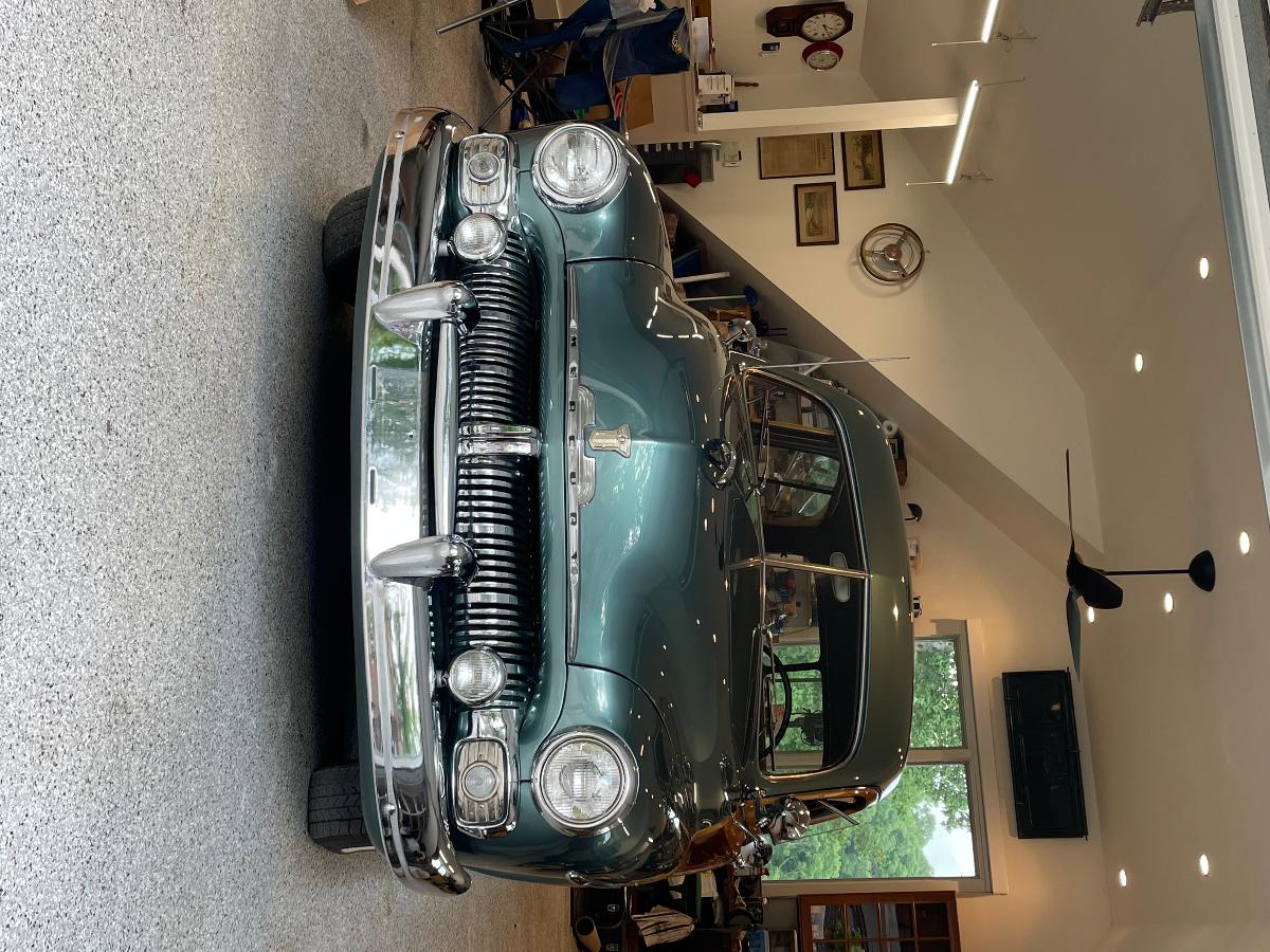

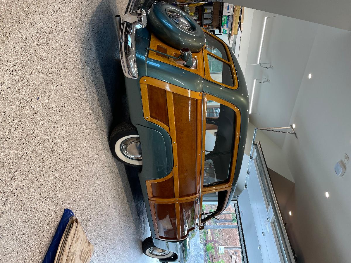

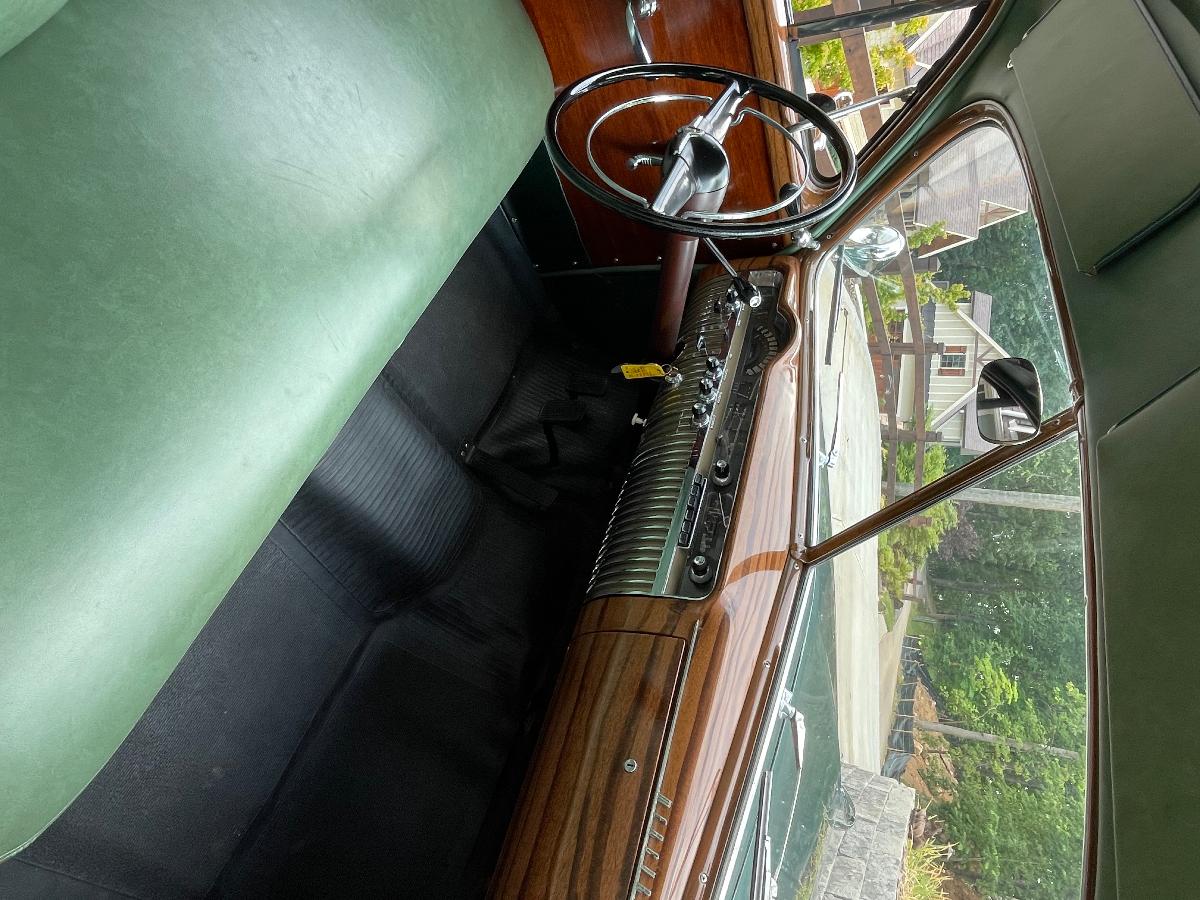

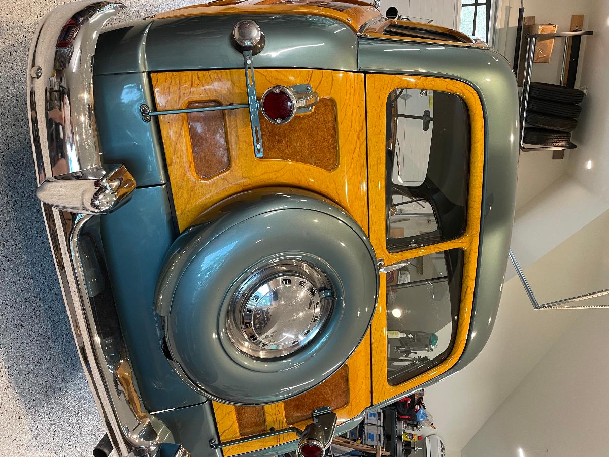

I picked up the car and it is very much what I was expecting. The body had never rusted nor has it ever been in a collision. Cosmetically, the car is solid. Mechanically, the car needs some sorting. The tires were new back when Regan was president, the right front brake grabs hard, the engine has a bit of a blue puff and many of the seals are no longer tight. The trans shifts nicely. The tires are so bumpy that I can't tell much of the suspension condition yet. I'll have it on jack stands in the next two weeks for a better review. For now, here's a few photos:

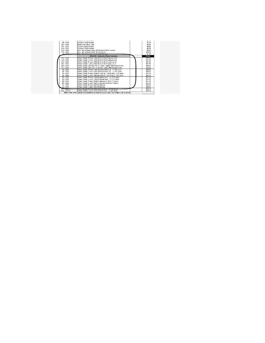

thanks nelsb01, let me show you what I'm looking at. Also, I'm asking about the mechanical parts. The attached jpg shows trucks or cars but no further breakdown. Is the wagon based on the car chassis and running gear? I suspect so, but for the lack of confidence, I have to ask. I understand that body parts would certainly be station wagon from the cowl back, likely car from the cowl forward.
06-03-2024 @ 3:14 PM
Posts: 1026
Yes, 1949-1951 station wagons had their specific part numbers.
I believe that 8M was the prefix for Mercury station wagons.
Now, that does not mean that was the case for all parts, just those that were station wagon only.
