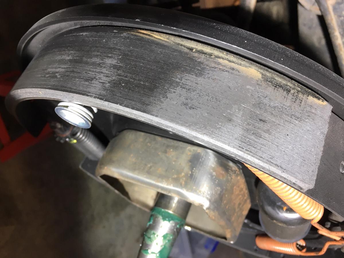

Bobb. Is this car "new" to you? The description you gave of the linings indicates they are in good order, but do the shoes have full contact on all the linings? Here is a picture that shows what I experienced with poor contact and lousy brakes, until I arced all the linings.
