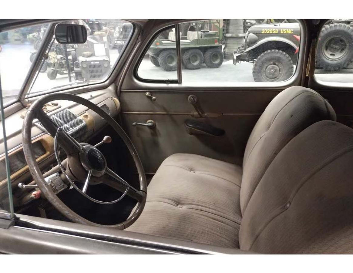

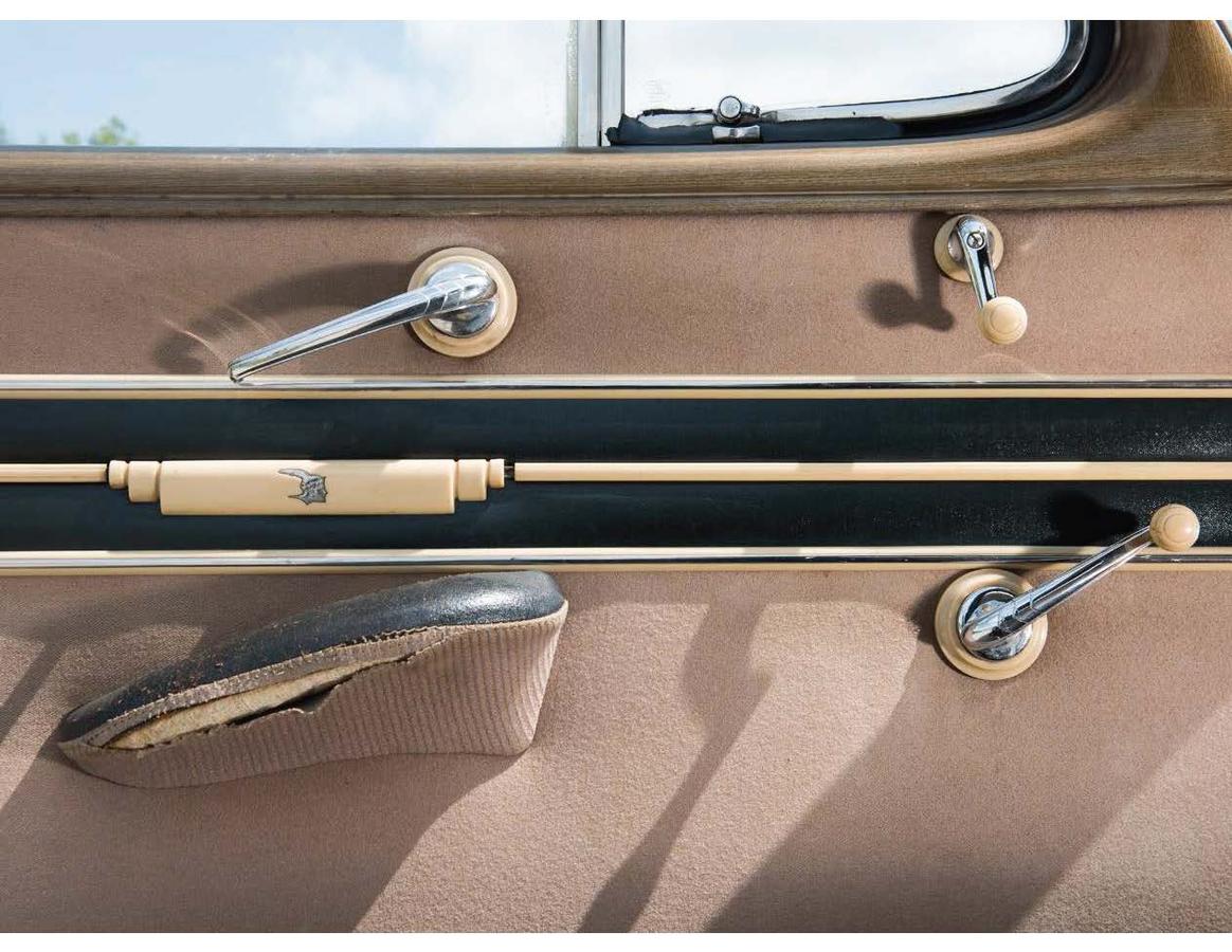

41-42fordadvisor, does this have to do with the different trim patterns on 41 mercuries? For example, it looks like some came with a stainless rain-gutter trim while others had trim around the front and back seat windows. I also noticed that some of the cars had a fancier interior door trim than others (photos of the 2 types should be posted here). Is there a Mercury bible where I can find all this stuff out by VIN?

The 1941 Mercury like the 1941 Ford had a lot of changes during the year. I am not really an expert on 1941 Mercury's. I do not know when each change happened. There is no bible that I know of for the 1941 Mercury with all the changes by serial number. As the changes were made on a certain date. Not all the factory's would have made the changes on the same day. As they would have used all the old stock first before installing the new parts. You could write to Dan Krehbiel, he is the advisor for the 1941 Mercury for the V-8 Club. He is the one that told me about the changes in the fender trim. You will find his address and e-mail address at the back of the V-8 Times. I am sure he has a list of the changes and dates.
