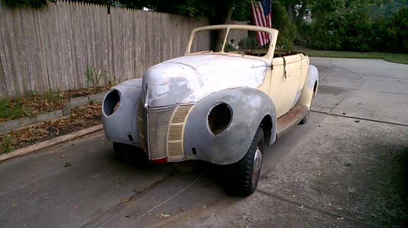

I'm new to this site because I mainly build classic chevys. I just bought the car of my childhood dreams and that is a 40 Ford Convertible.
This car is just a sh*ll with many parts not attached or missing. I'm not going to build it stock but as a modified hotrod.
I just ordered $100 worth of manuals from MACS.
Here is my first question. The top frame is off and I want to get it on before winter so I can put a cover over the car. Can't seem to figure how it attaches to the body.
Anyone have any info that can help?
