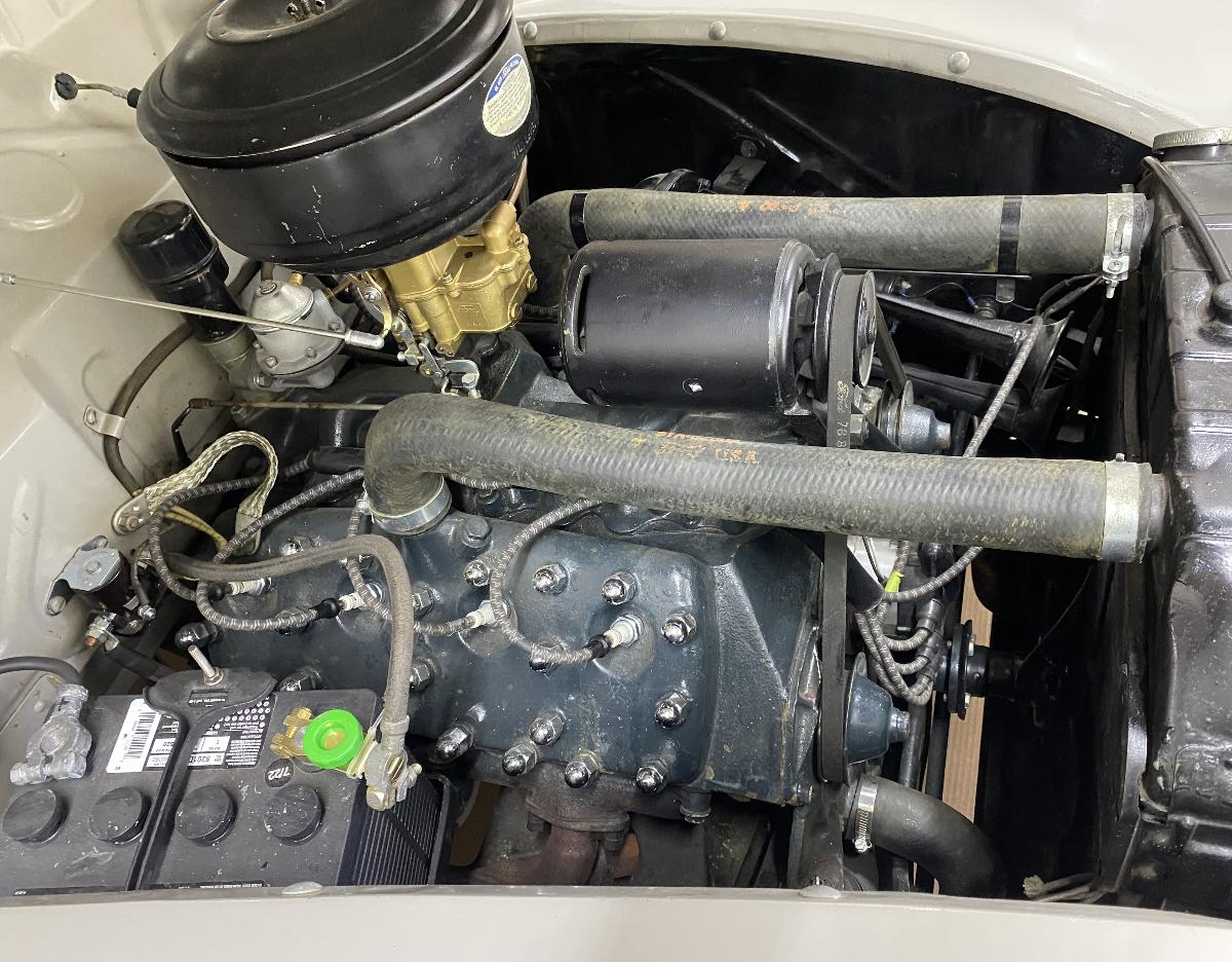

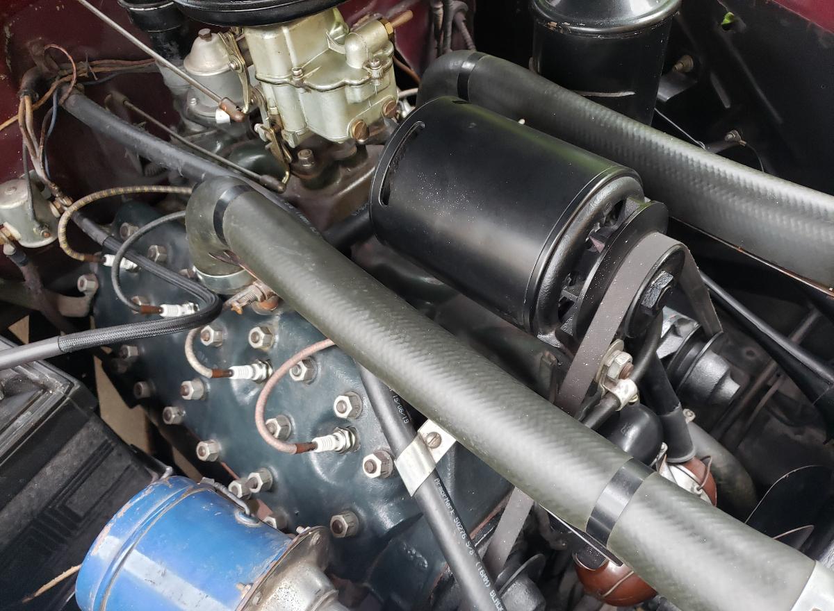

I note the 8v. battery. That makes me wonder how many volts you have at the distributor. Usually, an 8v. battery is indicative of issues being covered up rather than repaired properly. The extra volts also make me wonder what it's doing to the coil, points and condenser.
While the distributor is out for rebuilding, I'd strongly suggest you obtain a 6v. battery to eliminate any issues the 8v. may introduce.
You may very well find that 8v. battery was installed as the engine didn't turn over well when attempting to start it. That's almost always a cheap and fairly easy "fix".
Proper battery cable gauge, clean grounds (free of oil and paint and lastly, a properly rebuilt starter will nearly always take care of things.
The ground cable to your battery appears to be of a smaller gauge than required.

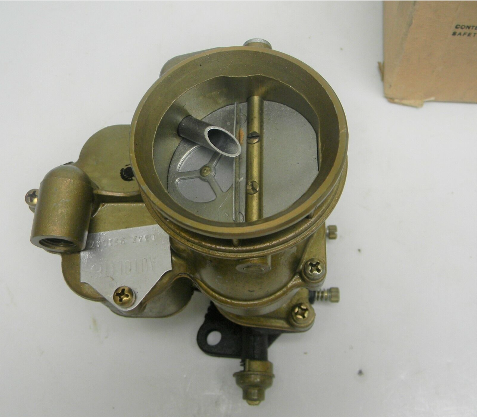

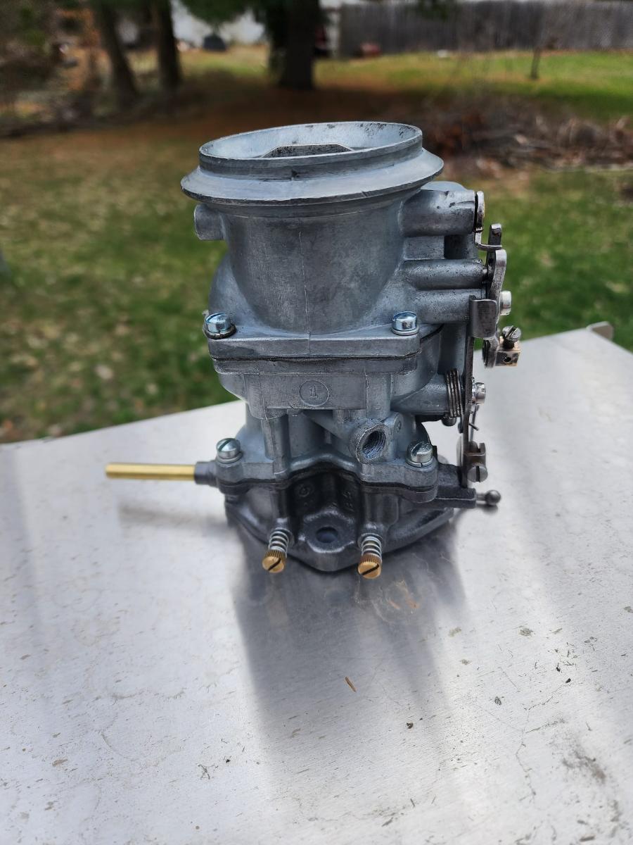

Thank you kubes 40 for that comprehensive analysis and the source reference for the distributor rebuild,  that is what I will address next, along with the return to 6 volts. In regards to the carburetor  I am attaching some close up pictures of what I have.  Also would you please forward a little more contact information for Charlie Schwedler. For ref. before the carb,pump, and plugs were changed the engine was rough at start up would not hold an idle with out lightly pumping the gas pedal so those changes did help but obviously were not the root cause as you have stated.  Just wondering except for the not correct engine year points that would be deducted if the car was being judged, is the 42-48 engine a plus, negative, or neutral?

The carburetor is a service replacement part that does not "match" what was factory installed.
Service parts were meant to fit and operate but not necessarily match the original part.

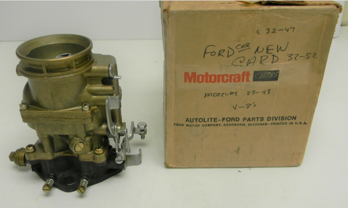

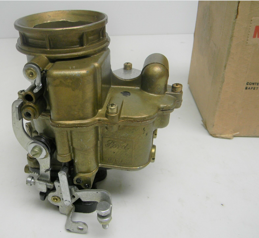

I purchased this as an N.O.S. carb about seven years ago (also in what appeared to be the original box).
I post it for color comparison (I don't know whether it is correct, either).

trmsr: The Carb is a much newer service replacement but it also is missing parts to make the choke function. Note the empty threaded holes on the side of the Carb. and where does the dash hand choke attach the upper choke plate can flop from open to closed. also is there a place to connect the dash hand throttle? How did you connect the throttle pedal? Instructions you have show some of the missing parts

RAK,
The finish on your carburetor appears correct. The cover is from a later model. Without more photos, I can't tell whether or not the remainder of the carb is correct.

The service replacement carb required the use of some of the linkage parts from the carb that is being replaced along with some included small parts to be selected depending on the model year you're using it on. With the correct combination everything works as it should. See blow up of instruction sheet attached.
