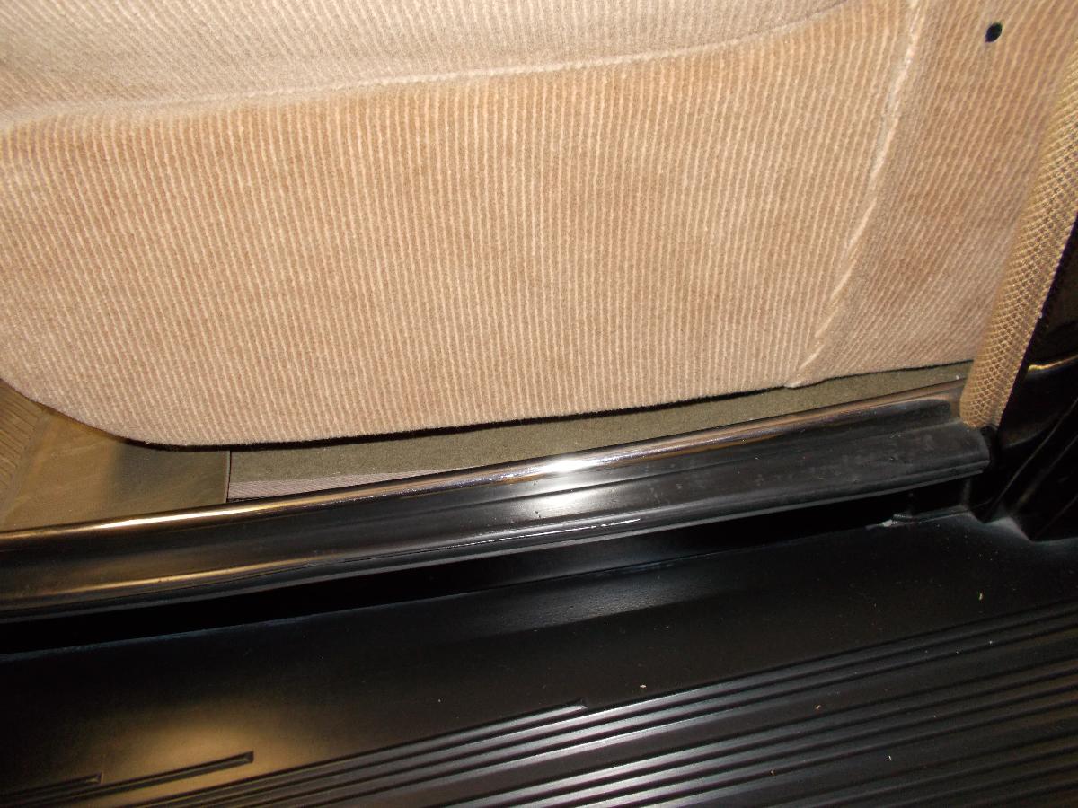

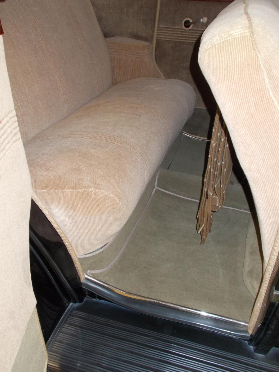

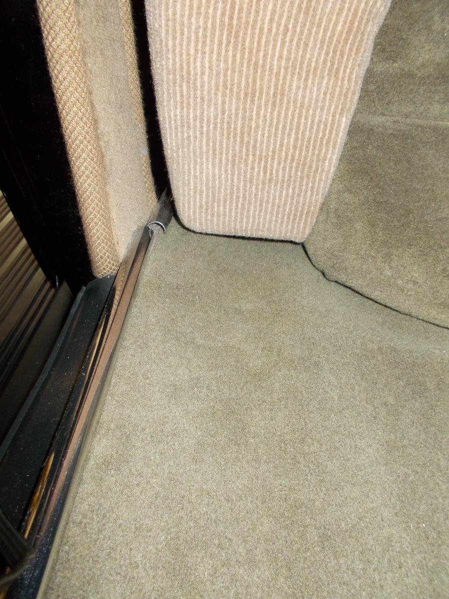

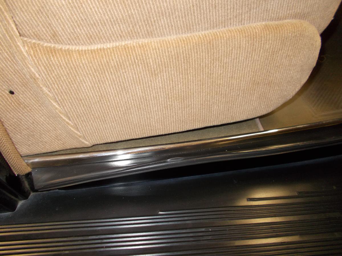

Does anyone have a photograph of how the windlace is terminated at the floor?
Does it tuck under the door sill plates?
Thank you all in advance.
08-05-2022 @ 5:37 AM
Posts: 3279
I do not have a photo. However, once it (windlace) gets to the floor, remove the core and glue about 1 1/2" of the material (core removed) to the floor.

I assume that, the flattened portion of the windlace (with the core removed) tucks under the floor mat in front and the carpet in the rear?
08-06-2022 @ 2:02 PM
Posts: 3279
Yes, under the mat and under the carpet... correct.
1940 Tom
08-06-2022 @ 7:34 PM
Posts: 230
Photos attached.
Follow Mike's excellent instructions/directions and your windlace installation should look something like this.
Good luck and have a nice weekend.

Thank you both for the information.
Great photographs Tom-I will attempt to make mine look exactly like that!
Thank you both again!

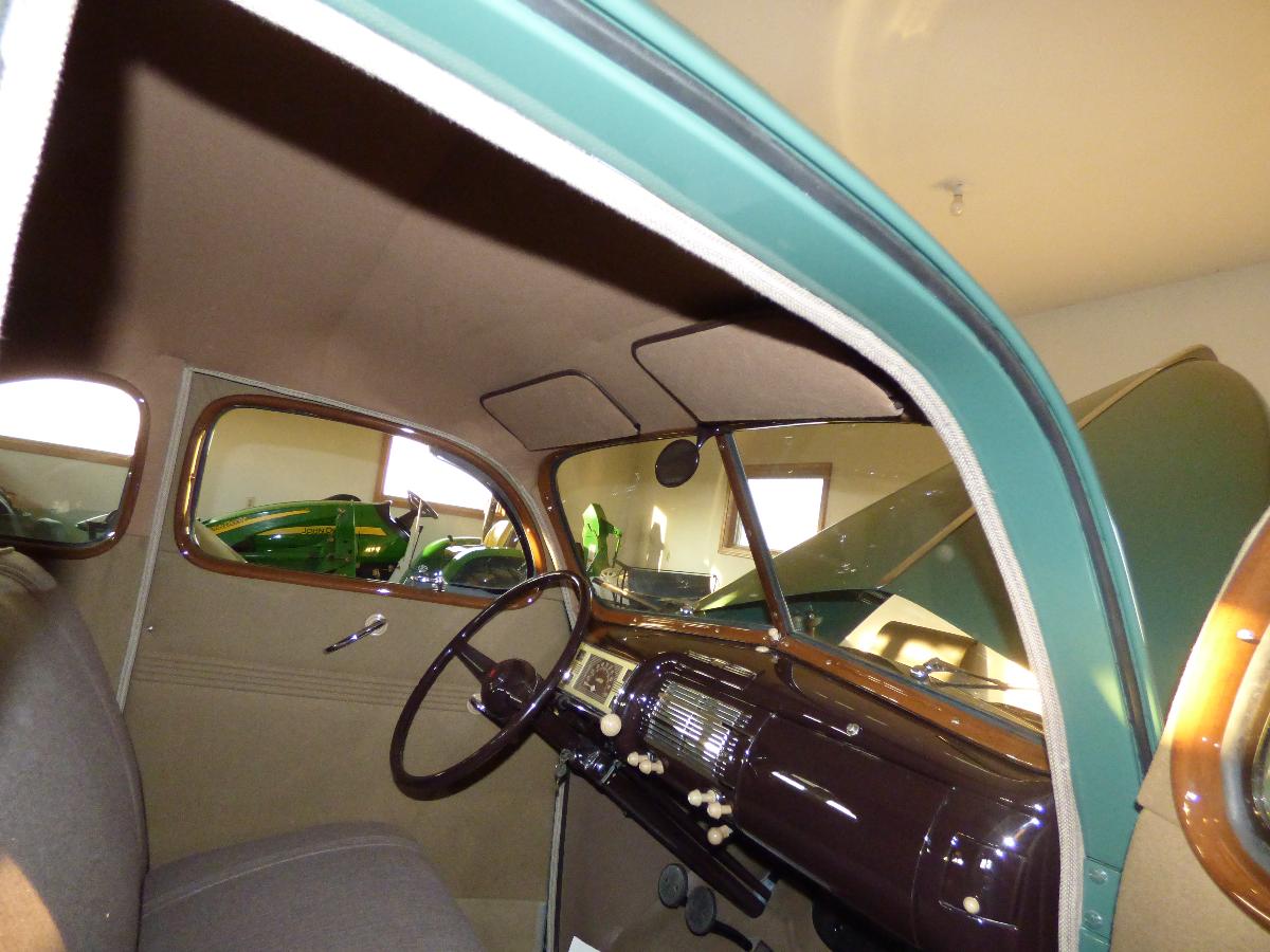

Any chance someone has a photo of the A-pillar, door frame, and B-pillar with trim materials attached?
On the coupe I am working with, the customers car has no interior trim in place. Between the books recommended on the forum and what I can tell, it seems like a compact (u-channel style) windlace is pushed onto the metal pieces that are attached at the A-pillar and above the door frame, to finish off the headliner edge. Then, the B-pillar takes the foam core style windlace to the floor, fastened to a tack strip.
I am trying to confirm this in order to buy the proper materials, thanks.
07-10-2023 @ 1:48 PM
Posts: 3279
Does this help?
The wind lace at the A pillar is under the u-channel that also serves to hold the cardboard panels in place.
This message was edited by kubes40 on 7-10-23 @ 1:50 PM
RAK402
07-10-2023 @ 10:31 PM
Posts: 389
Joined: Jul 2015
Mike,
Great photo of another beautiful 40!
FirstRideRestorations
07-11-2023 @ 5:43 AM
Posts: 4
Joined: Dec 2021
Yes! Thanks very much
