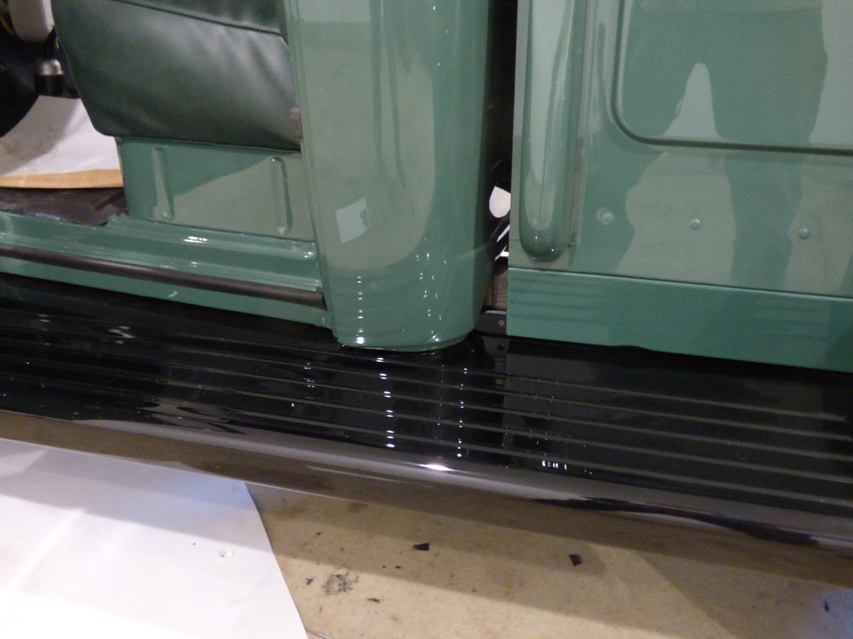

In addition to Kubes advice make sure you buy those that have the springs on the legs as they are a one off type spring.

Hi ya Gary, I do not have dimensions or a drawing of the leg. I have attached a photo that will at best give an idea of what Mark is searching for. These seats become available on eBay fairly frequently and can be purchased rather reasonably. That would be in my opinion, the way to go.

Kube..I am a friend of Mark Detwilder and he but me in touch with you, I recently purchased a early 1940 ford coupe out of long term storage out of Nevada. A very original standard coupe, no rust, most of the original upholstery is still intact but not useable. It has the jump seats in the back but missing the floor supports fro underneath. Would you know if anyone remakes them or where I could get pictures/measurements to fabricate replacements. Gary Gilbert hikergail2010@gmail.com North Fork Ca cell# 559 760 8915 Thanks again, really enjoying your book, thanks for the time and effort to produce it
