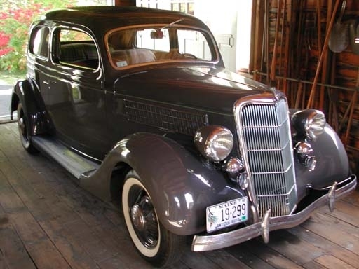

  The young body/fender guy refurbishing the interior paint in my '35 Tudor Deluxe is stumped by how to remove the rear window to install new glass. Is there a specific trick to that procedure? And then, what's the best way to put in the new one? Can anyone refer me to an old manual that shows how it's done?
