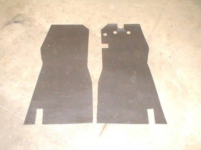

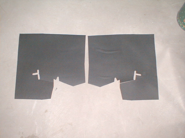

I'm not certain about a '38 but in '39 and '40 this 'paper' in the tool tray area is actually the stuff that was used between the trunk lid. Much heavier than 'paper'. Also, in '39 the front floor area on each side had a rather long piece of this same material. Behind the seat was a thick paper, no pebble grain, very similar (but a bit thicker) to modern roofing paper. I have attached a photo of the '39 - '40 trunk liners. To get these to lay in the trunk properly, a heat gun does the trick rather well. This message was edited by kubes40 on 7-15-12 @ 2:30 PM
| kubes40 | -- 07-15-2012 @ 2:31 PM |
Here's a picture of the floor insulating pads for a '39. All passenger cars utilized these.
